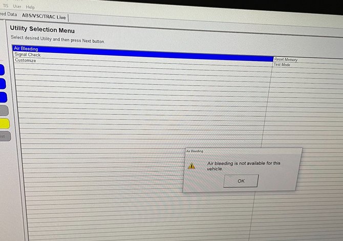

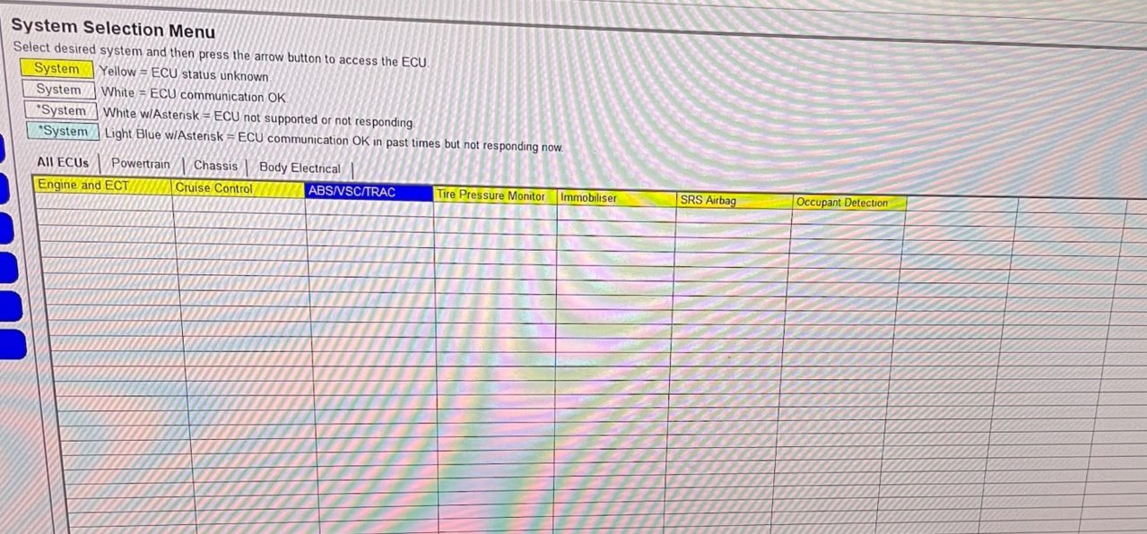

    We bought the tactrix adapter, then downloaded techstream following the info here:
    https://www.tacomaworld.com/threads/ecu-tsb-update.562550/
    we got it connected no problem to bleed the brakes. We went to the ABS module and then found out that air bleeding utility is not available for our truck:
    So we tried to use the manual control of the ABS solenoids to get air out up to the module.
    with this test function, the solenoids will only stay open for 2 seconds. so we would open the bleeder, then cycle the valve, then slowly push the pedal down over the 2 seconds. we did this several times, then just did regular bleeding (pump, hold, crack the bleeder). pedal seems pretty firm, but we still need to try driving it and we are assuming that we may need to redo.

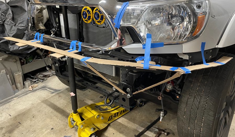

    and we started mocking up a tube bumper:

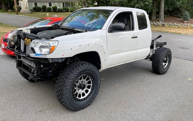

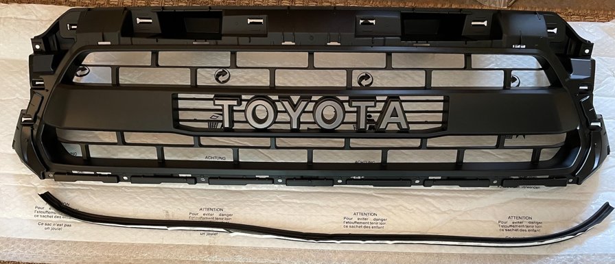

    we are swapping to a 2012+ front end. we got a hood for free from a friend and found OEM headlights in great shape for $120. and bought an aftermarket PRO grill:

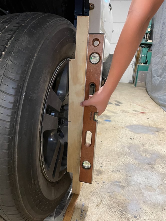

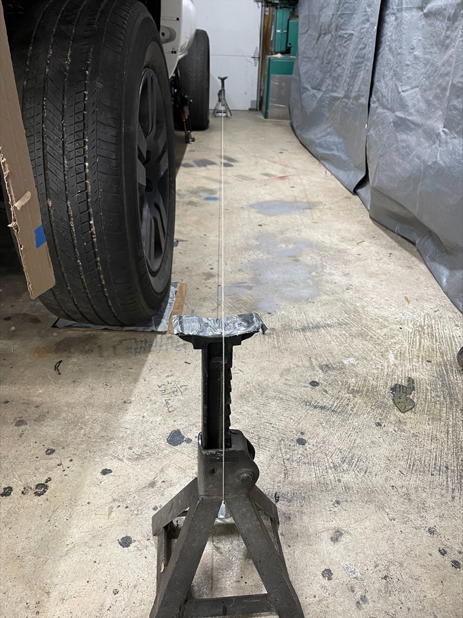

    We made this tool to get camber in the ballpark and you can also turn it sideways and use a tape measure to check and adjust toe.
    We also set up strings from the rear wheels to get the steering wheel straight:
    you can also see our home made "turn plates", these make it easier to adjust things because the tires can turn easily on them when adjusting. these are 2 linoleum tiles with grease inbetween

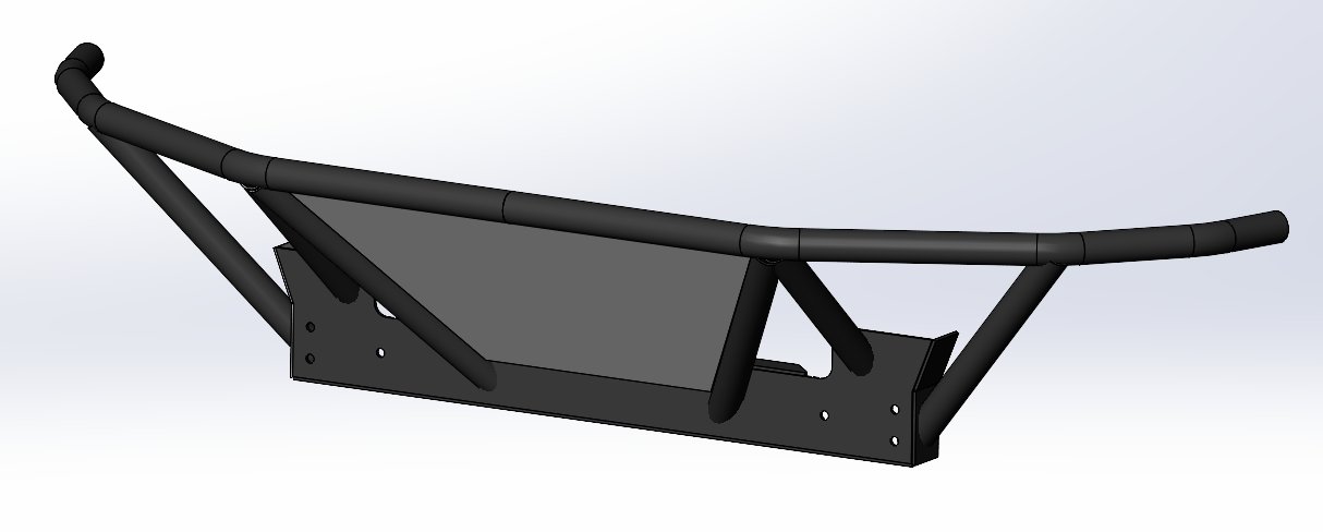

    We put our bumper design into solidworks the plates are 3/16" tubes are 1.75" and it says it should be around 60 lbs:

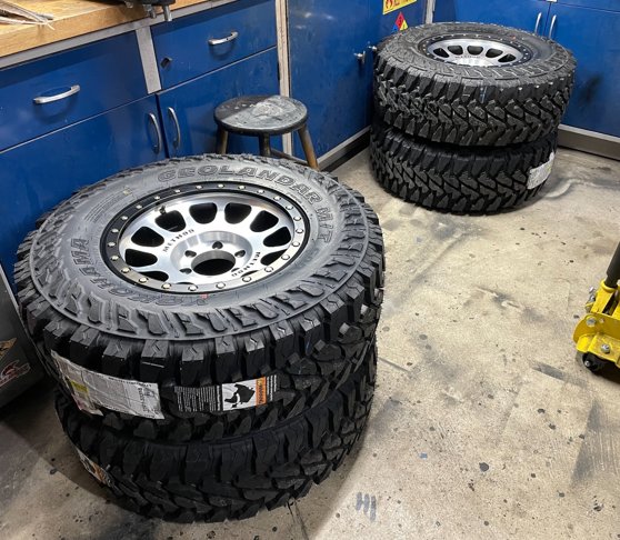

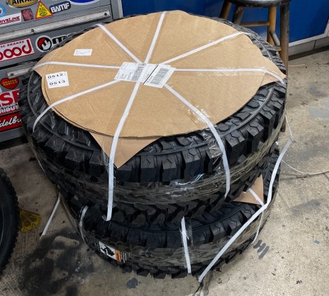

    Wheels and tires came:
  18. Aug 15, 2022 at 7:22 AM
    #218
    jwarr
    jwarr [OP] Well-Known Member
    Jun 10, 2016
    #189219
    439
    17"x8.5" Method NV with 295 70 17 Yokohama M/T:

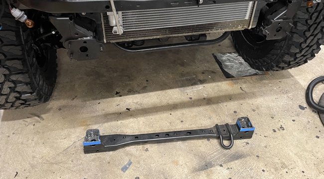

    A little frame surgery:
