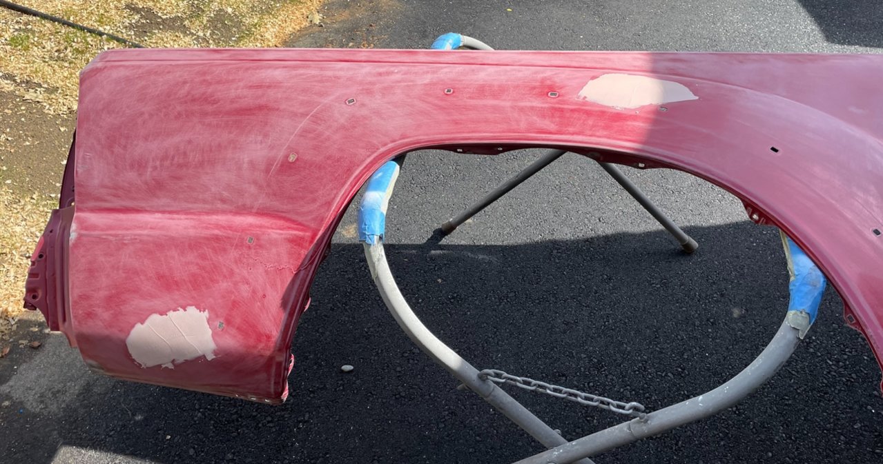

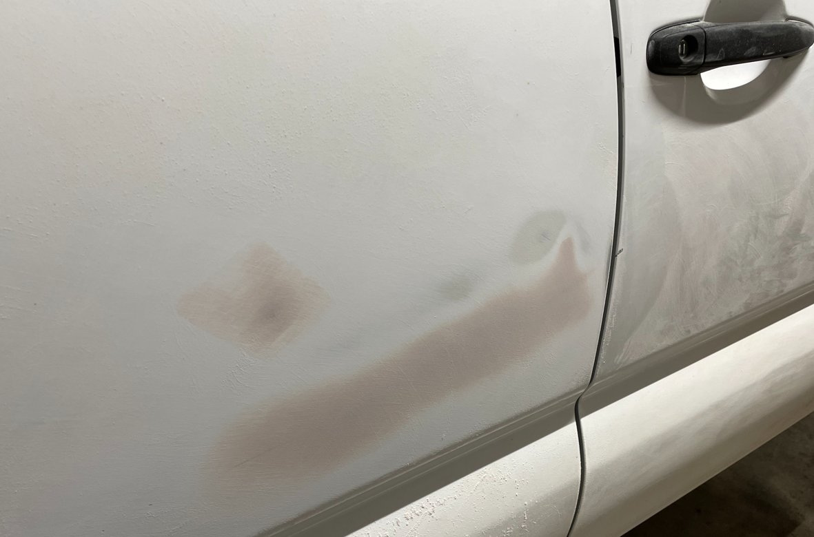

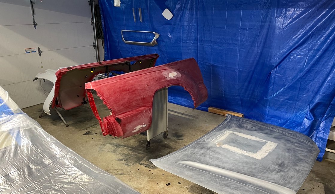

    fixed a small crease in the back door:
    and some dings in the bedsides:

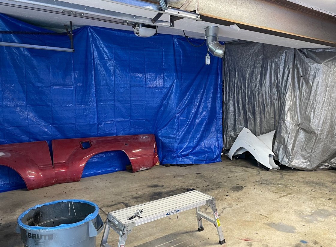

    And prepped the garage for spraying:

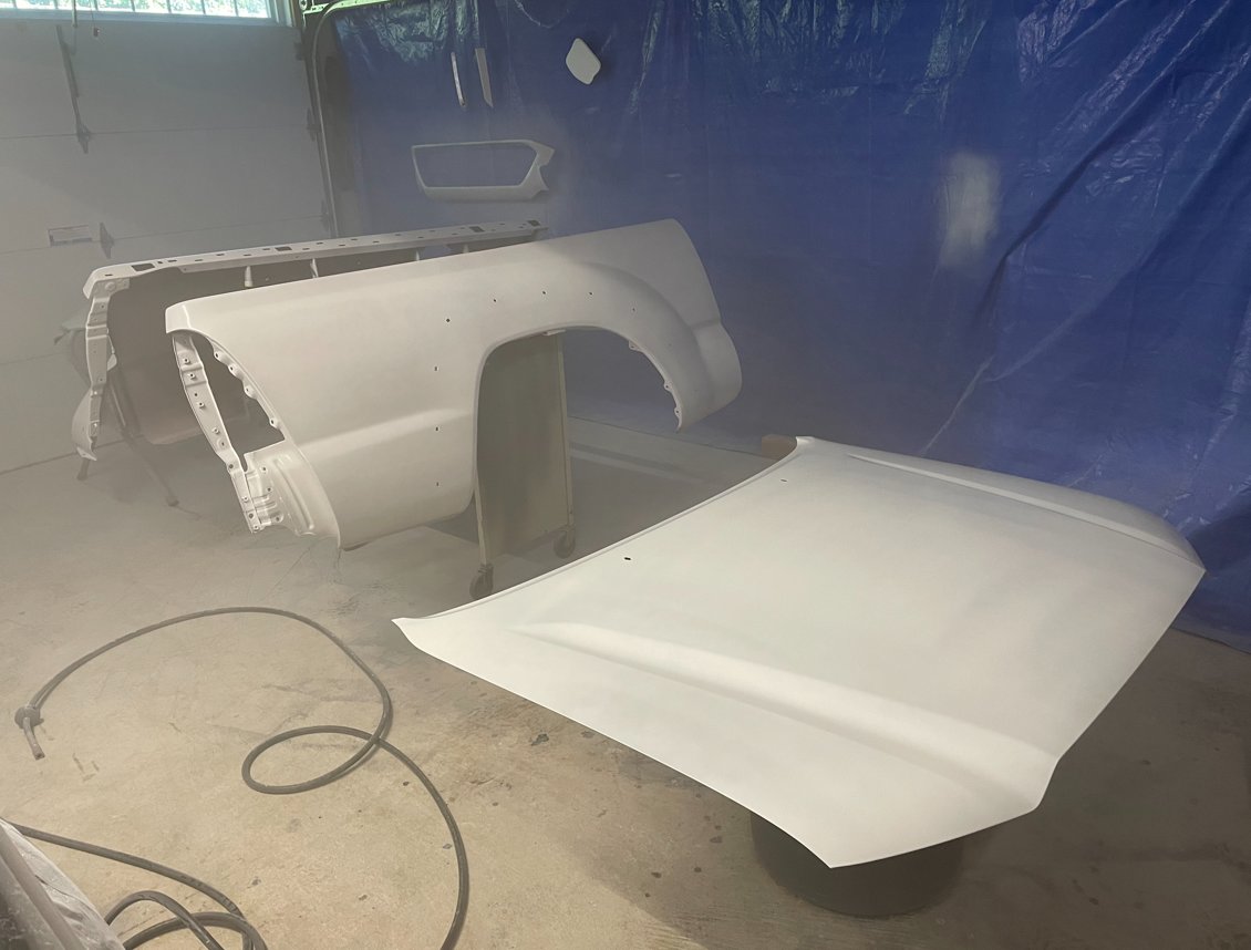

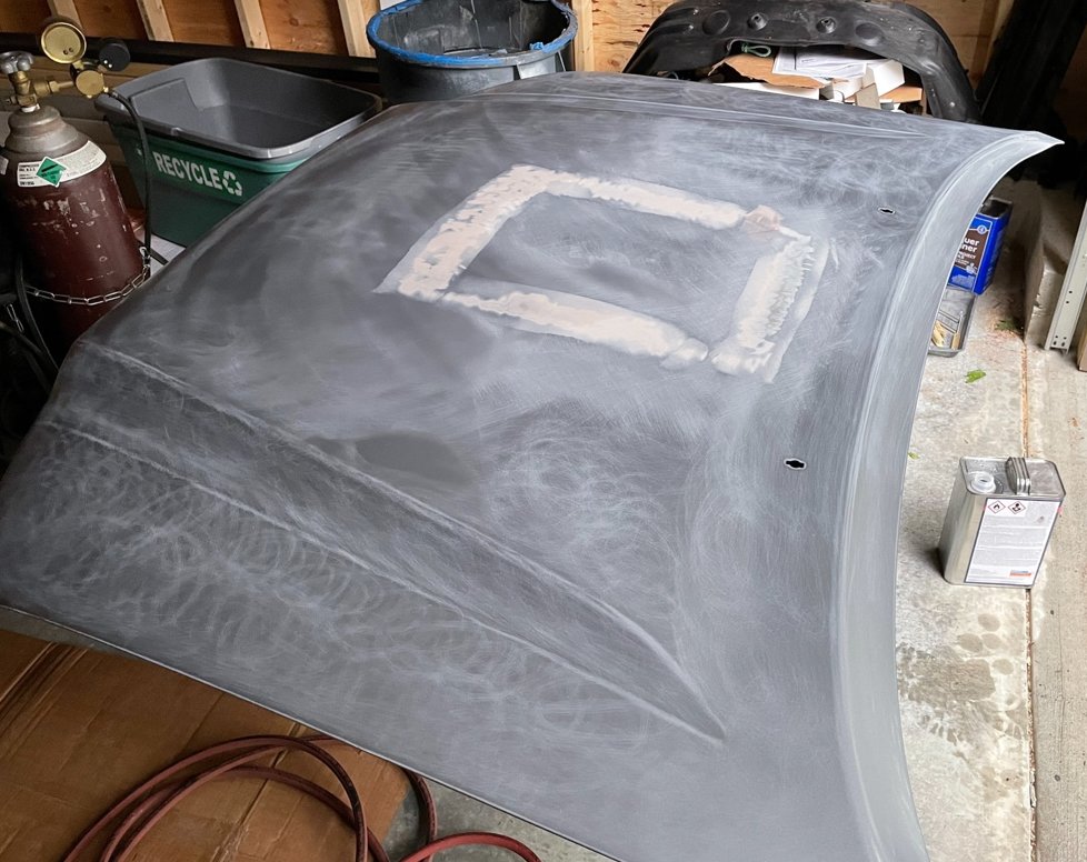

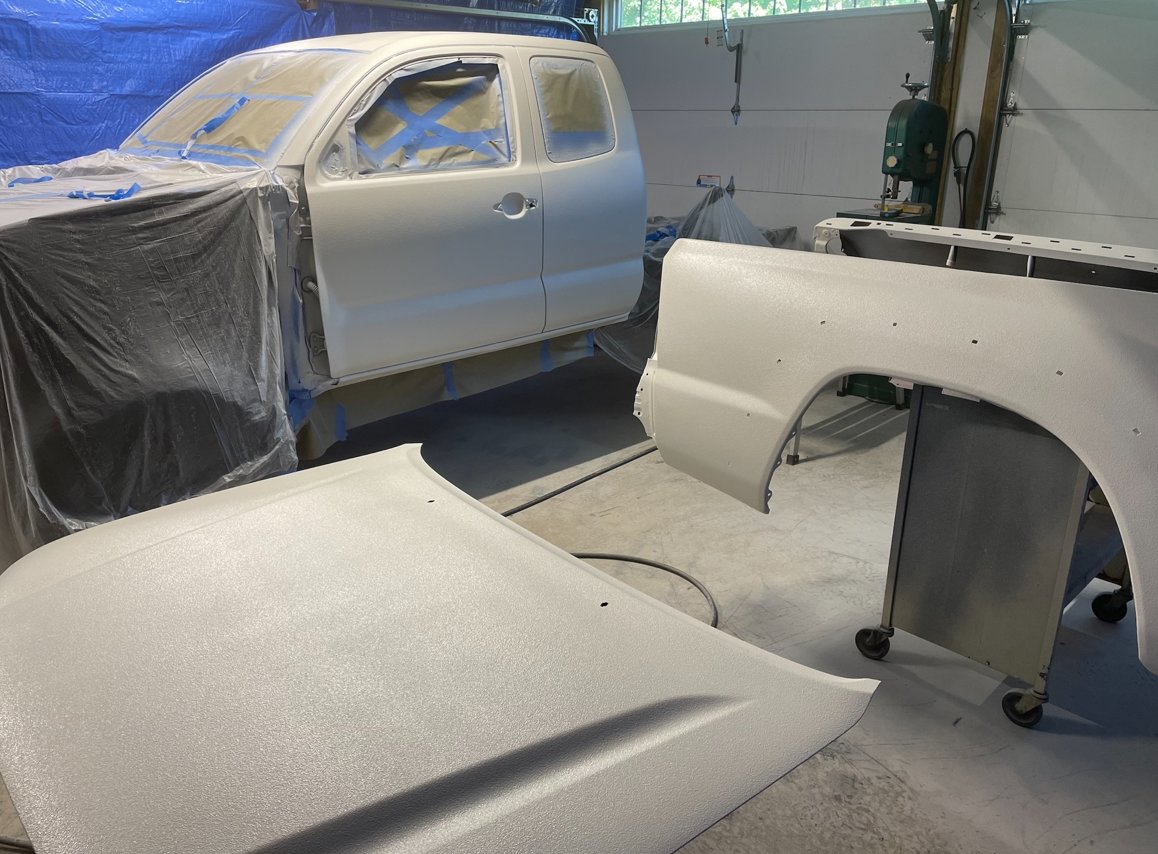

    our free 2012+ hood had a hood scoop bonded onto it that we decided to take off, had to grind all the adhesive off and smooth it back out a bit:
    Got everything into the garage:
    My dad put epoxy primer onto the bed sides, hood and over any filler:
    The white epoxy is almost a perfect match to our white:

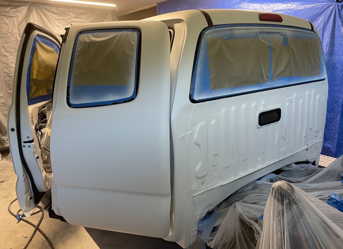

    10 bottles of tintable raptor with super white tint from EBAY seller ctigroup. We used the better raptor gun with the adjustable nozzle 50 psi at the gun with the trigger pulled, nozzle set 4 turns out. Masking around the window seals was a pain. 2 coats, 1 hour in between.

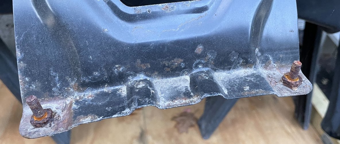

    #189219
    439
    so the inner studs are welded to the tubing that we put across so those are much stronger already over stock, we are still thinking about if we will do more to tie in the outer studs better to the frame.

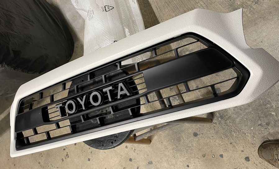

    We got our aftermarket TRD pro grill into the surround:

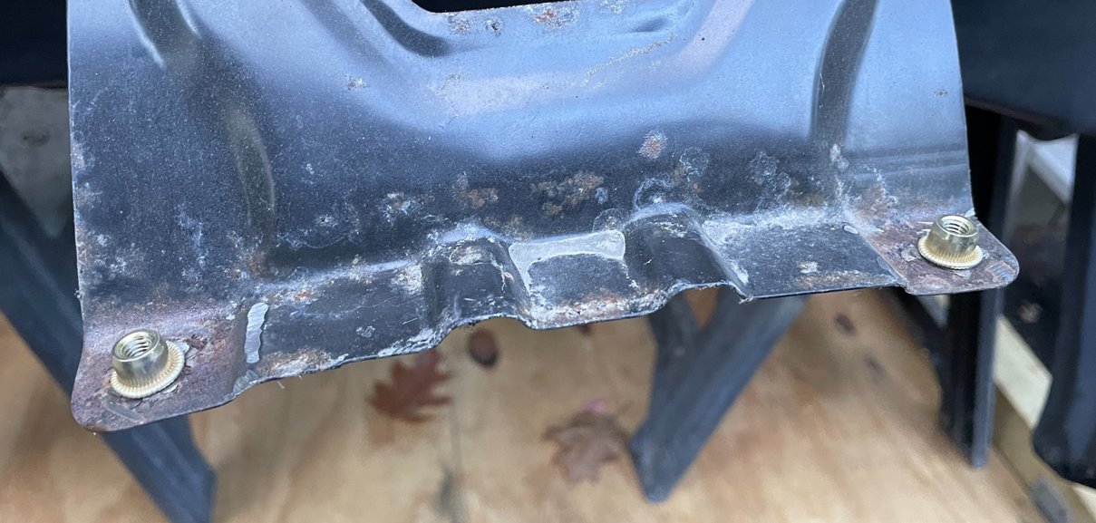

    we broke like 10 bolts getting the bed sides off so we have started replacing them with riv-nuts:

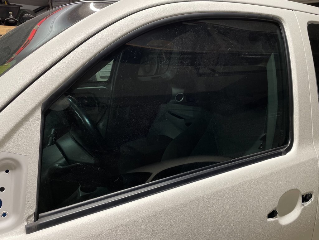

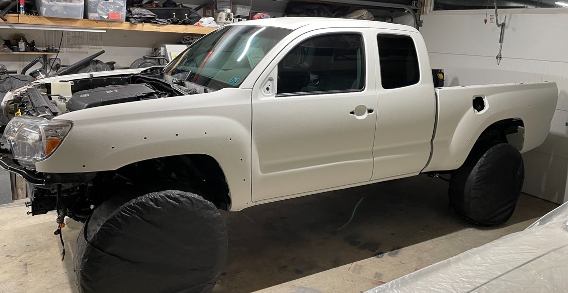

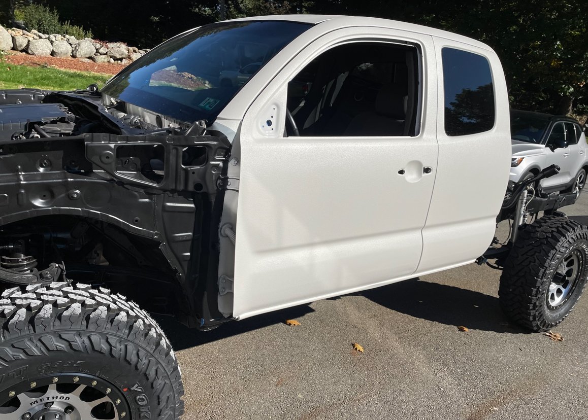

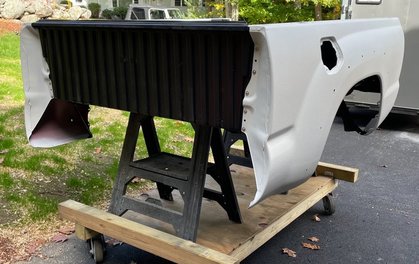

    We got the window run, door glass and belt molding back in:
    and got the bedsides back onto the bed:
    and got the front fenders and bed back in place:
    Everything fit perfect and we can now say for sure that the only difference between a double cab frame and an access cab frame is the rear cab mounts and the front bed mounts
