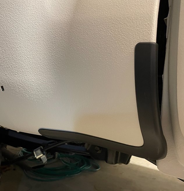

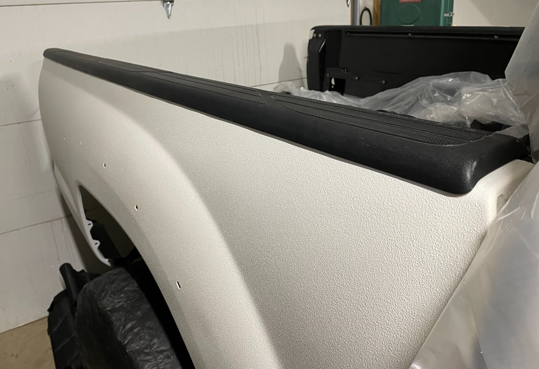

    We got the bed protector pieces on and the bed caps:

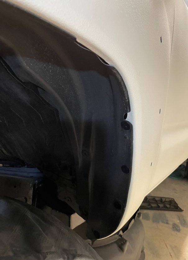

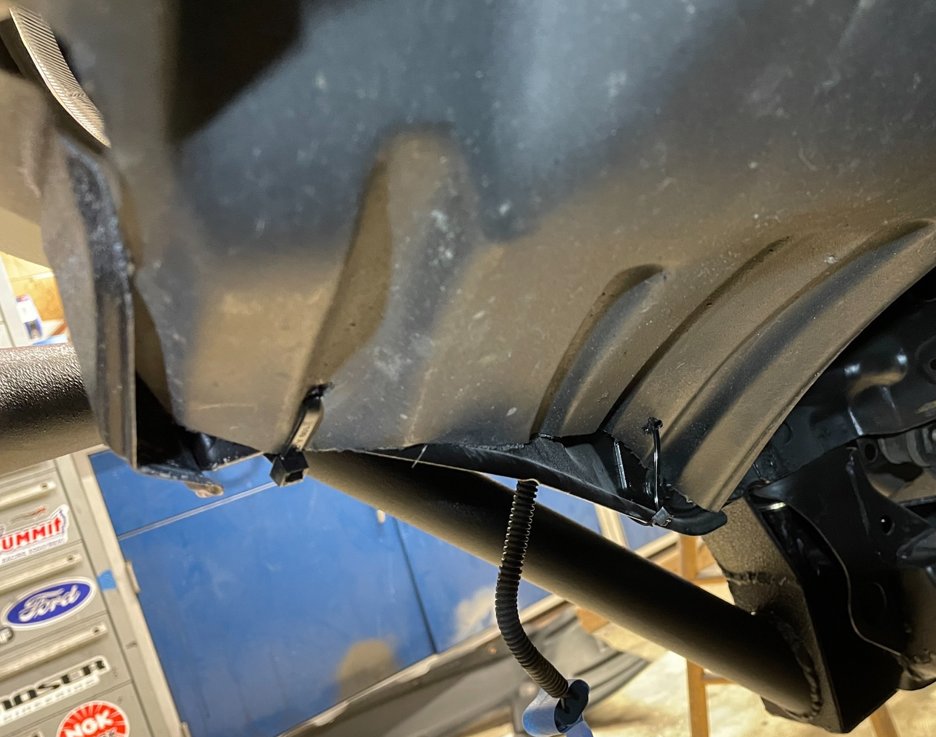

    And got the fron inner liners in with new retainer pieces:
    The front of the liners were already trimmed and drilled for zip ties, this holds them pretty good so we did the same:

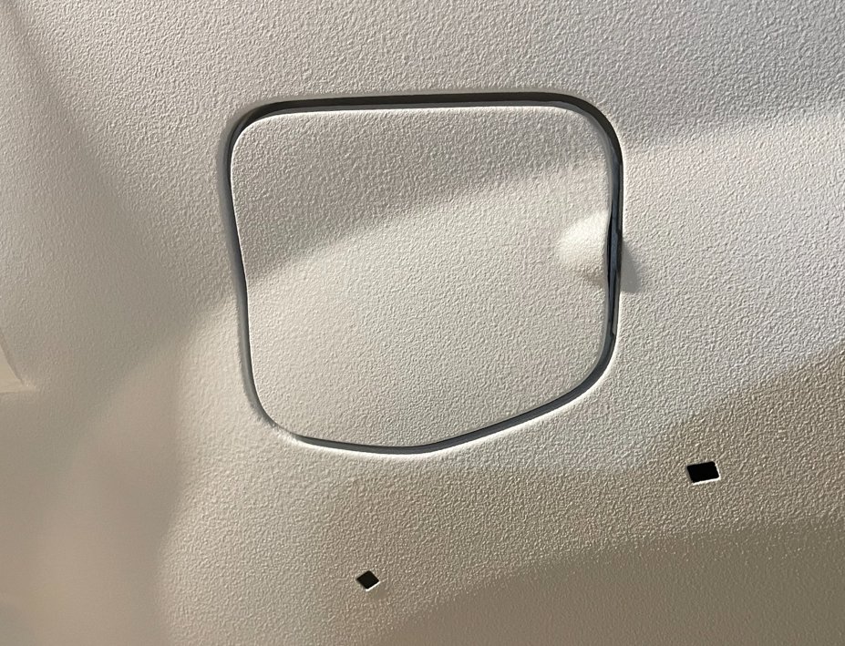

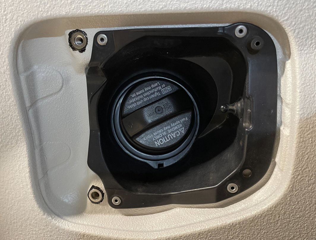

    we got the fuel filler thing rivieted back in and put in rivnuts for the door:

    What adhesive do you use for rivnuts? I typically use contraction adhesive but am attempting to find something easier to use.
  5. Nov 15, 2022 at 10:07 AM
    #285
    jwarr
    jwarr [OP] Well-Known Member
    Jun 10, 2016
    #189219
    439
    we don't use an adhesive, the black stuff is POR15 on the freshly drilled holes.

    Its pretty common to put a bit of adhesive on rivnuts along with squishing so they don't spin when you use them. A spinning rivnut will drive anyone crazy.

    Never heard of that, and IIRC my riv nuts have a cerration to them to prevent that exact thing from happening. I imagine the adhesive would actually reduce the mechanical connection in my case. I also don't use riv nuts where heavy amounts of torque are applied to them either.

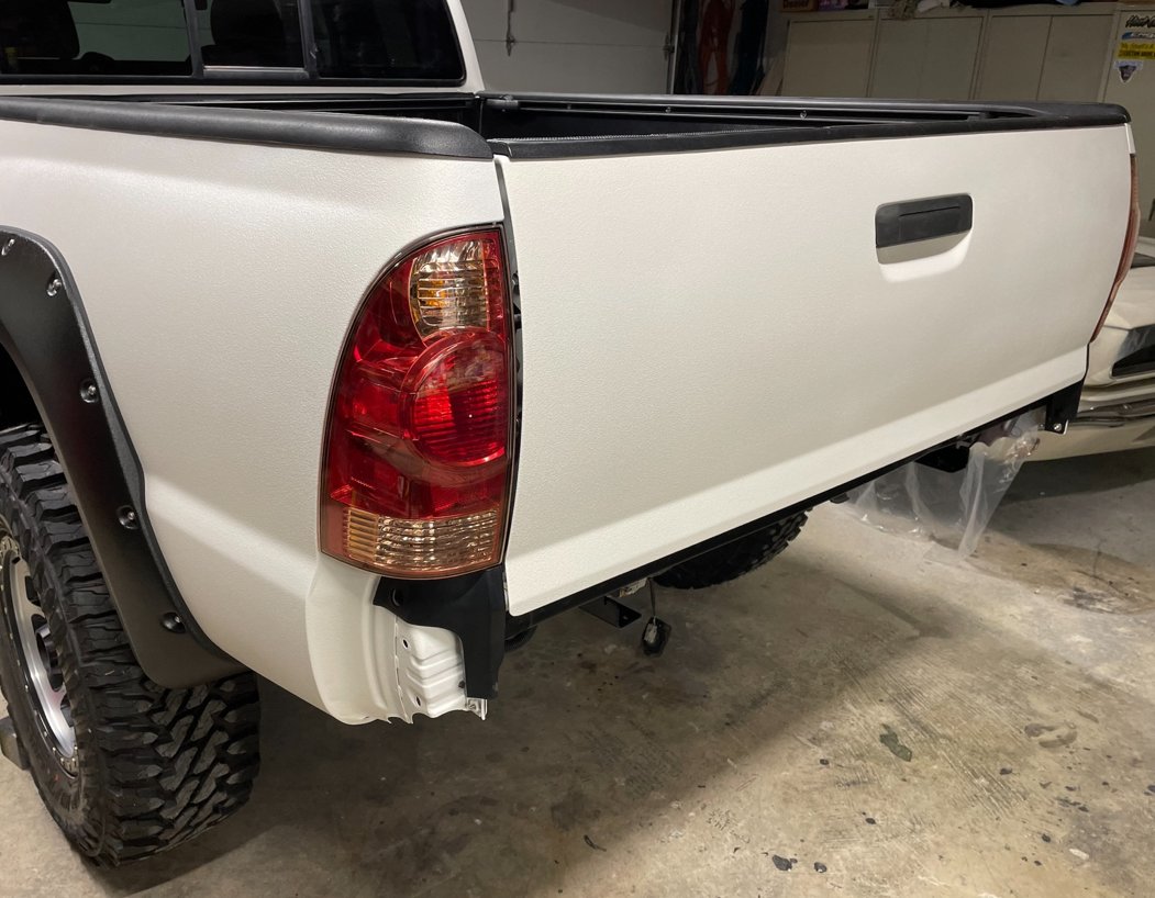

    We got the fender flares on along with my aftermarket TRD off road badges:

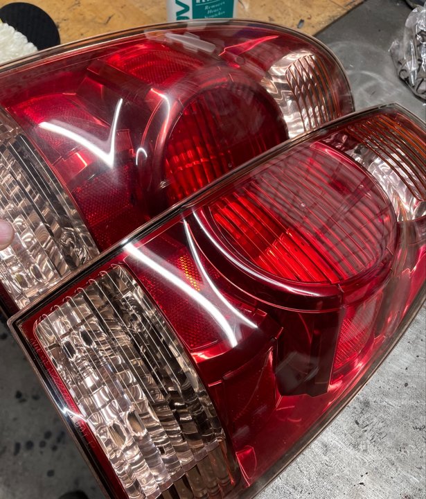

    Then got the tail lights polished with Novus plastic polish. Hard to see in the pictures, but it made a huge difference:
    And got them mounted with the tail gate:

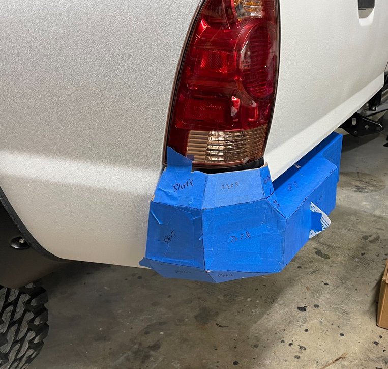

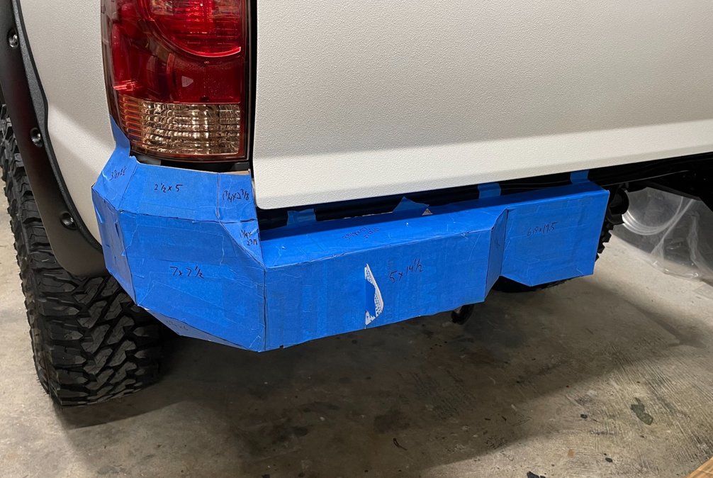

    Then we started mocking up a rear bumper out of a pizza box:

    CAD, Cardboard Aided Design! :thumbsup:

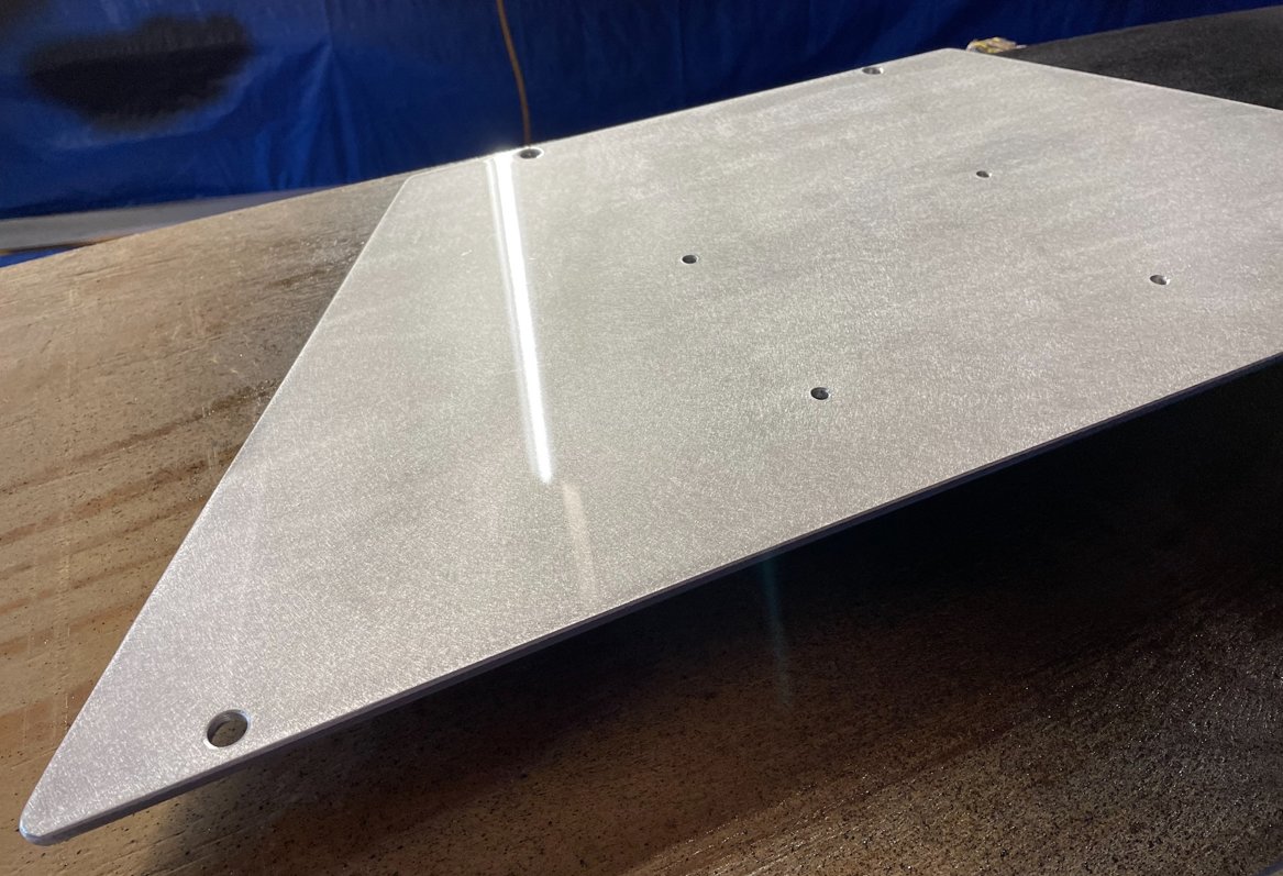

    we got the bumper pieces cut on the shear at my dad's work:
