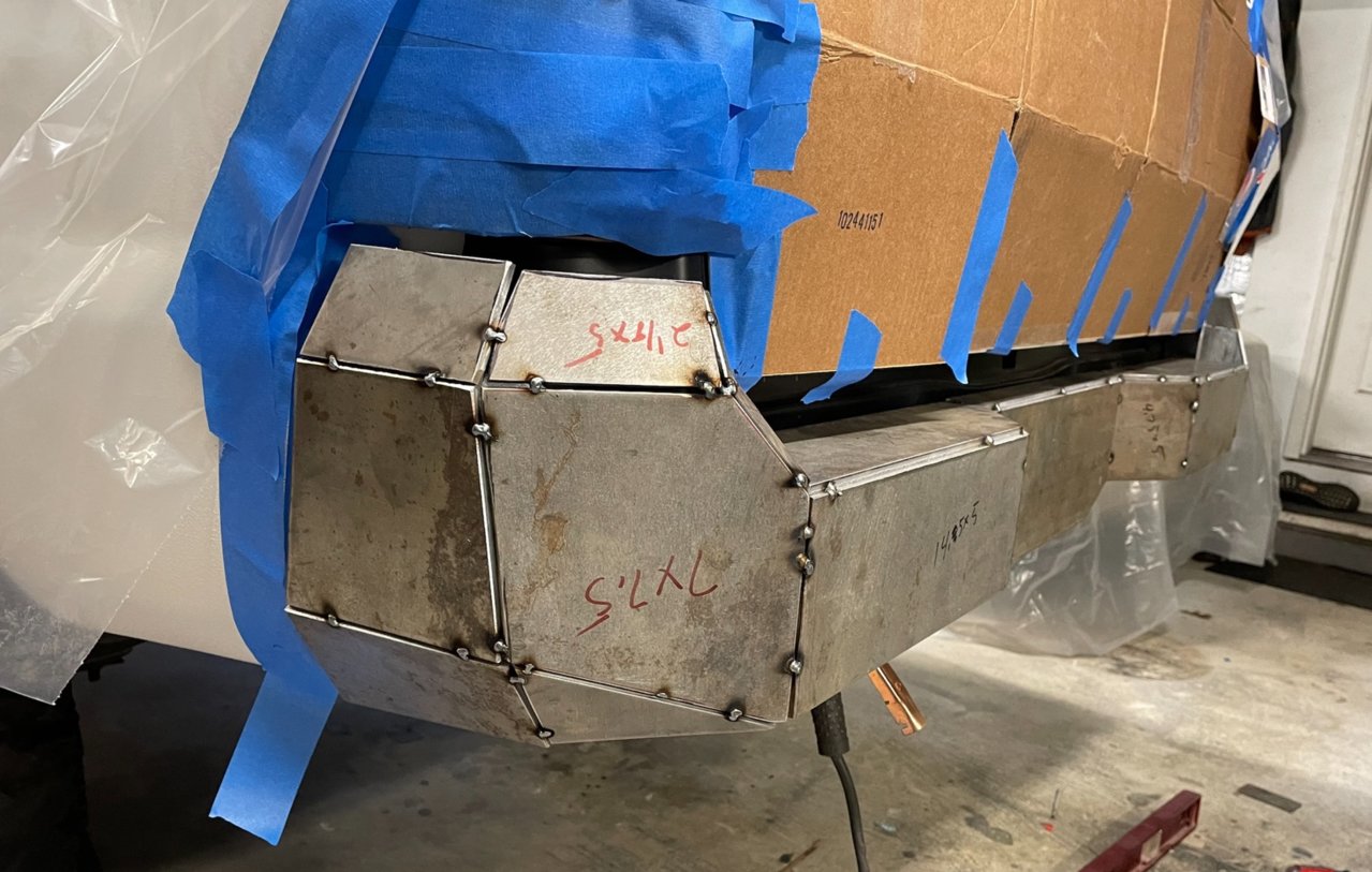

    yes, material is free as long as it is 1/4". so we will make it work. we are light in the rear anyways, don't even have a spare

    I was gonna ask if that was 1/4 or 3/16. Bumper is gonna be super beefy

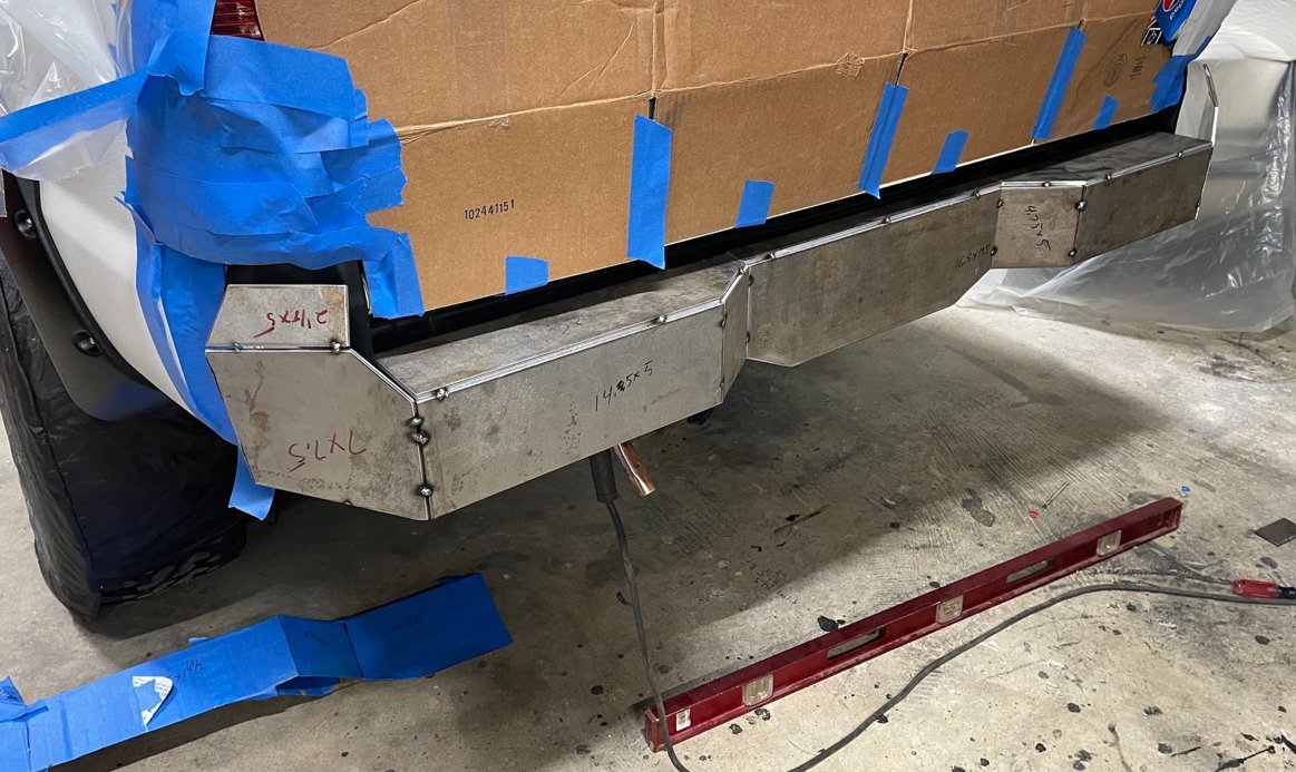

    Bumper progress:

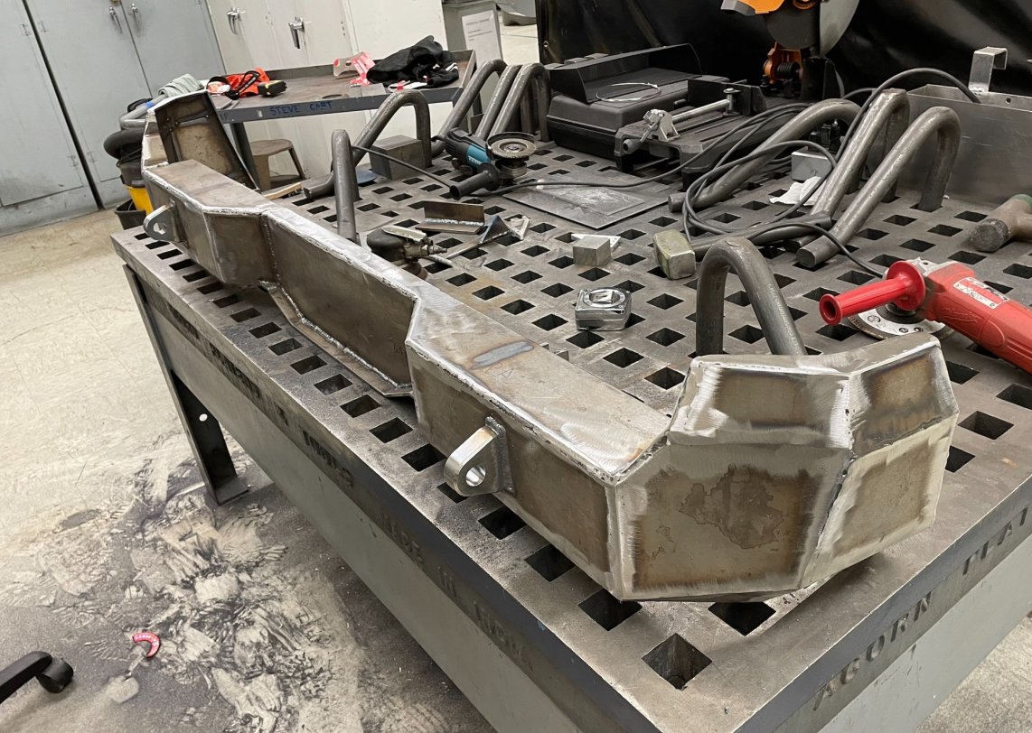

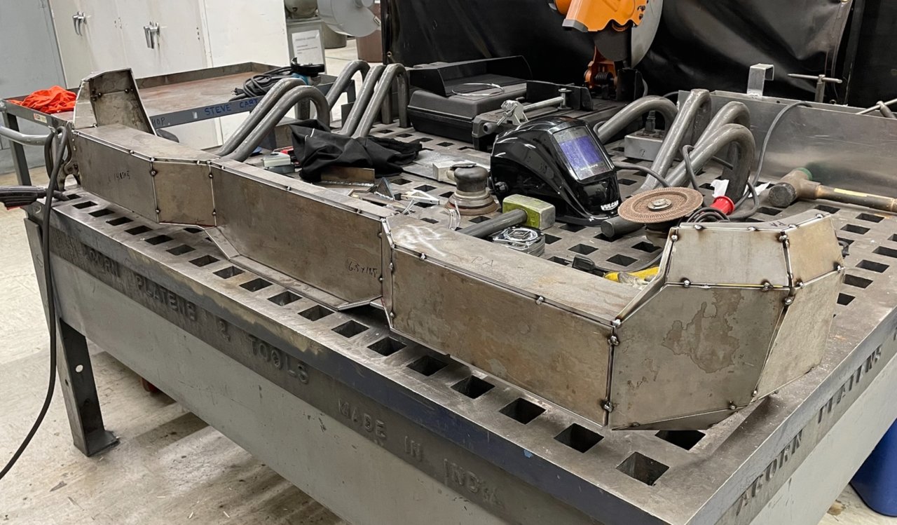

    we got the rest of the shape roughed in, lots of welding and grinding coming up

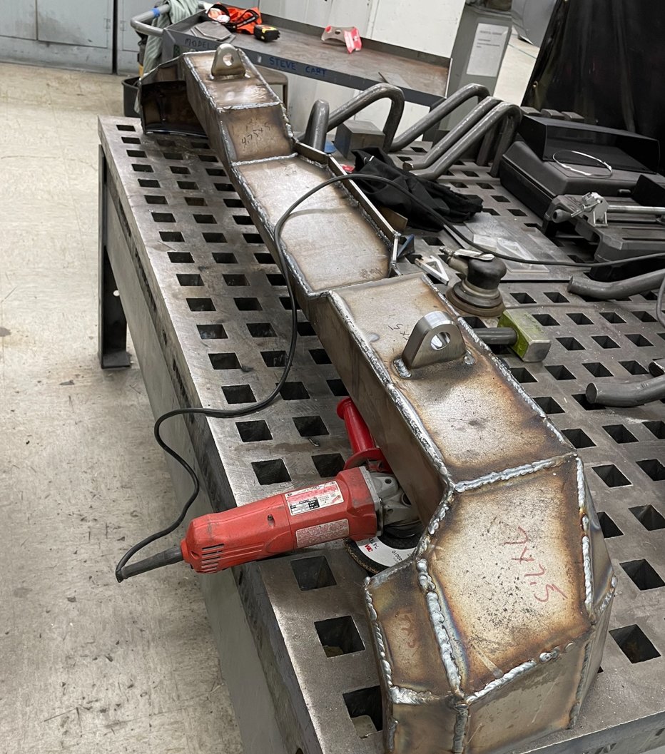

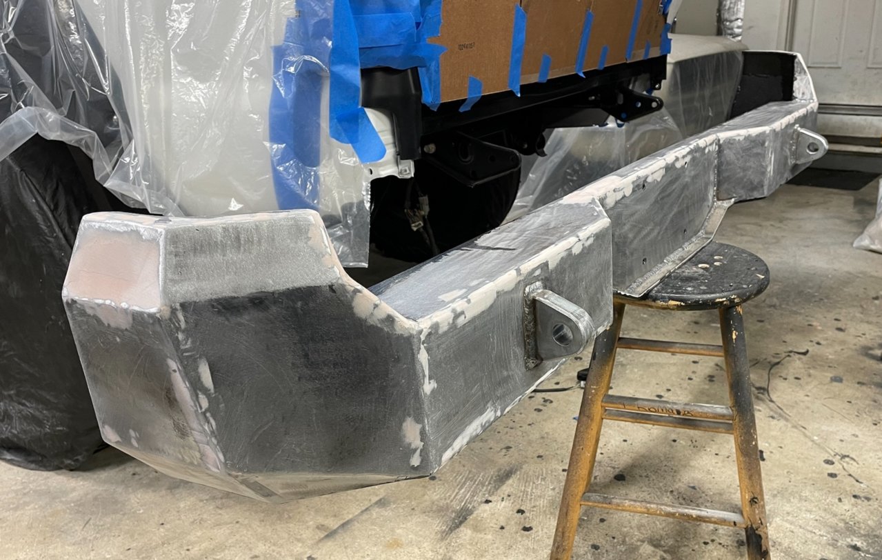

    We took it off and added some pieces across the bottom:
    2 hours of welding:
    And 1 hour of grinding:

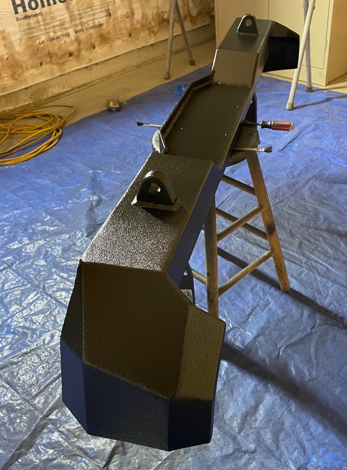

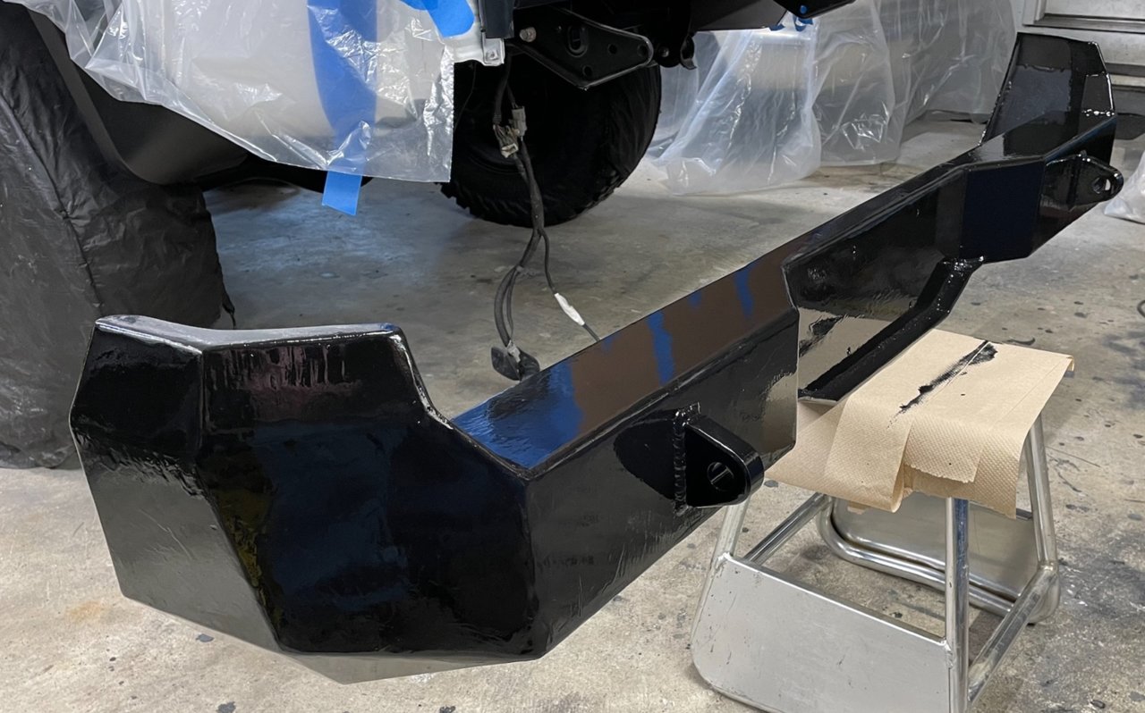

    We put on some filler to smooth out the corners:
    Then POR-15:
    Then Raptor Liner:

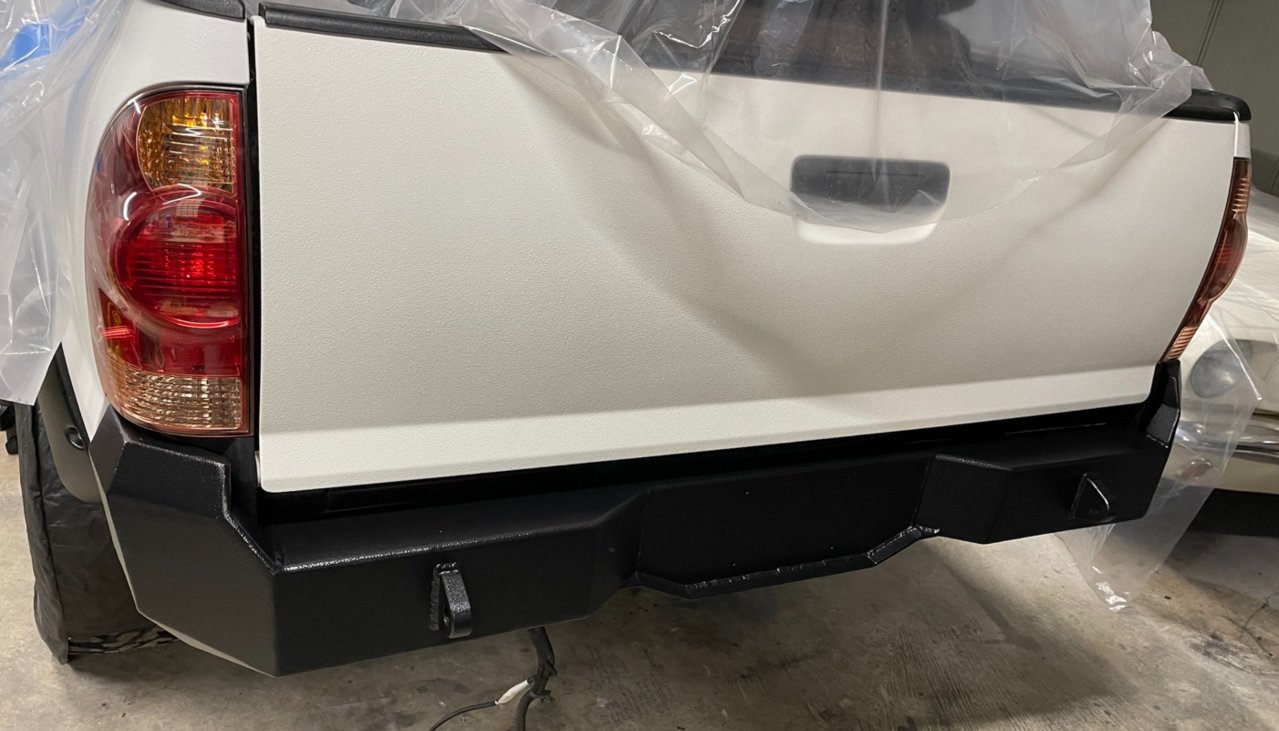

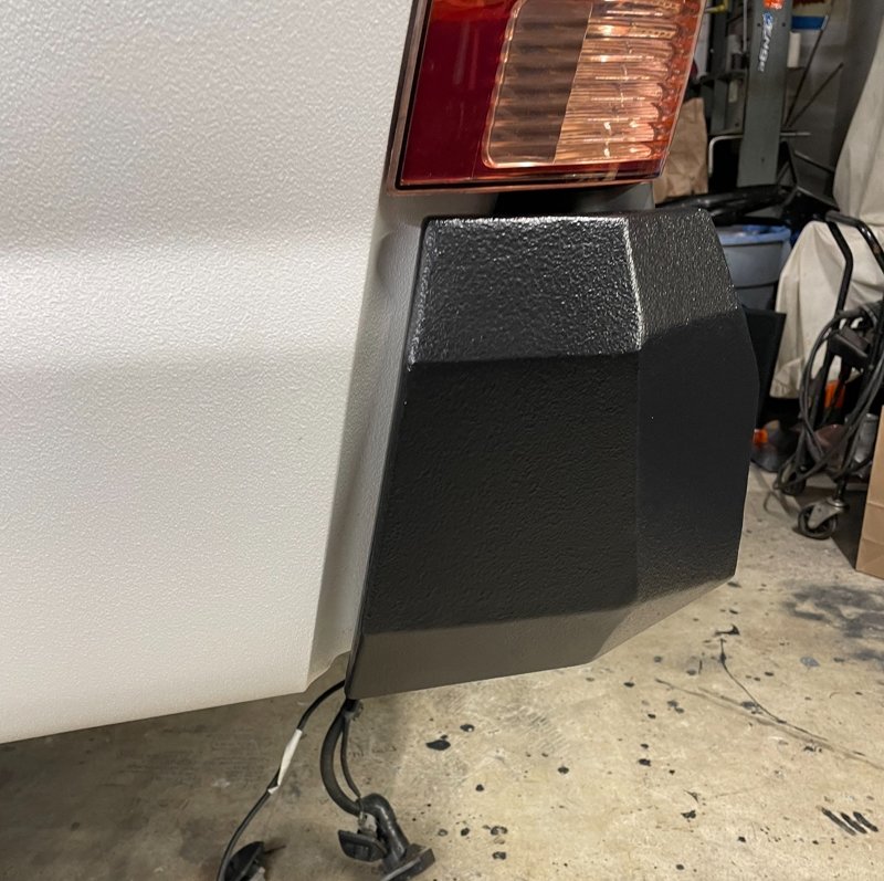

    bumper is on and came out really good:

    That looks great, so your finishing process is Bondo, POR, then raptor liner? Is there any primer used?

    Yes, thats it with scuffing the POR before the raptor
