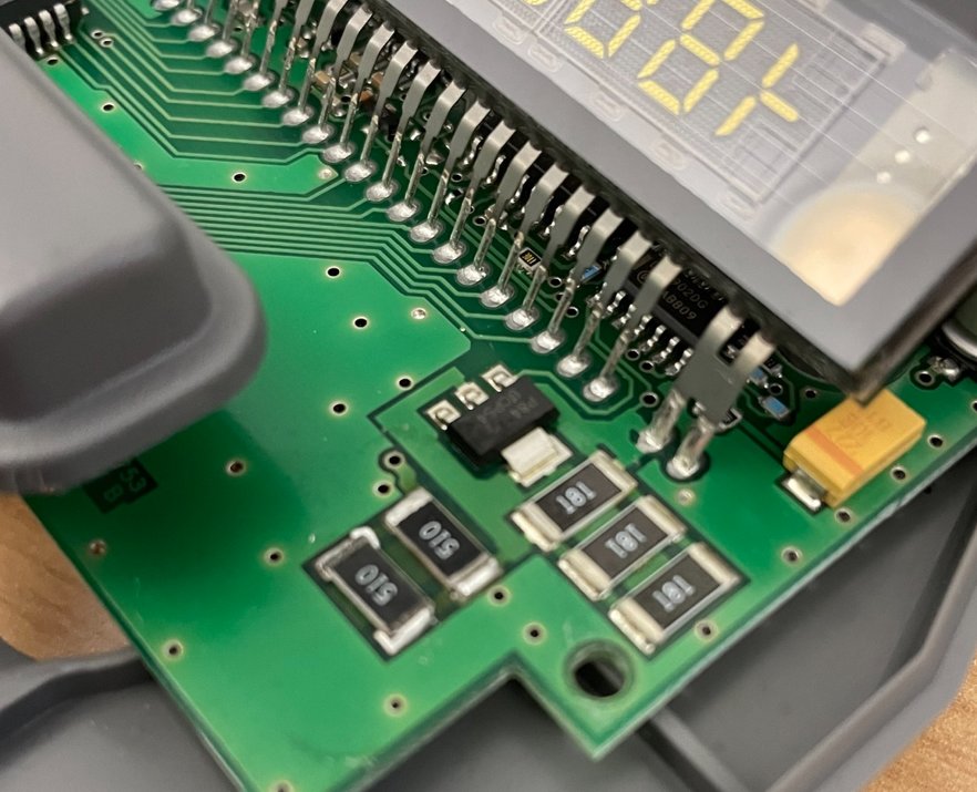

    Our temperature/compass display has never worked. Found the thread on the 510 resistor repair. We pulled it out and one of the resistors was completely detached, just laying in the housing and the other side had one side detached. Got them re-soldered on, but won't be able to reinstall until tonight. Hopefully it works:

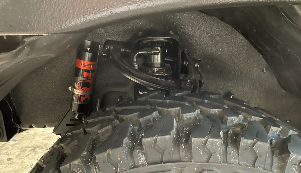

    When did you swap the front elka's for the fox's?
    I've got fox elites waiting to be installed. :mudding:
  5. Aug 29, 2023 at 4:42 PM
    #345
    jwarr
    jwarr [OP] Well-Known Member
    Jun 10, 2016
    #189219
    439
    We didn’t. Just fox decals do that the front matches the back

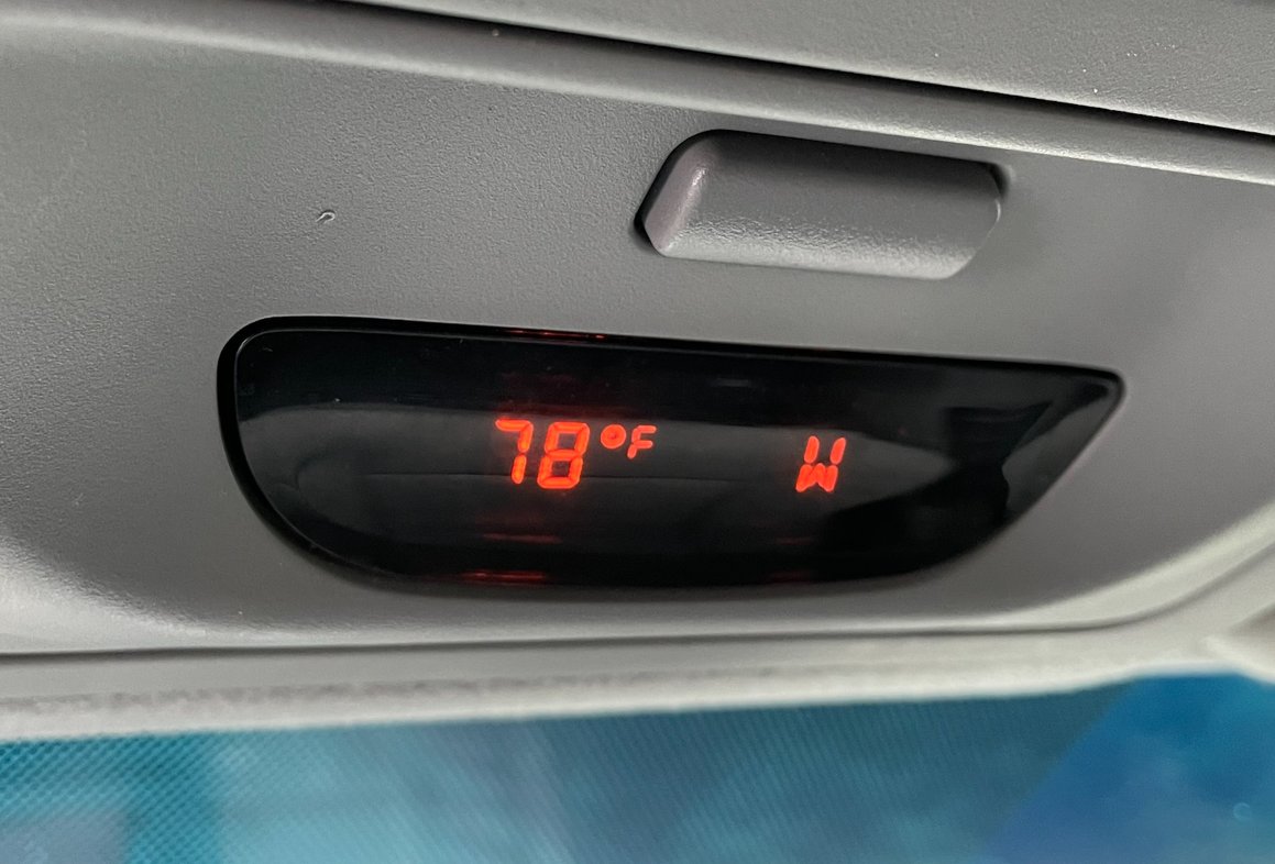

    439
    Works!

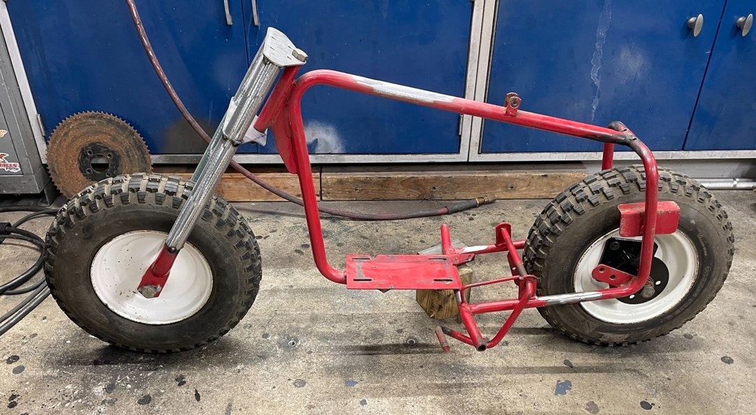

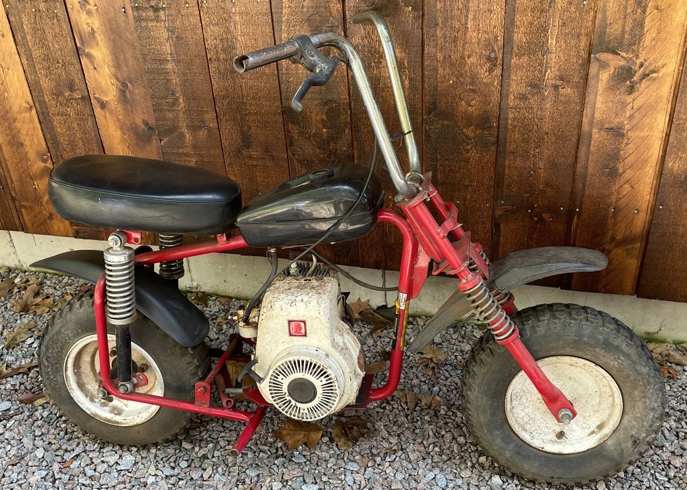

    New Project. Thinking an engine upgrade and an Ivan Stewart paint scheme to match the truck:
    MANCO Thunderbird
  9. Oct 19, 2023 at 6:34 AM
    #349
    TomTwo
    TomTwo I love God but I cuss a little
    Jul 14, 2013
    #108271
    14,174
    Bill
    I-85 Southbound
    2013 TRD Double Cab Sport
    Yes!!!!
  10. Oct 19, 2023 at 7:15 AM
    #350
    Ryan's Taco
    Ryan's Taco Well-Known Member
    Aug 31, 2022
    #404778
    1,316
    Prince Edward Island
    24 TRD Offroad manual
    Always a good read

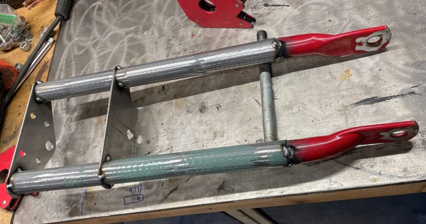

    we made new forks to get rid of the springs:

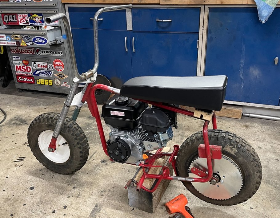

    Thanks, I will be getting back to the mini bike build soon and will post more pictures
