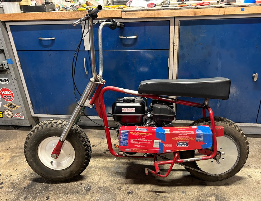

    got everything on and mocked up a new chain guard:

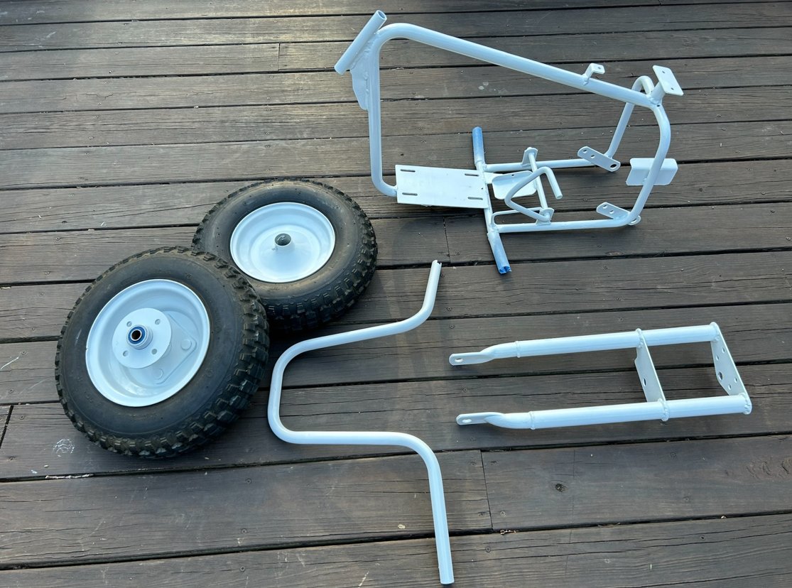

    out of paint and ready for final assembly:
  7. May 1, 2024 at 5:05 AM
    #367
    jwarr
    jwarr [OP] Well-Known Member
    Jun 10, 2016
    #189219
    439
    from bacon box to stainless steel:

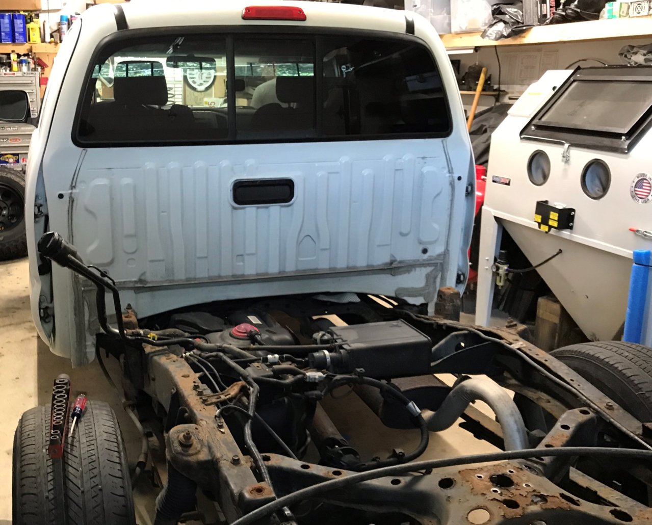

    Hey! I’m wondering how did you manage to disassemble the cabin? I’m going to do the same job on my truck, but I simply cannot find where to start…
  9. May 6, 2024 at 4:27 AM
    #369
    jwarr
    Jun 10, 2016
    #189219
    439

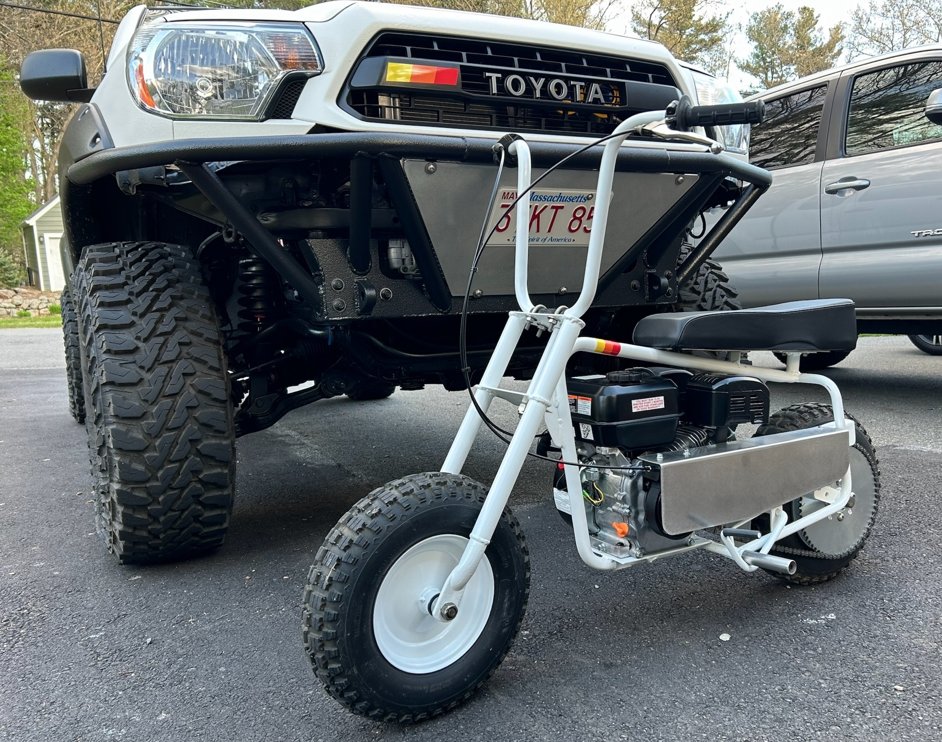

    Mini bike is done and it is fast!
  10. May 6, 2024 at 4:40 AM
    #370
    jwarr
    Jun 10, 2016
    #189219
    439
    remove hood, front end, fenders, carefully disconnect every wire and line (fuel/brake) that is connecting it to the frame, we disconnected the engine harness from the computer in the cab and left the harness with the engine.
    Then it is just 6 body mount bolts... but overall, this is NOT an easy job...

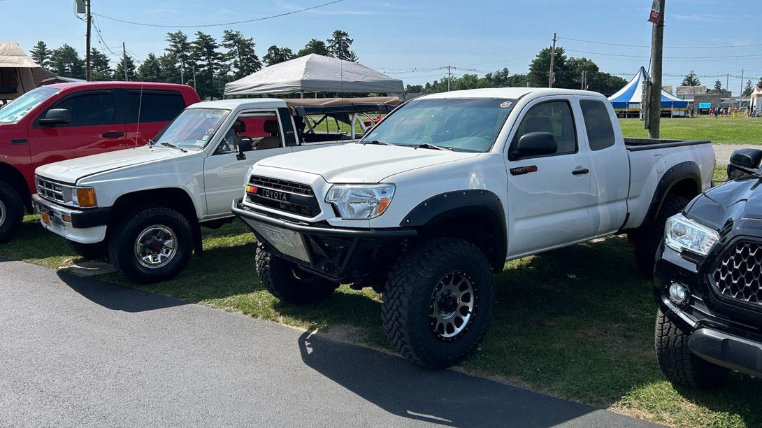

    We made it to Toyota Fest in Greenfield MA yesterday. Pretty good turn out, 2-300 cars, if anyone is interested for next year. They grouped vehicles by type which was interesting.

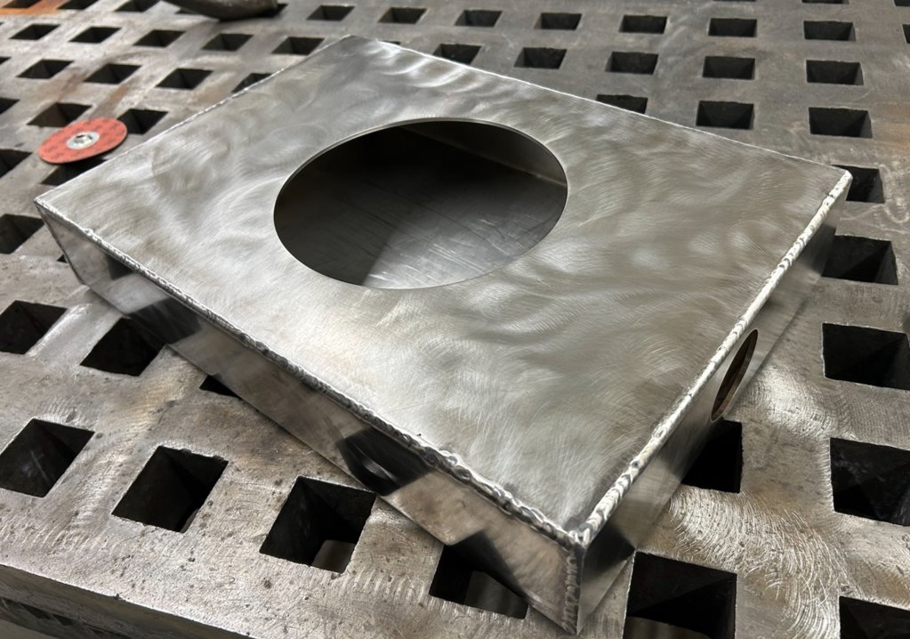

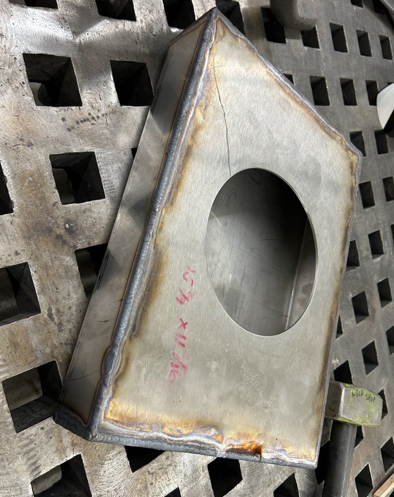

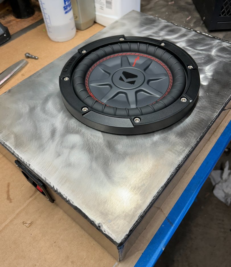

    We are going to try fitting the sub under the passngers seat (with seat risers and the bar flipped). Sealed enclosure, made from free (from my dad's work) 1/8" stainless steel (non-magnetic) to get the most internal volume possible.
    Here is the box:
    After hitting it with a scotch bright disc:
    Plan is to line it with sounds deadener and add poly fil. Box is 16x3x11, putting the internal volume around .29 cubic feet. the sub minnimum recommended is .2 cubic feet for sealed.

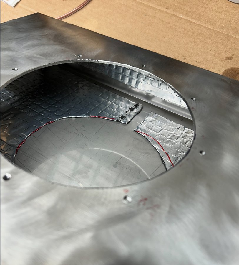

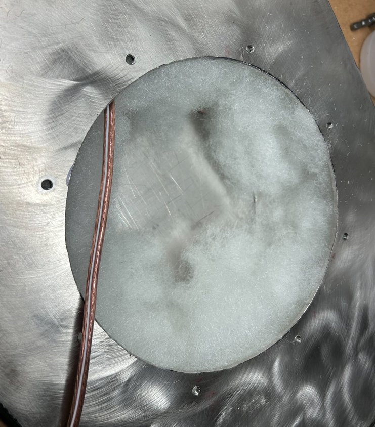

    We lined the box with sound deadener material:
    Sounds deadening material is this stuff from Amazon:
    Then added polyfil:
    and added the sub:
    The box is 3" tall, and the sub sticks out another .75", hopefully it fits under OK
