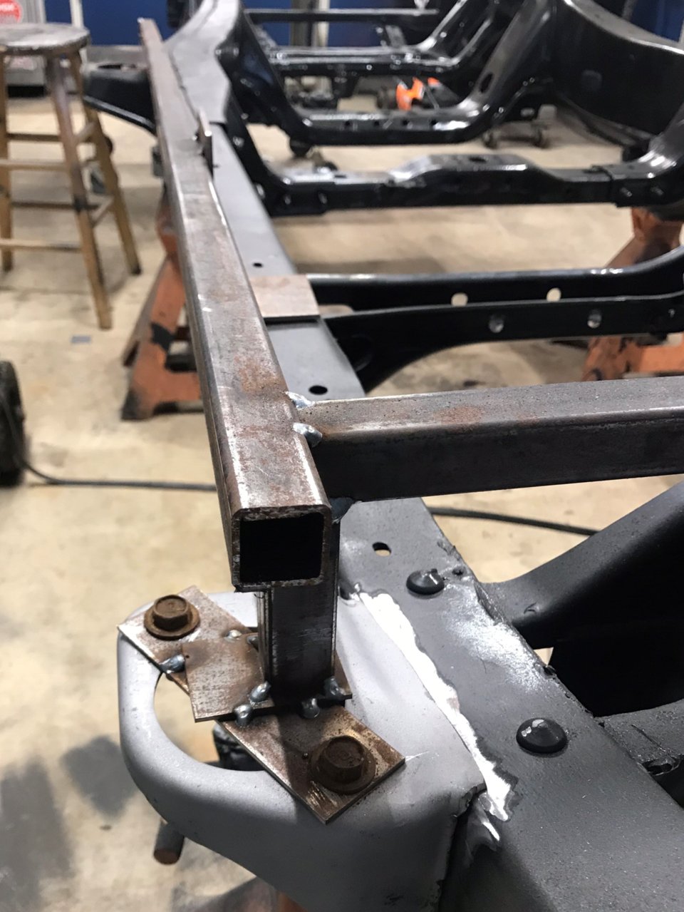

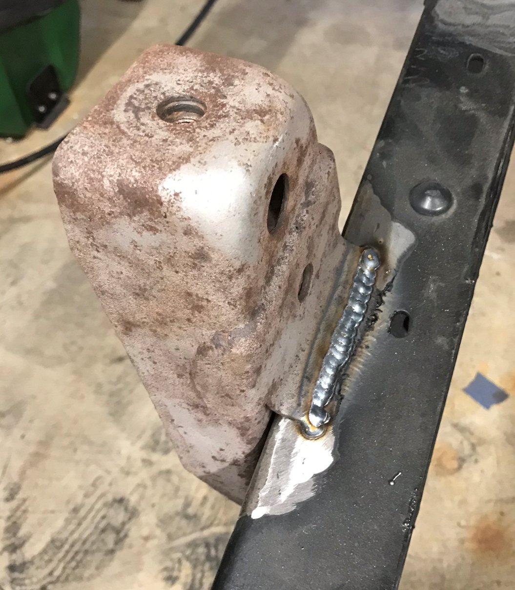

    We used the fixtures that we made to locate the rear body and front bed mounts onto our frame, everything seemed to fit right:
    Then my dad welded them on:
    lynyrd3, mjp2, TRD-ED and 4 others like this.

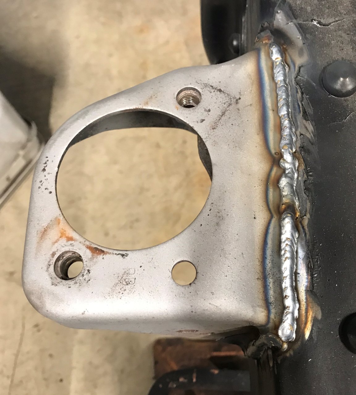

    And we got our BAMF shock relocation brackets welded. 1/4" is a little thick for our Miller 140 welder, but they should hold together:

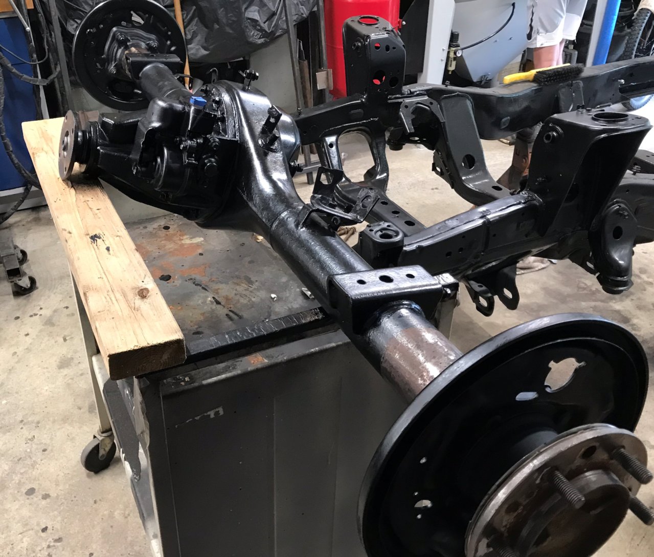

  6. Aug 30, 2021 at 10:49 AM

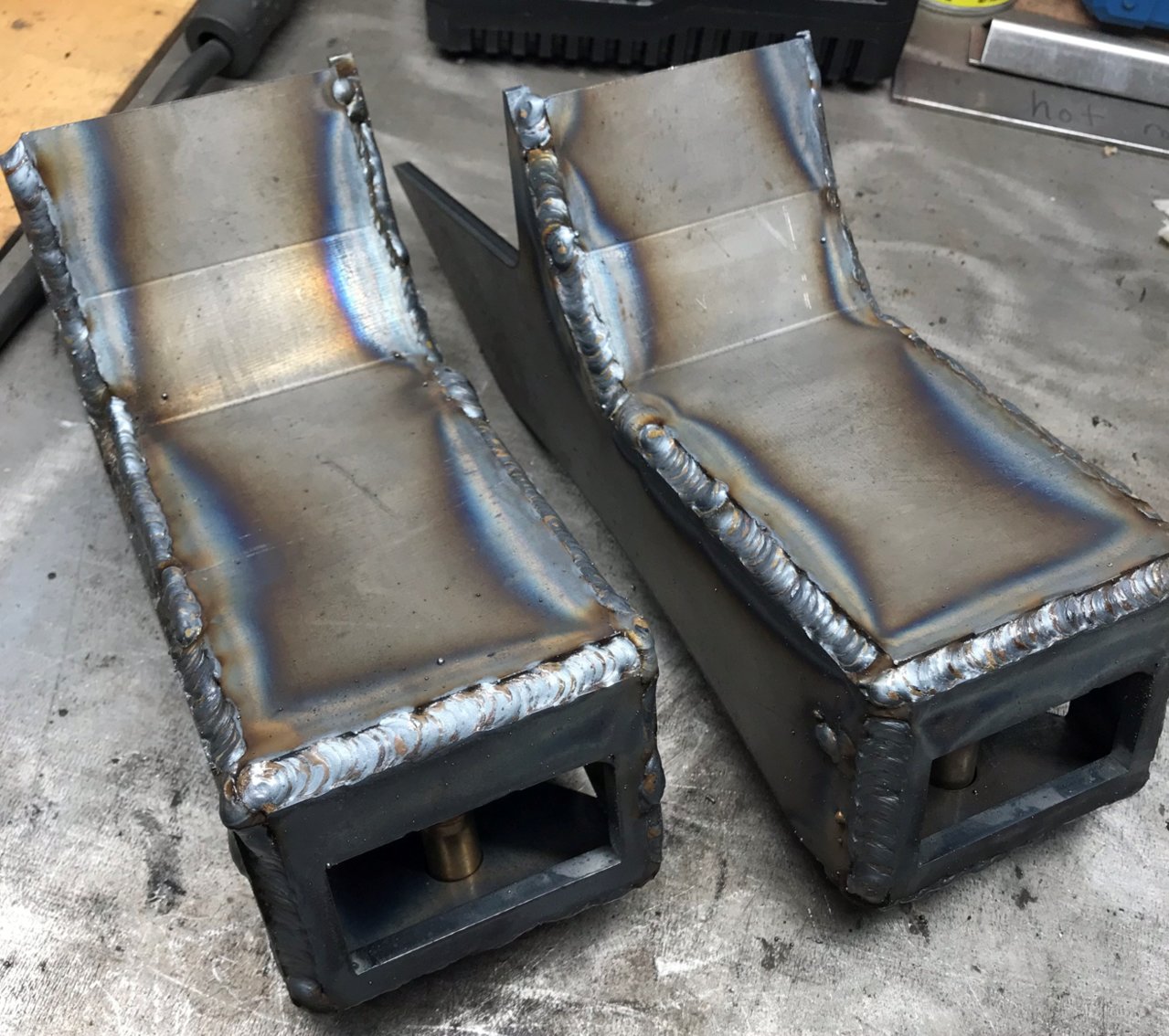

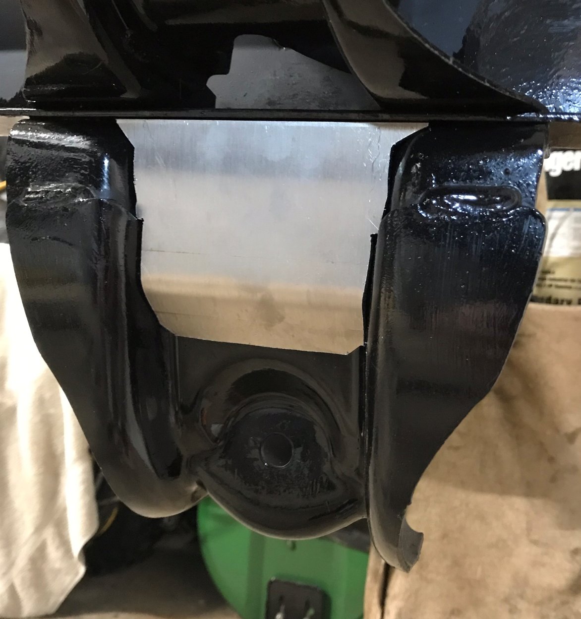

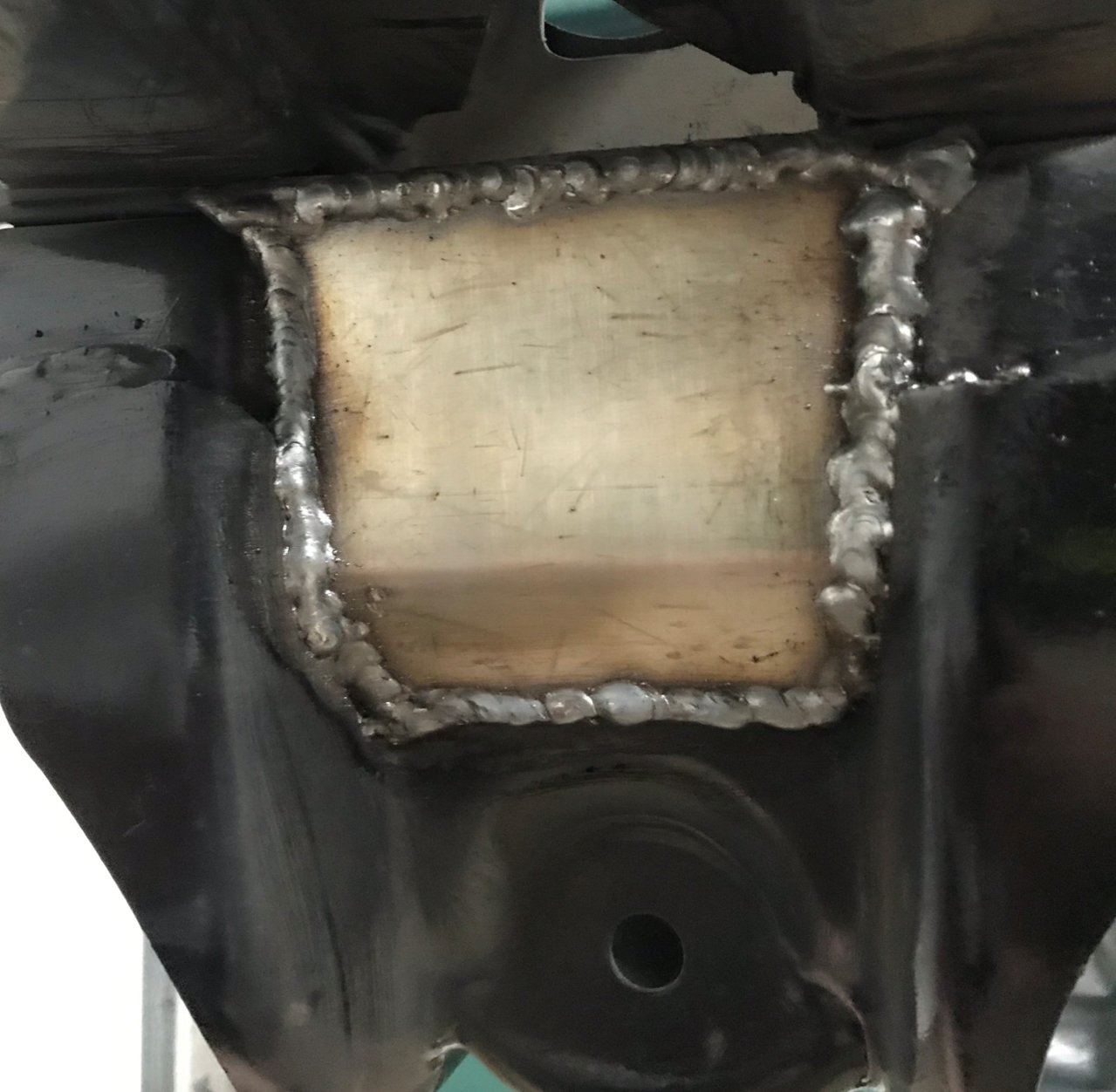

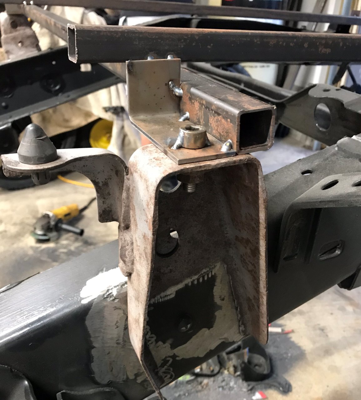

    We spent some time yesterday reinforcing the stock shackle hangers. Hammer Hangers are really nice, but expensive. So we made these plates to box them in:
    Then fully welded them:

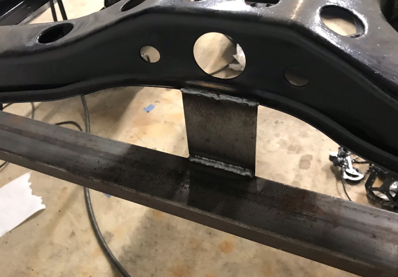

    Then connected the 2 sides with 1x2 tubing:

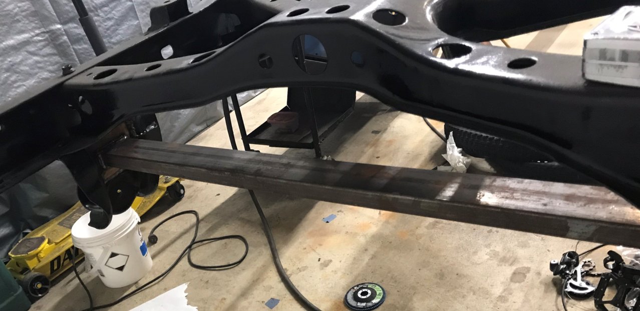

    Then we tied the tubing into the spare tire cross piece:

    D2.
    D2. Well-Known Member
    Dec 1, 2016
    #203759
    1,578
    Dan
    Nova Scotia, Canada
    2009 Tacoma - access cab 4x4 2TR-FE
    Cruise Control install. Intermittent wipers Hood lights Bed Lights Sliders 3" lift 886's on Billy 5100's Icon AAL 285/75 R16 Falken Wildpeak AT3W's
    ya know what they say.....
    miller for drinkin... Lincoln for welding... :rofl:
    I kid, I have a migpack 140, and welded some 1/4" plate a few times, While not "ideal" I think the 140 welders ( Lincoln or Miller ) can get the job done just fine. While I'm not expert, I'd rock those welds and not think twice about them.

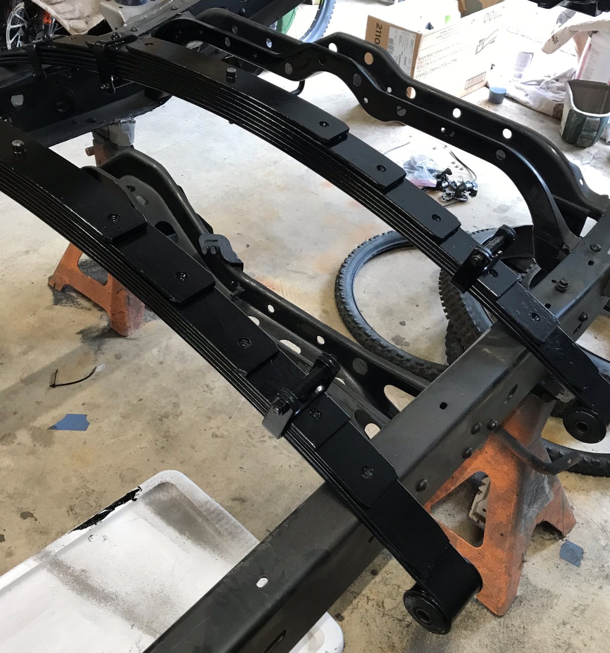

    After a few more hours of cutting and grinding, we got the shock mounts off of the axle:
    And the new ICON Leafs and rear axle painted in POR-15:
