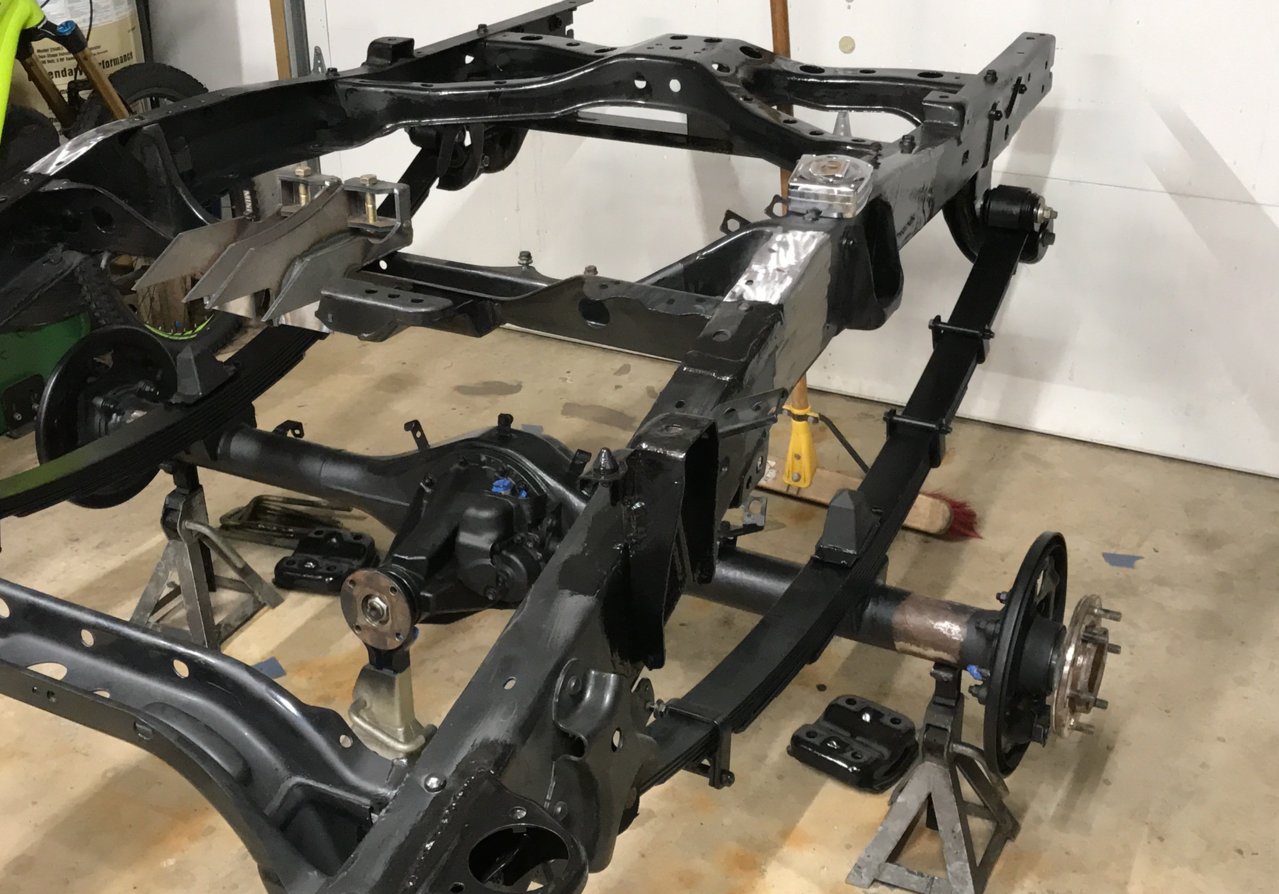

    Here is our disassembly order list. The good news is that we have officially started to cross things off it.
    We got the rear axle back in position with the new leafs:

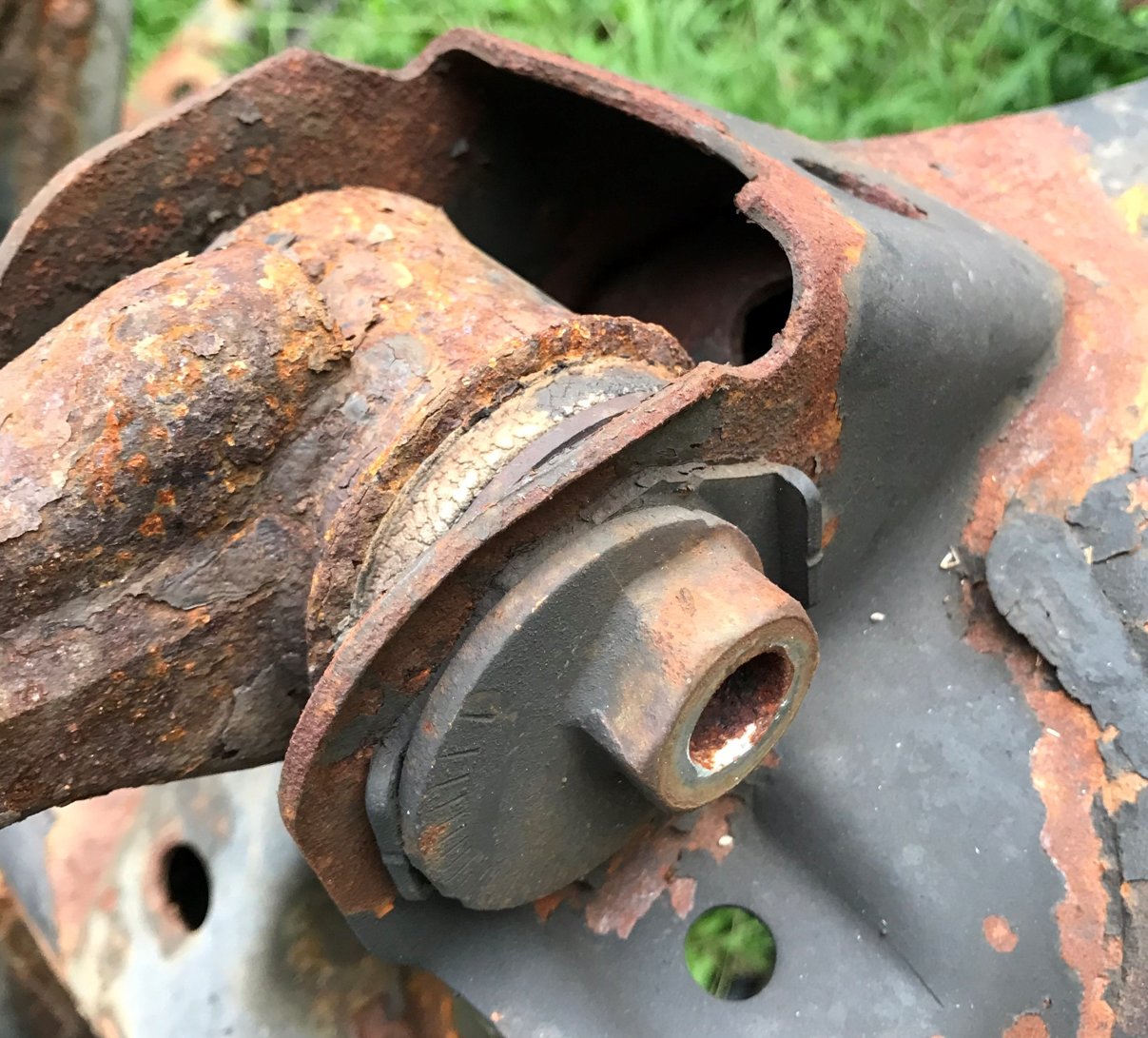

    And looking at the old frame, we decided to add some welds to the cam tabs:

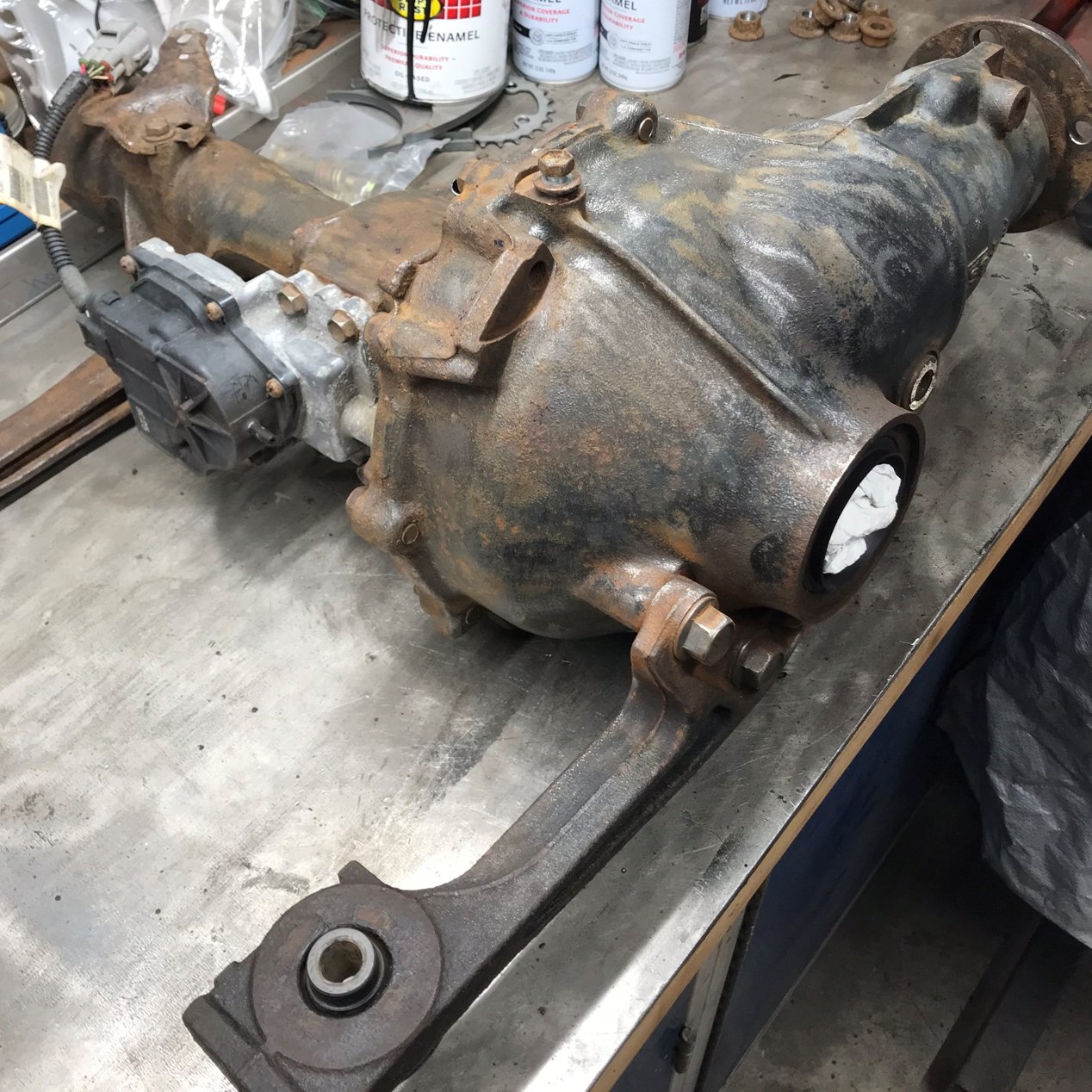

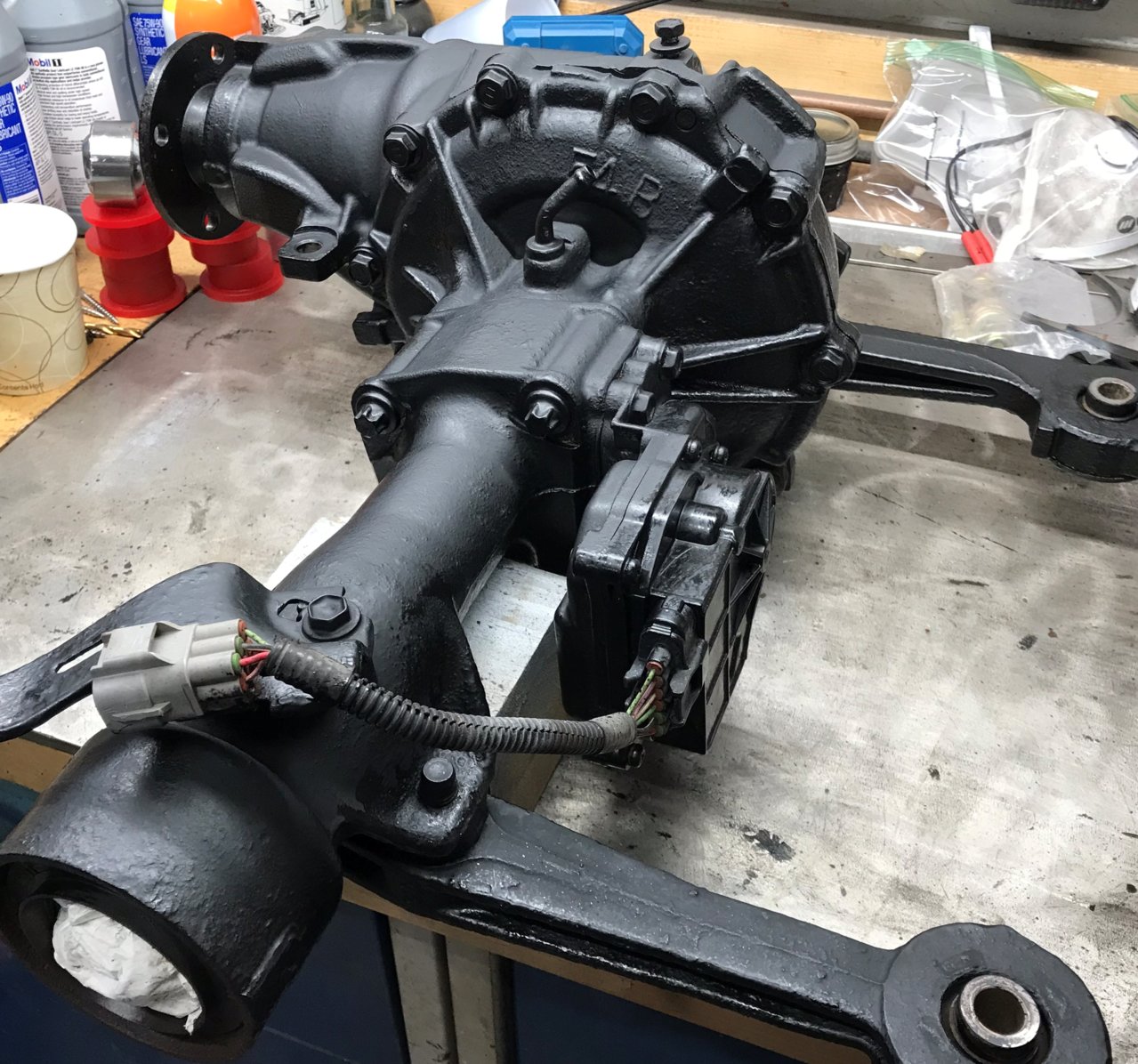

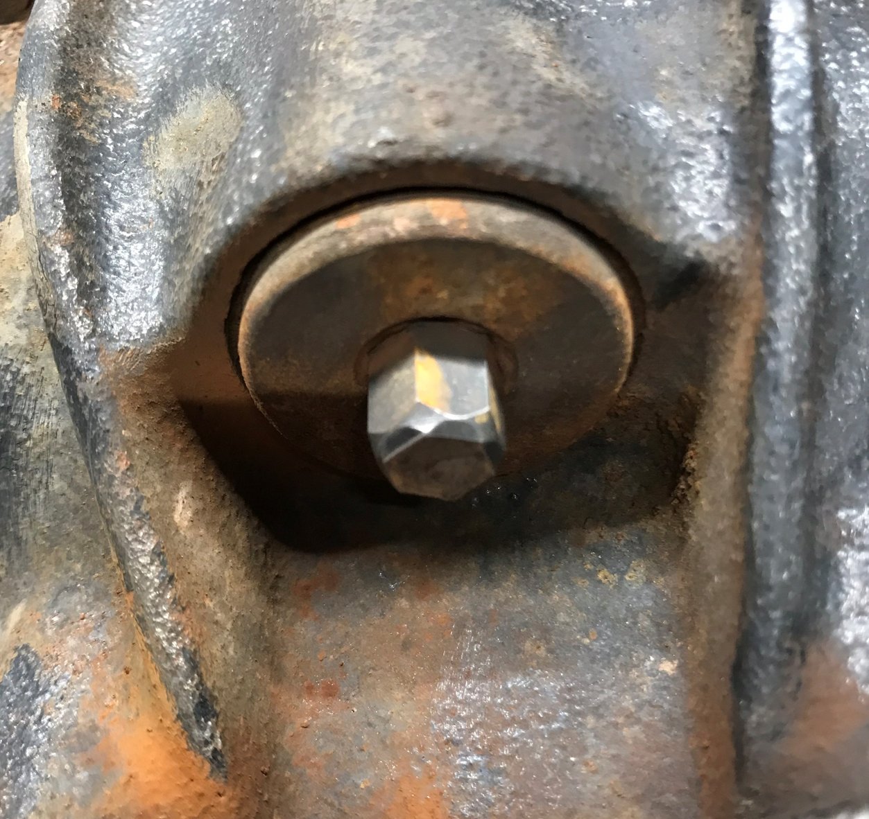

    and we got the front differential cleaned up:
    We broke off an allen socket in the drain plug, but luckily there was enough left of it to get a 10mm socket onto it. We got it loose with a breaker bar and a socket.

    I painted the front diff with POR-15:

    That dif drain plug sucks. I have found that it helps giving it a few good wacks with a hammer to loosen things up before you crank on it.
    Theres a Lexus plug that's better, although you basically made the same thing when your Allen wrench snapped.
    https://adventuretaco.com/a-front-diff-drain-fill-plug-that-doesnt-suck/
    I was going to suggest the same thing. I am a big fan of the FJ case and AWD tube swap to get rid of electronics in the drivetrain.

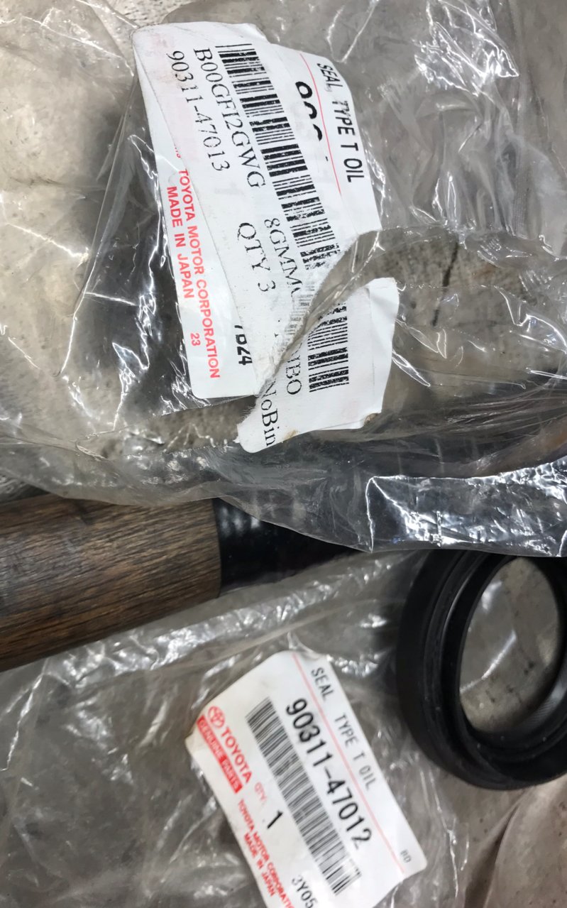

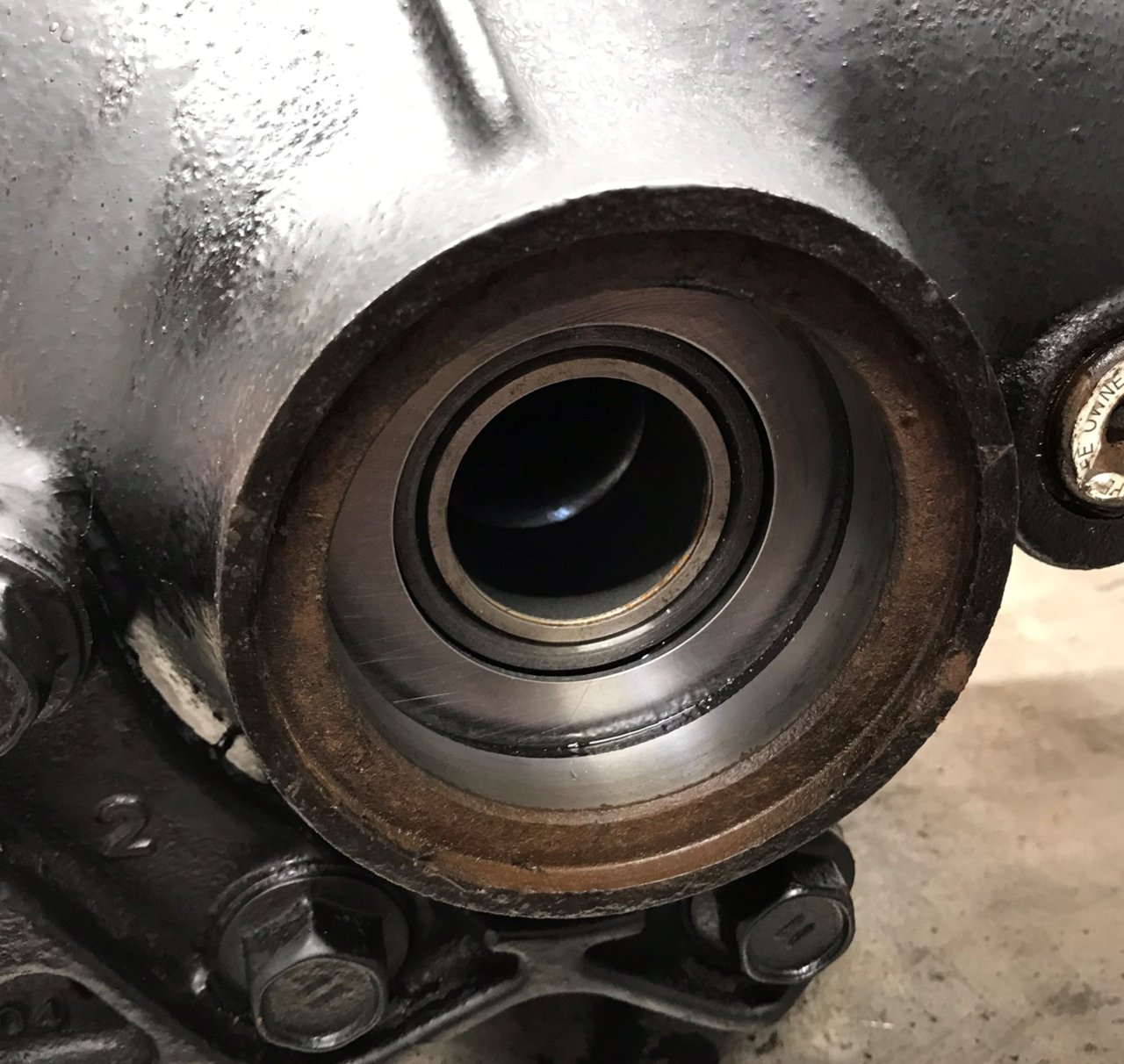

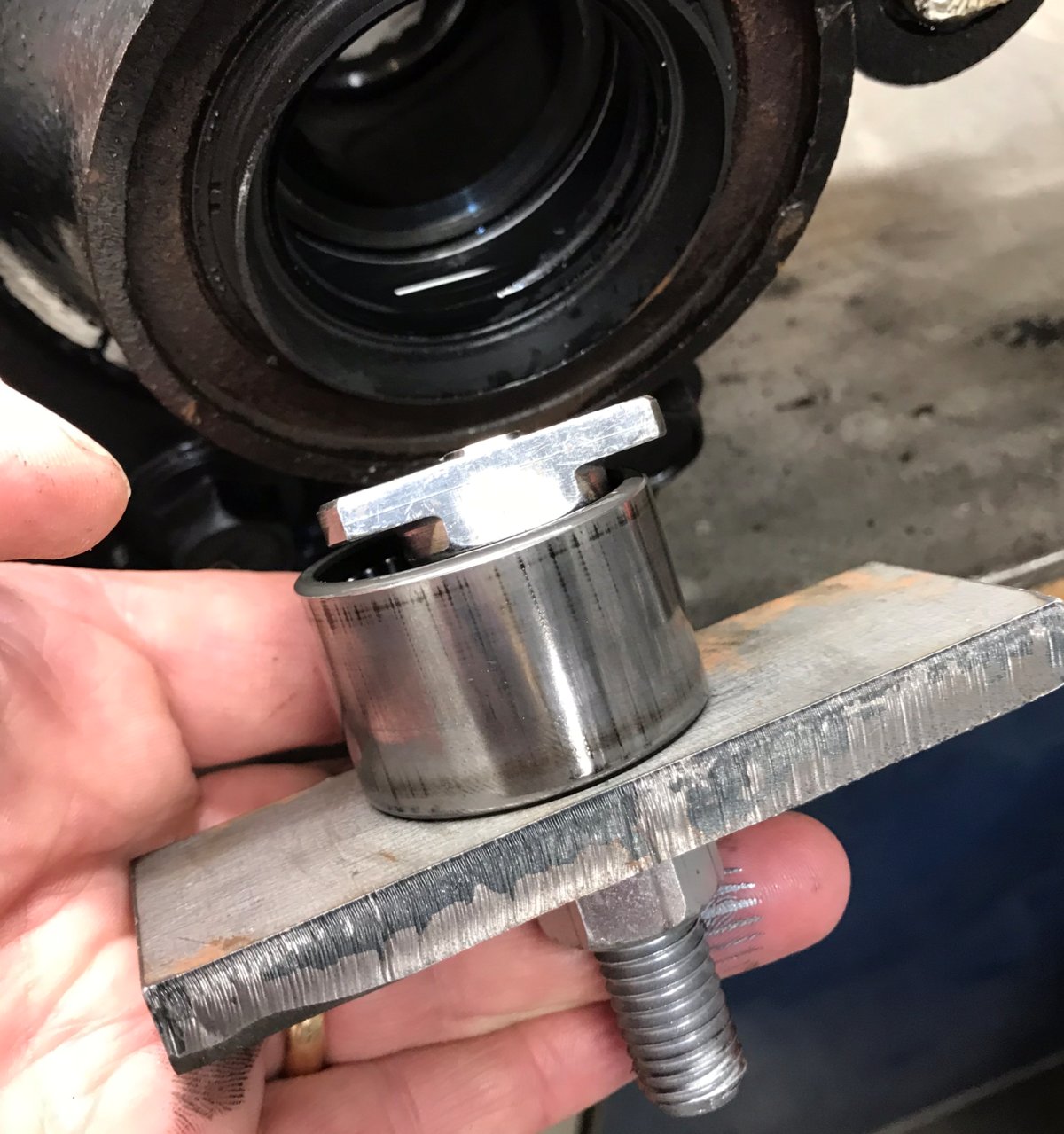

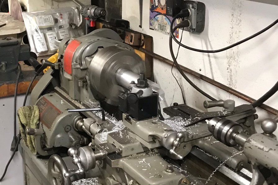

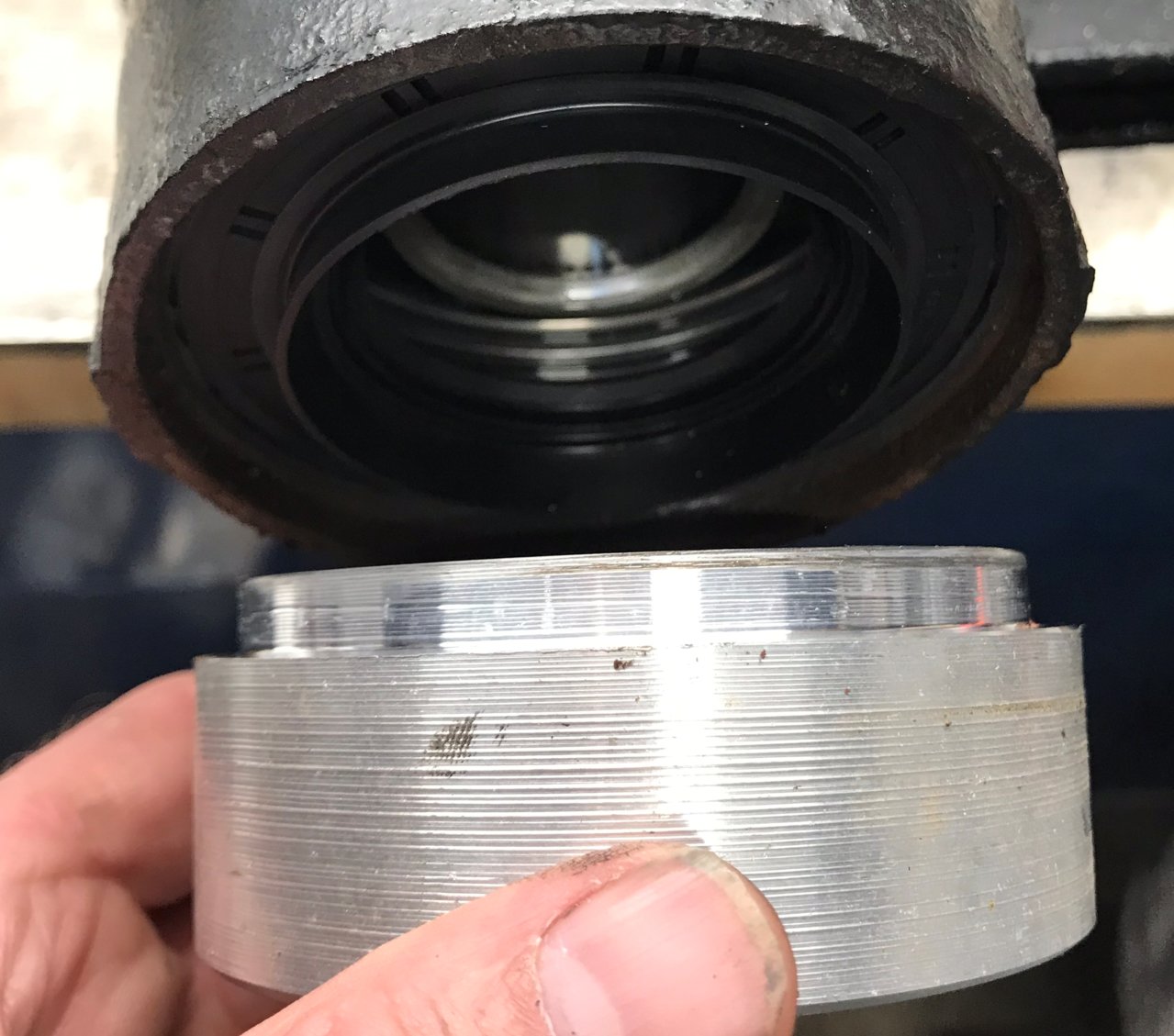

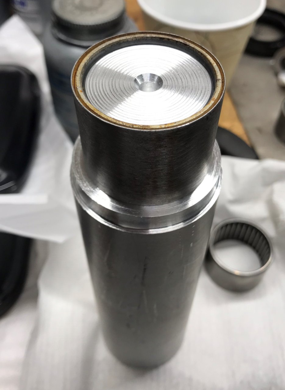

    We pulled out the front diff needle bearing with an ECGS tool from the loaner program (thanks CO90Taco) and my dad showed me how to make a tool to put the Bushing back in on the lathe:
    Then we changed the CV axle seals with more home made tools:
