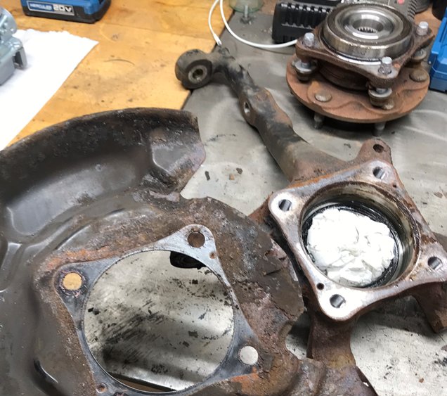

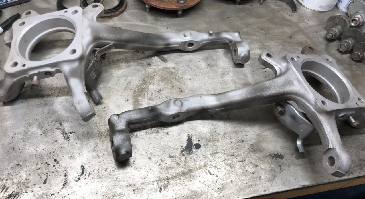

    I blasted my spindles to get them ready for gussets:

    Keep those bump extensions tacked until you are completely done and can flex the suspension out and see. Then you can easily fine tune them. Trust me with as much frame flex and all there is on these trucks real world > forklift flex > math. The math gives you a good reference but from experience doesn't get you all the way there.

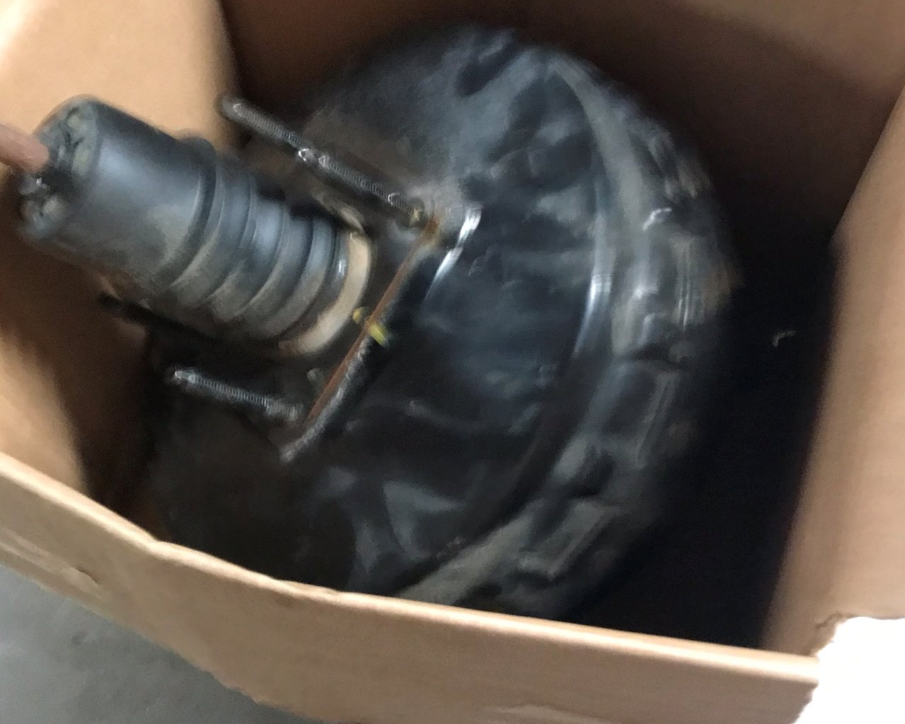

    We found a tundra booster local:

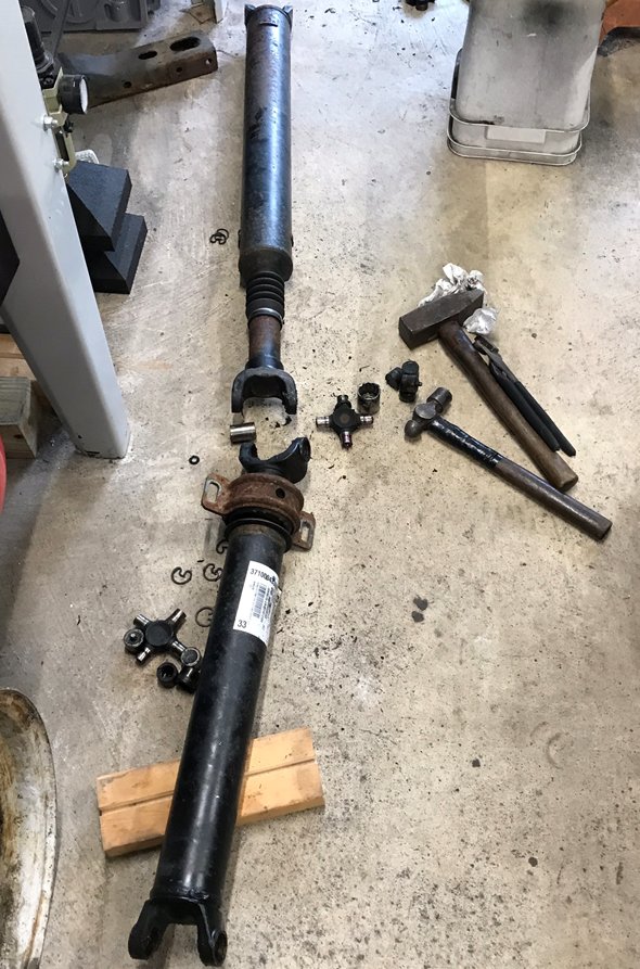

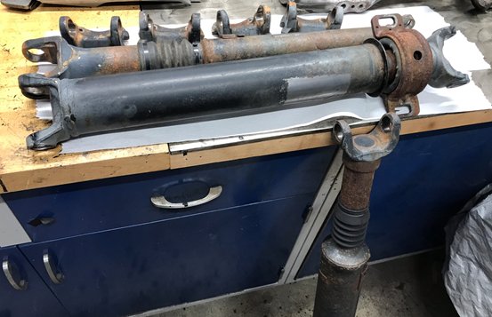

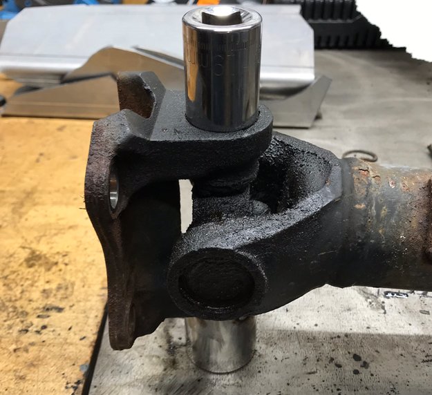

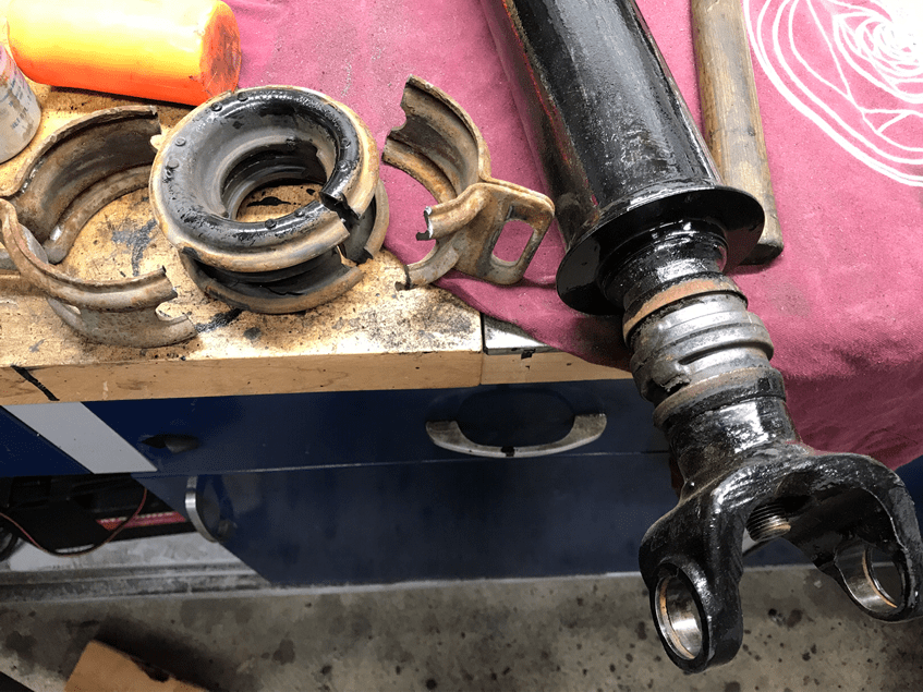

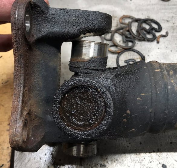

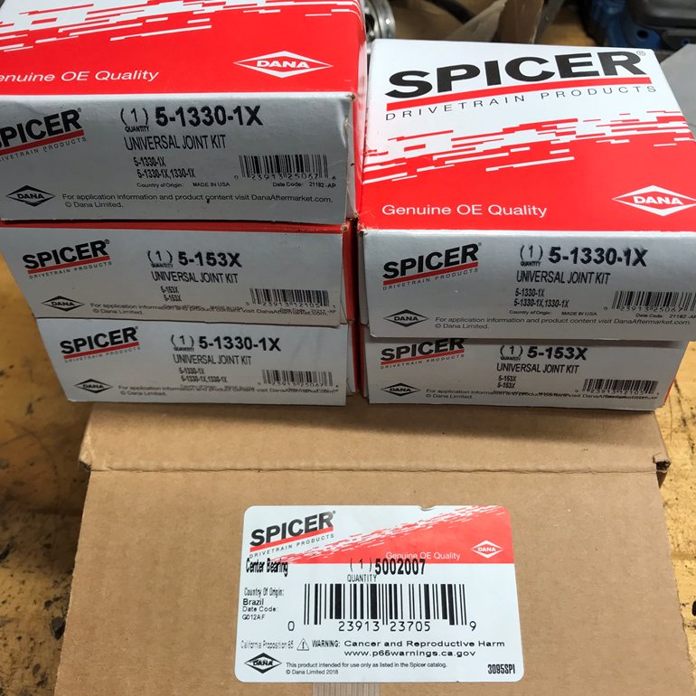

    Drive shaft rebuild day. None of the u-joints seemed bad, but we decided to replace them all while the drive shafts were out along with the carrier bearing:
    After removing the clips, we used 2 sockets to hammer out the caps:

    Then got all the old grease cleaned off to get everything ready for the new parts:

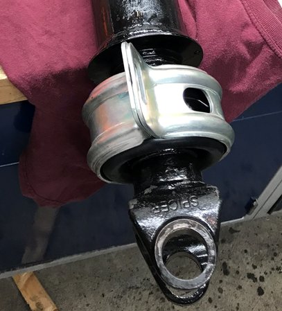

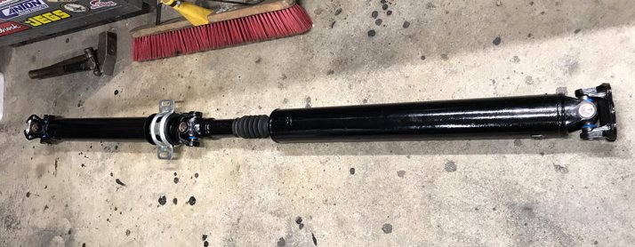

    The yoke wouldn't slide off so we cut the carrier bearing metal part off so that we could tap the yoke:
    Then used a 3 jaw puller to pull the bearing off:
    New carrier bearing on with the arrows point forward:
    Front driveshaft done ($22 total cost):
    Rear Driveshaft done ($149 total cost):

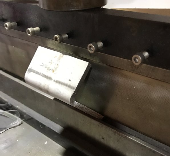

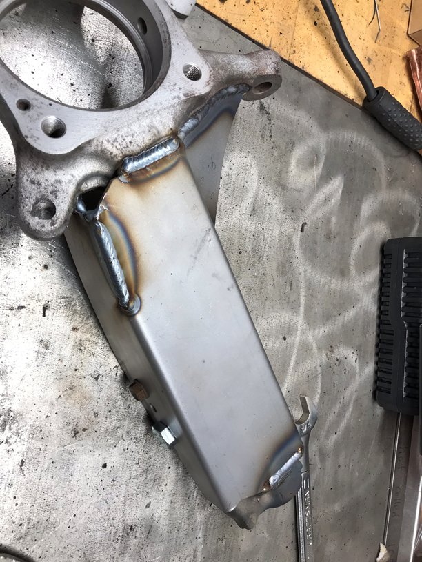

    And the total chaos spindle gussets came and my dad started welding them:

    That boy could weld. :thumbsup:

    Oh man, so these just reinforce the OEM spindels? Thats awesome. I wish I had a real welding setup to do this.

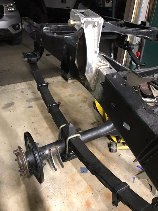

    and the rear shocks came from accutune. These are FOX 2.0x12 performance series 985-24-054

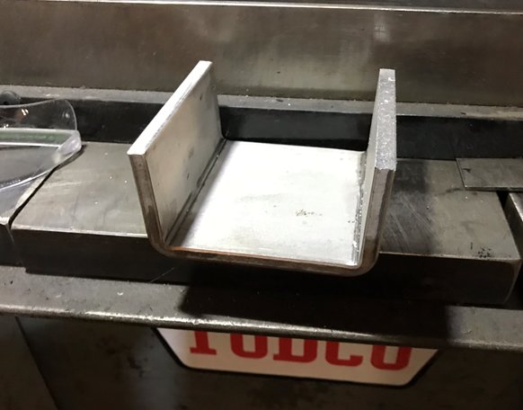

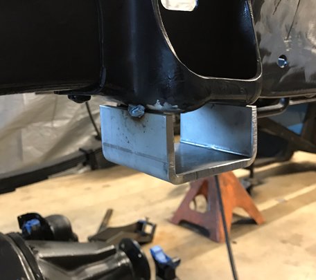

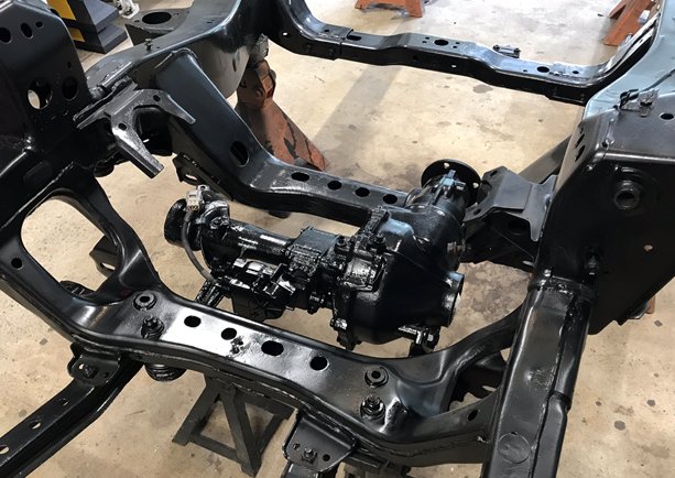

    We reduced the bump stop extensions to 1" and got the new shock towers welded on along with the lower axle mounts:

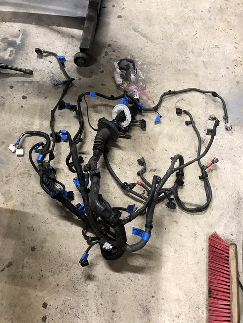

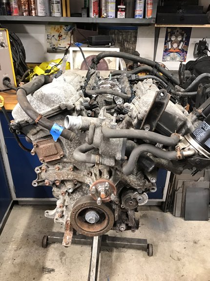

    Then started stripping down the engine to get it cleaned up:
