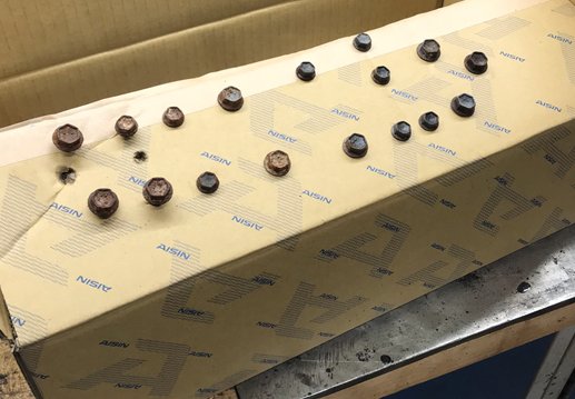

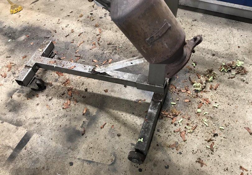

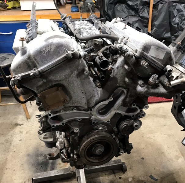

    We got the engine wire brushed to get the dusty aluminum corrosion off and got the water pump off:
    Then found a mouse nest down in the valley under the intake manifold:
    This is how we kept track of the water pump bolts:

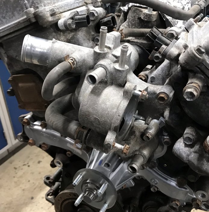

    We got the water pump black on. The water pump did come with both o-rings for the thermostat housing, so there is no need to buy extras.
    and then the thermostat housing part with the new orings on the tube and in the water pump groove. we lubricated the orings with silicone grease
    And we got a new idler pulley set ($50) on ebay and a new tensioner pulley bearing ($20 on ebay). Hopefully they are real koyo bearings
    and a new aisin thermostat

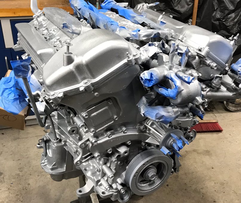

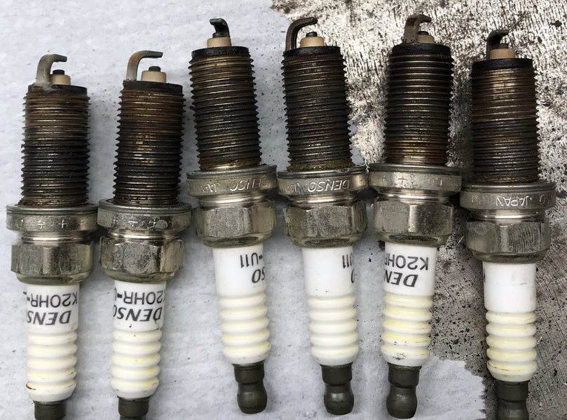

    we put new denso plugs in, they were very overdue based on the giant gaps:
    And than primed and painted the engine with VHT engine enamel paint:

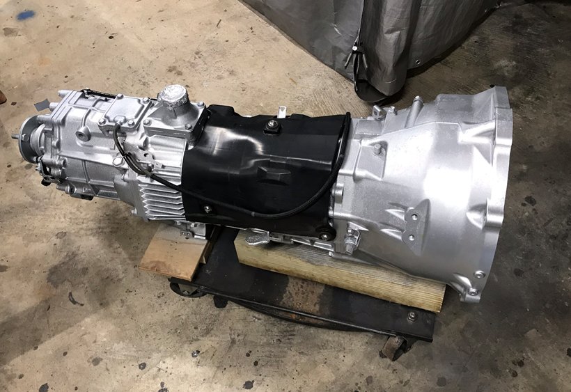

    and also got the transmission cleaned and painted:

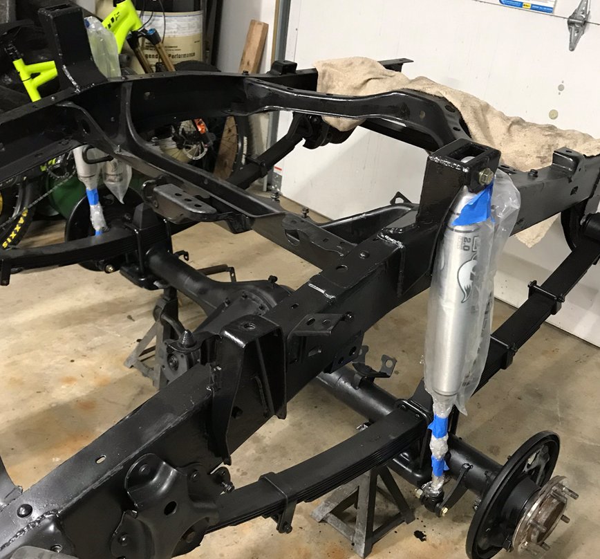

    The rear axle is back in place and we put the shocks on:
    We still have to decide what to do with the reservoirs

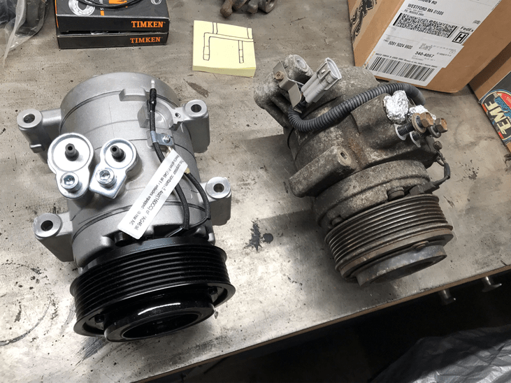

    The AC didn't work before we took everything apart so we are going to replace the compressor and the condenser. We ordered an OEM rebuild from L&S compressor on ebay for $120, but they sent a new aftermarket UAC compressor. These sell for $200 on rockauto, so I guess we made out OK.

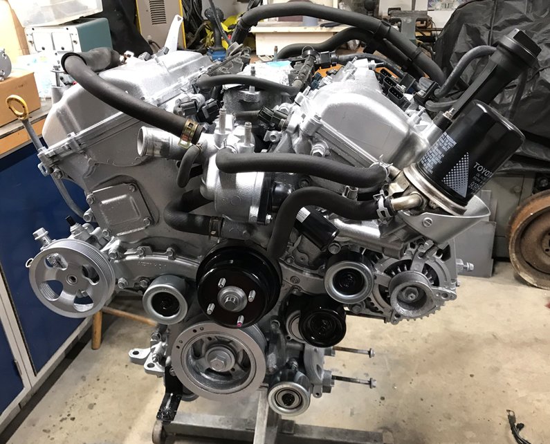

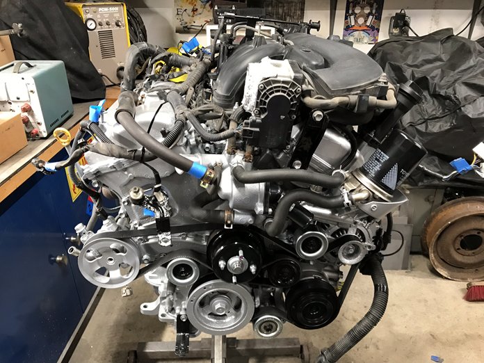

    We got the ac compressor on with a new belt amd the engine is ready to go back in:

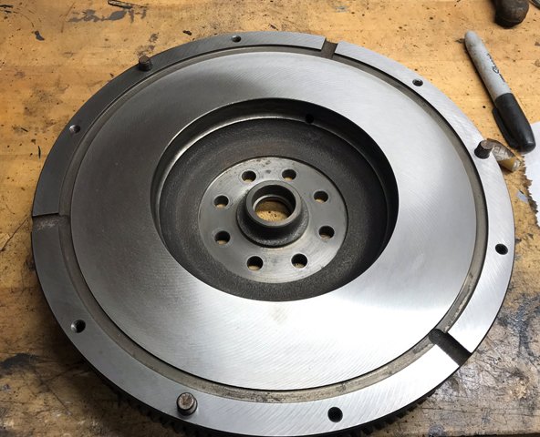

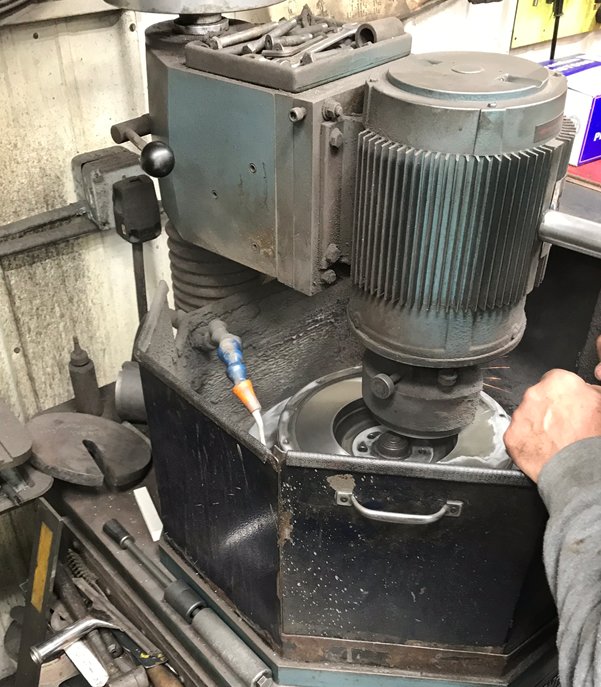

    We found a local shop to grind the flywheel ($80) and the guy let me watch the process. He pulled the pins out to grind the pressure plate surface to keep the step the right height:

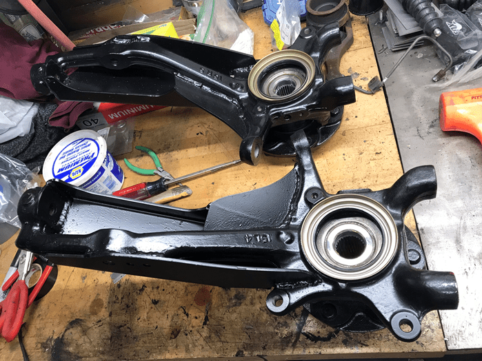

    We got the front wheel bearings installed back into the spindles with new seals. We are going without brake rotor dust shields
