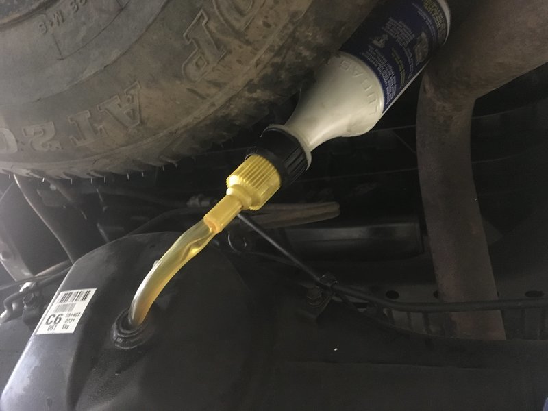

    @JD'STaco do you have a part number for the toyota LSD addative?

    Welcome! I got home And and checked my Chilton manual and as far as the gear oil goes your year is different: '05 - '011 V6 models call for above 0* F ~ API GL - 5 SAE 90w gear oil.
    Below 0* API GL 5 SAE 80w-90.
    Disregard my last post.

    The Fill and Drain Plug torque spec is 36 Ft- lbs.
