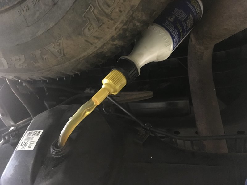

    ECGS told me to run 85-140 conventional lucas to be able to keep my warranty. They absolutely do not recommend any kind of synthetic gear oil in toyotas

    Why no synthetic in Toyota's? Also why 85w-140?

    Synthetic is not good for heavy duty gears. Its too thin.

    Thats what they said.
    When I asked, they just said that in their research this is what works best and synthetics were more prone to failures

    I went ahead and did it.
    The lucas claims to have it in it, but i added 4 oz anyway

    Their instructions say it is okay to add some.
    I wanted to since we cleaned out the entire housing and did a full overhaul

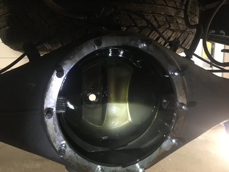

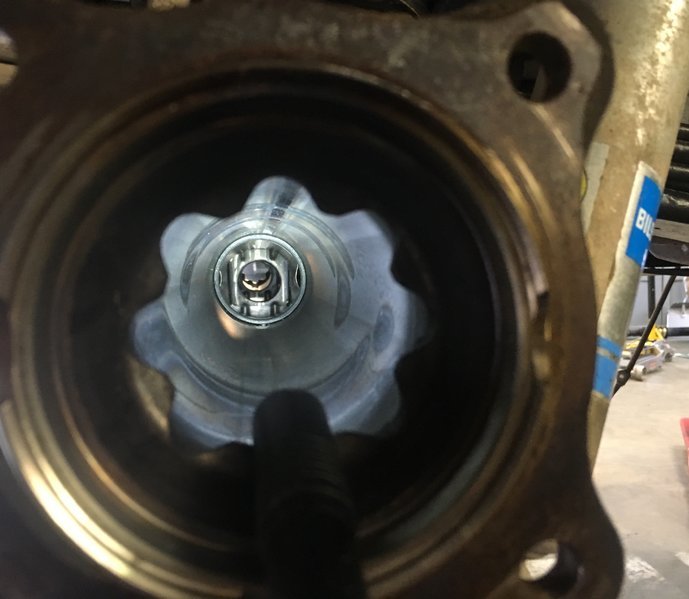

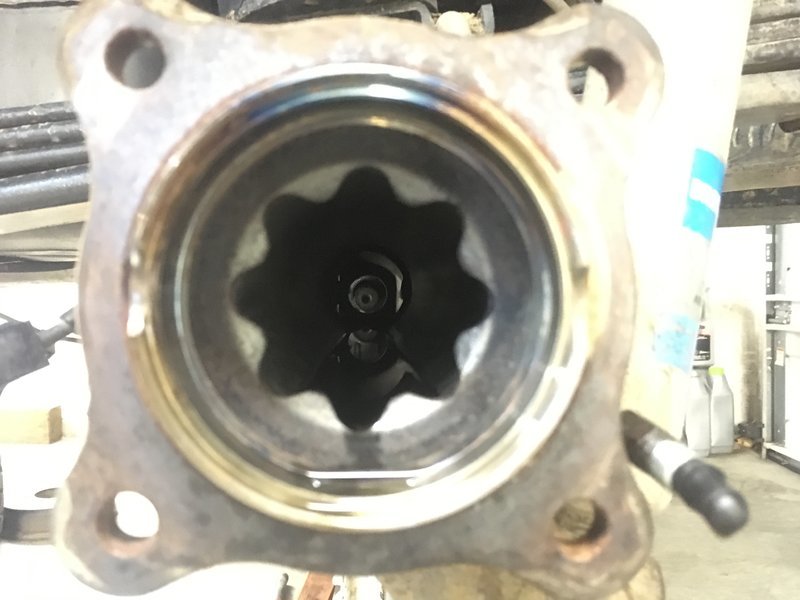

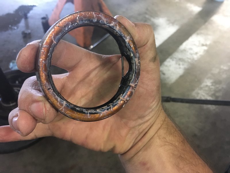

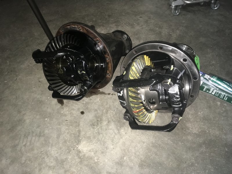

    Here is the run down:
    Truck is 100% back together.
    Jacked it up, removed the wheels and pulled the drums, drained the gear oil.
    Then took out all the brake line bolts and ebrake cable bolts. Disconnected the brake lines from the back of the drums and capped them. Then pulled the axle shafts, then the third.
    Used 6 cans of brake clean to scrub the housing and axle shafts. Greased and replaced the axle seals with new OEM, cleaned the o-rings, put RTV on the housing, then put the new OEM gasket on, then put RTV on top of the gasket. Installed the axle shafts, then the third. Hooked all the brake lines back up (arguably the worst part), put all the bolts back in. Bled the brakes, repainted my drums, anti siezed my hubs and bolted the wheels back up. She's all done.
