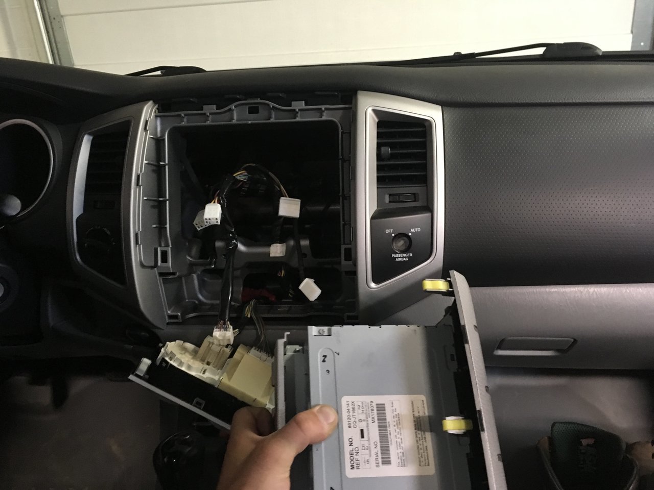

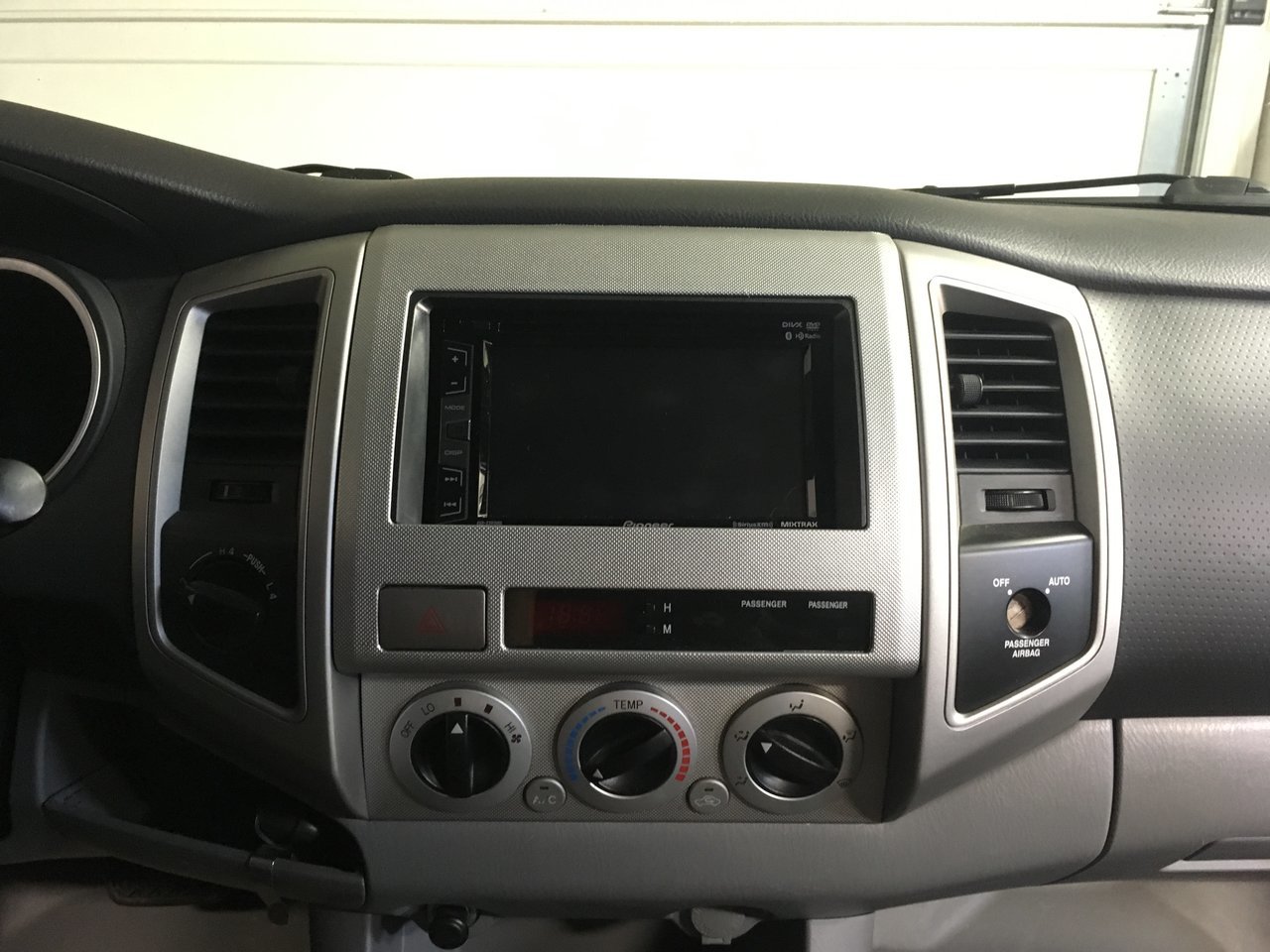

    Right now i'm attempting to build my new headunit

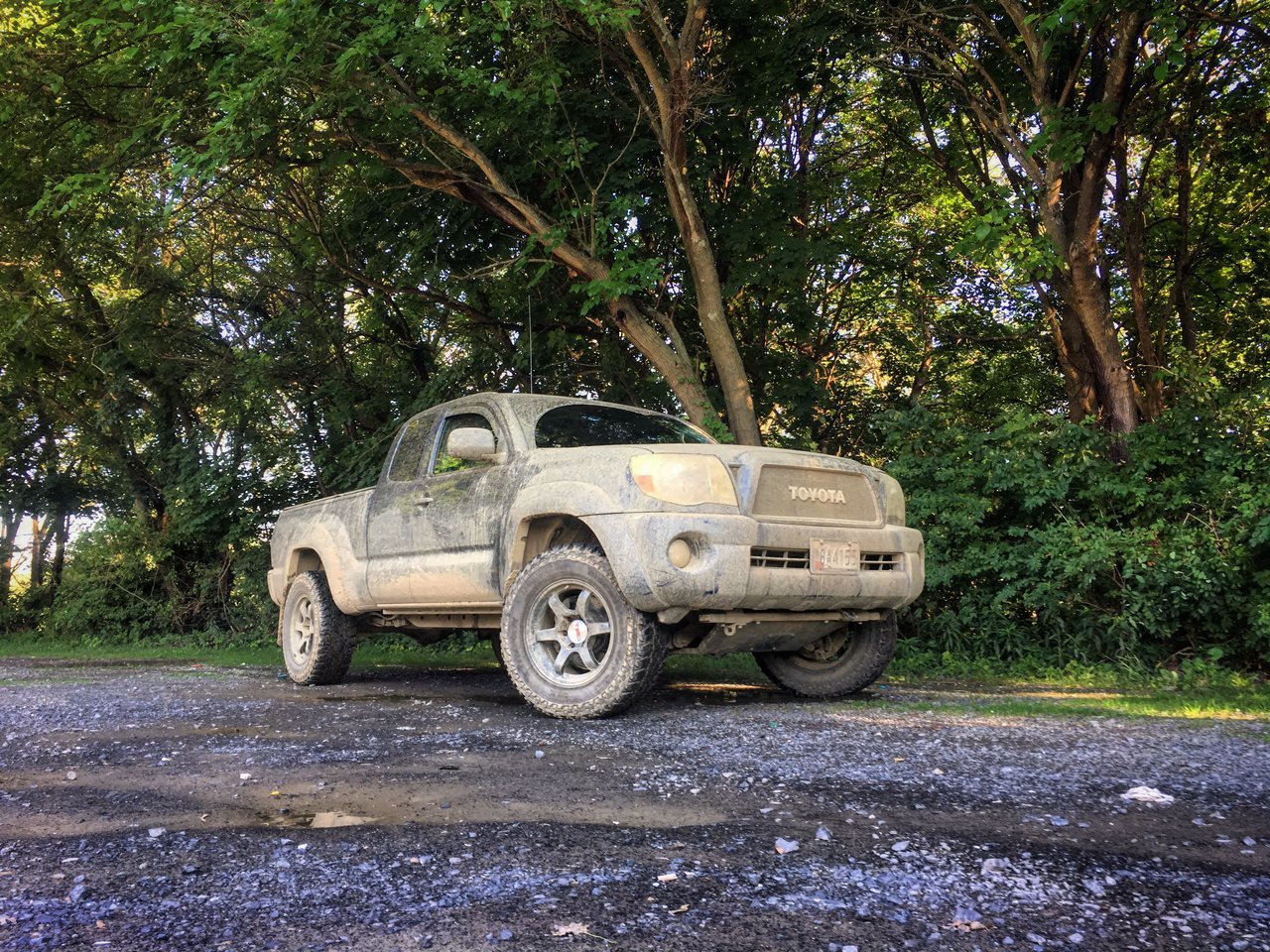

    Nice little mud bath.
