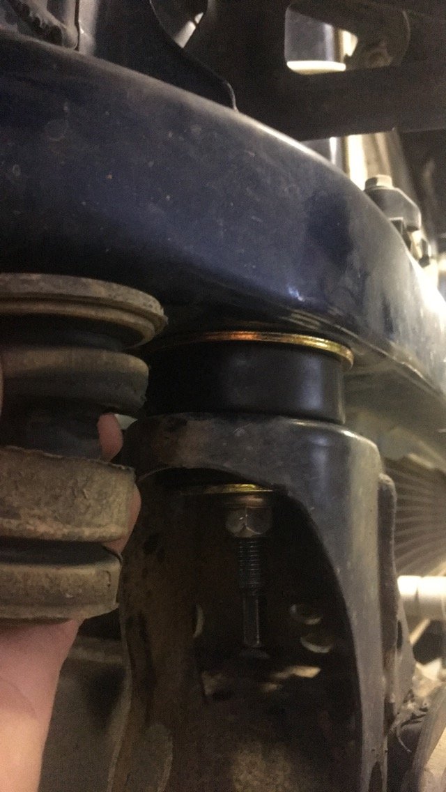

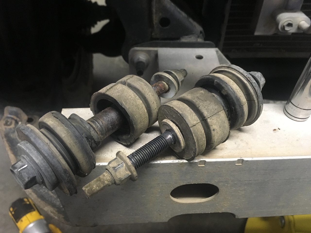

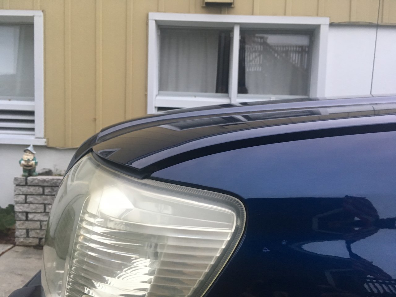

    Finally installed those Energy Suspension poly rad mounts. Couldn’t believe how destroyed the old rubber ones were. Also glad i went with new OEM bolts/nuts too. Only issue is how it pushed up my hood and grill. May need to get thinner poly or move some shit around. Everything looked great until i drove it and it all settled

    It’s fucking totaled.

    You might need to flip the bushings, IIRC if that happens they needed to be flipped

    Probably. Because all the other mounts are likely sagged as much or worse.
    But that involves tearing the grill and bumper off. AGAIN. :pout:

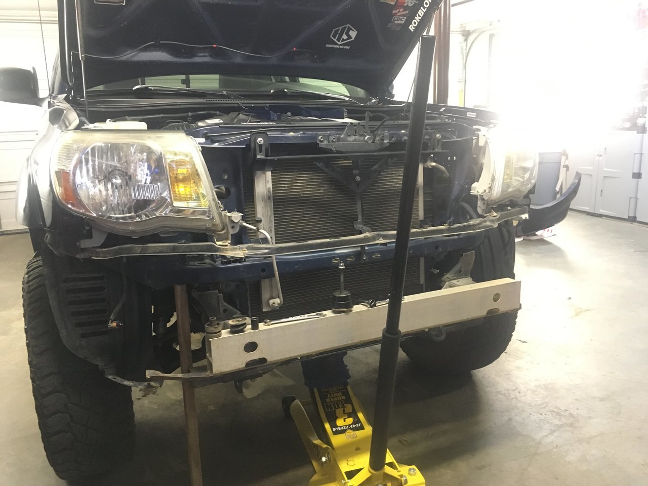

    I cussed the entire time i removed thw bumper. But no more weird hood vibrations and hard latching made it all worth it.

    After reading that thread a few times, I decided that was my best option. I didn’t want to have to pull it apart again, but I did mine when I did my @Mobtown Offroad recovery bar so added bonus. :D
