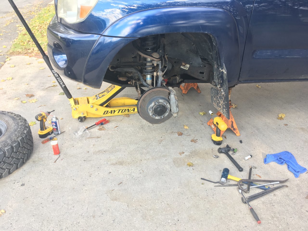

    This job fucking sucked, but its done:

    Air chisel couldn’t reach in there so i used an electric hammer drill chisel to get the old one off @EatSleepTacos

    Old one would not come off.

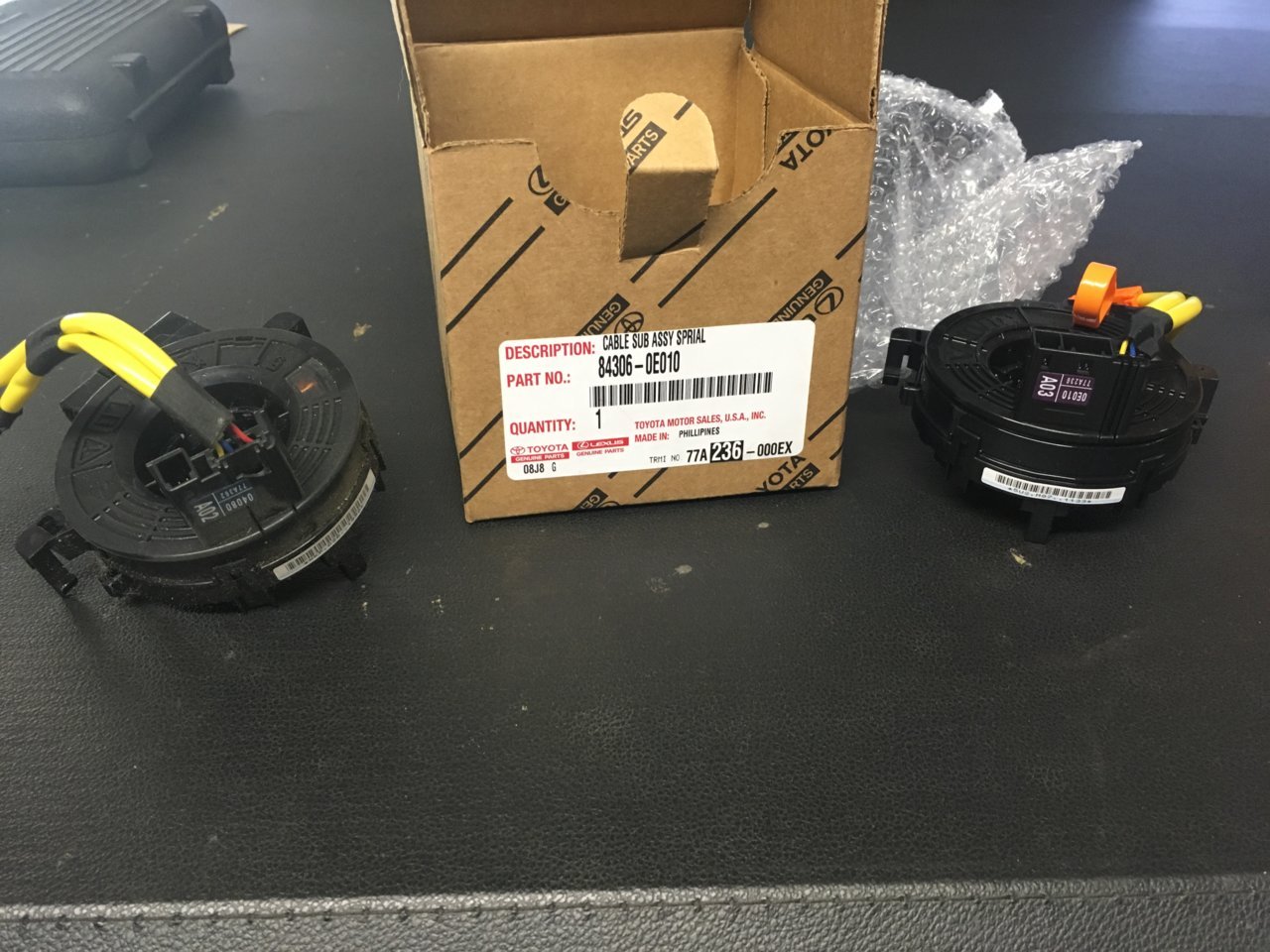

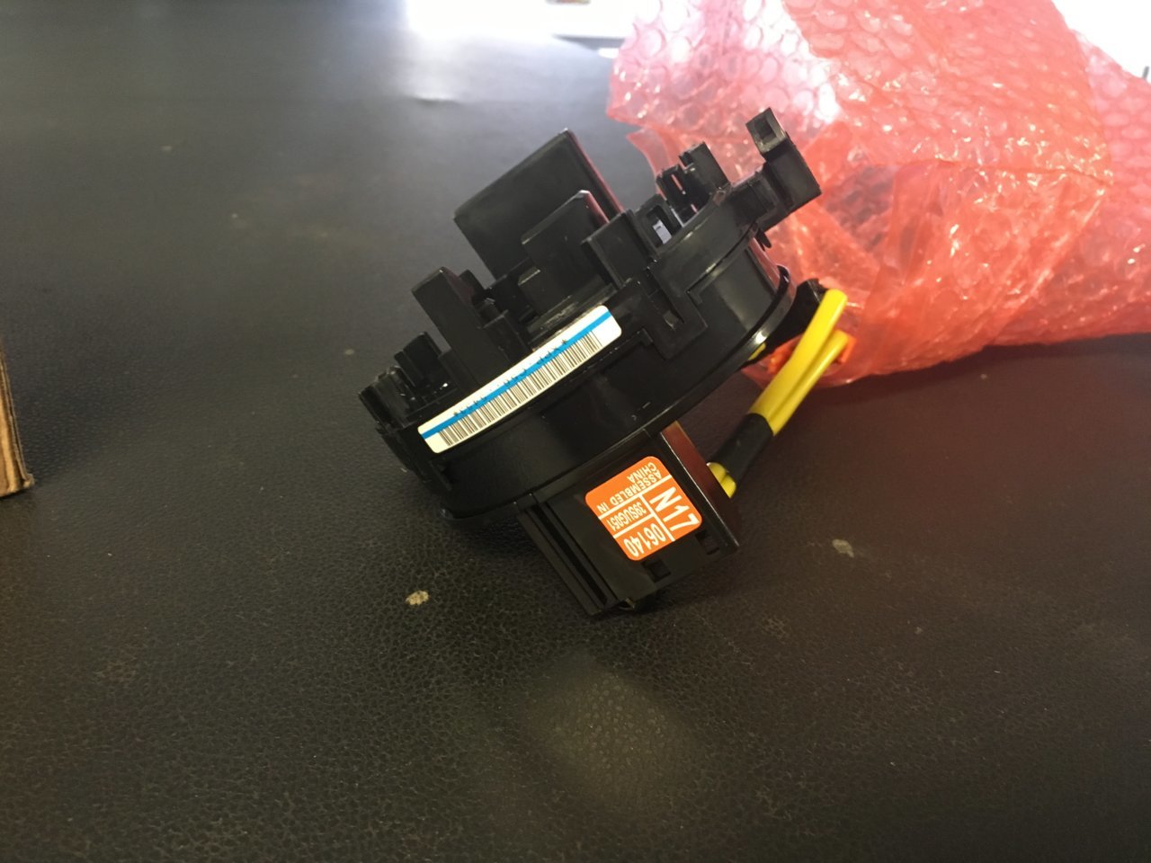

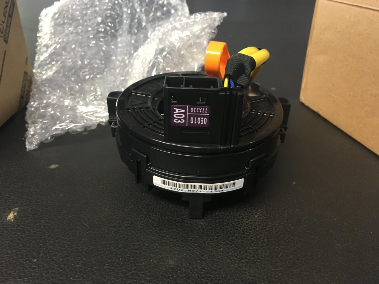

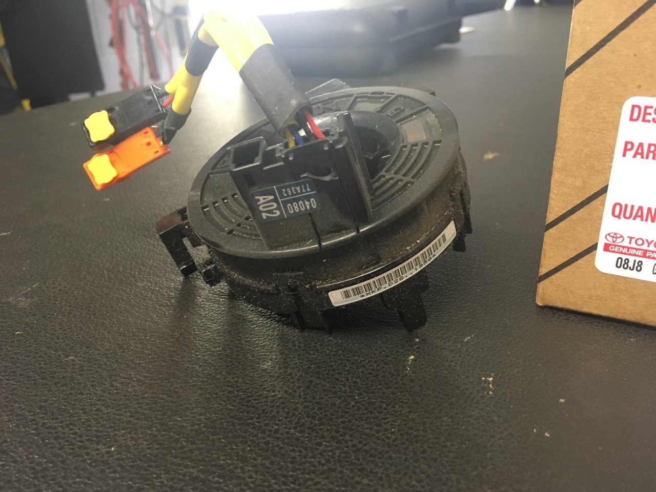

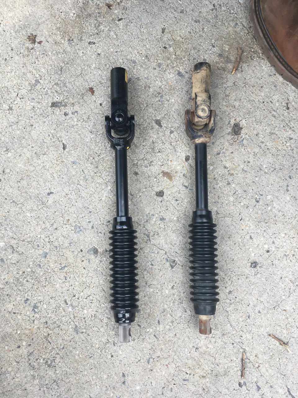

    Also did the clock spring job.
    Cruise control works. Airbag light is not on. All is well.
    Junk Chinese clockspring/spiral cable that i DID NOT USE:
    $200 OEM one that I installed today:
    Old one that i removed (no longer working):
    Tractorman and RobP62 like this.

    Both old and new together:

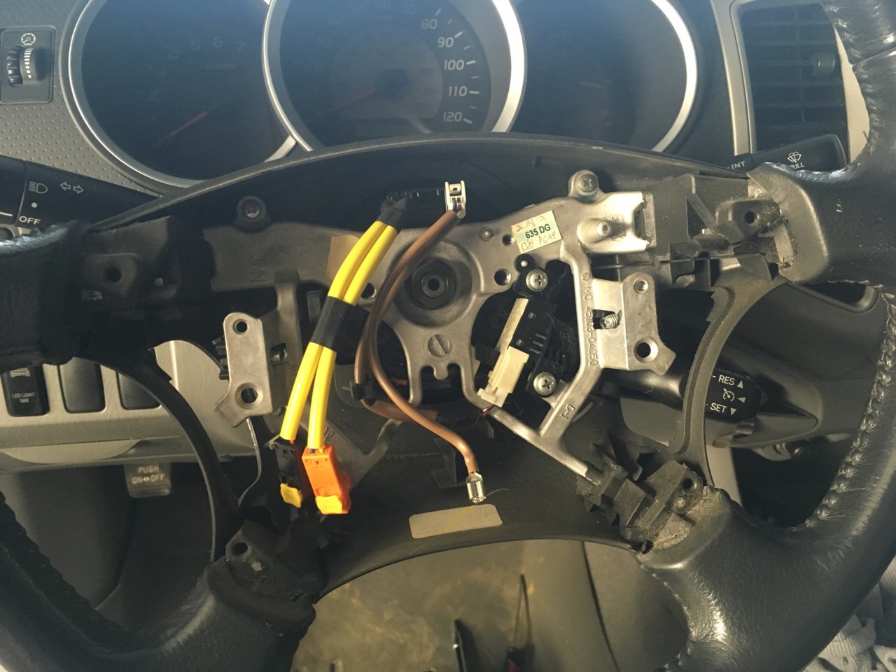

    New one installed:

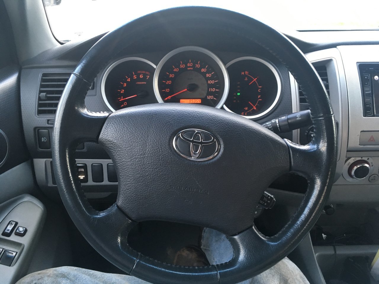

    Clock spring job went well. But the intermediate shaft job left my wheel one spline off, this is straight down the road:
