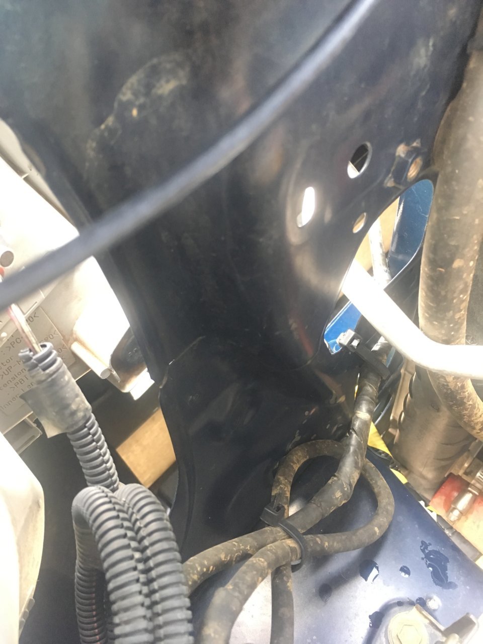

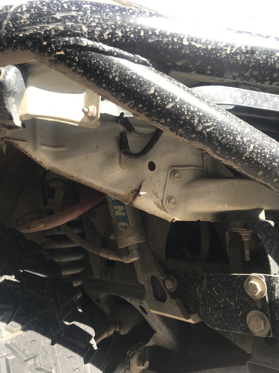

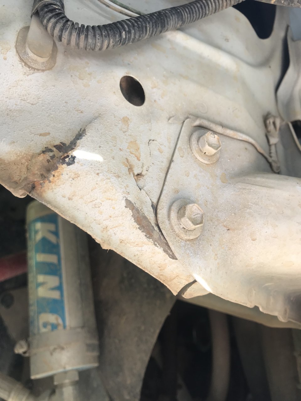

    Found a crack in my radiator support....

    I have a lot in mine. Happens when driving like an asshole over bumpy terrain. I even tried drilling a hole to stop the crack, then welding it closed. Next trip out it cracked right next to it.

    This is mine. I have poly mounts too.

    I think I may weld some thicker sheet metal on there to attempt to reinforce it. We’ll see if it works but I’m not too optimistic.

    its a known issue with tacomas. best thing i can think of is to buy a new core support, reinforce it and then install it.
