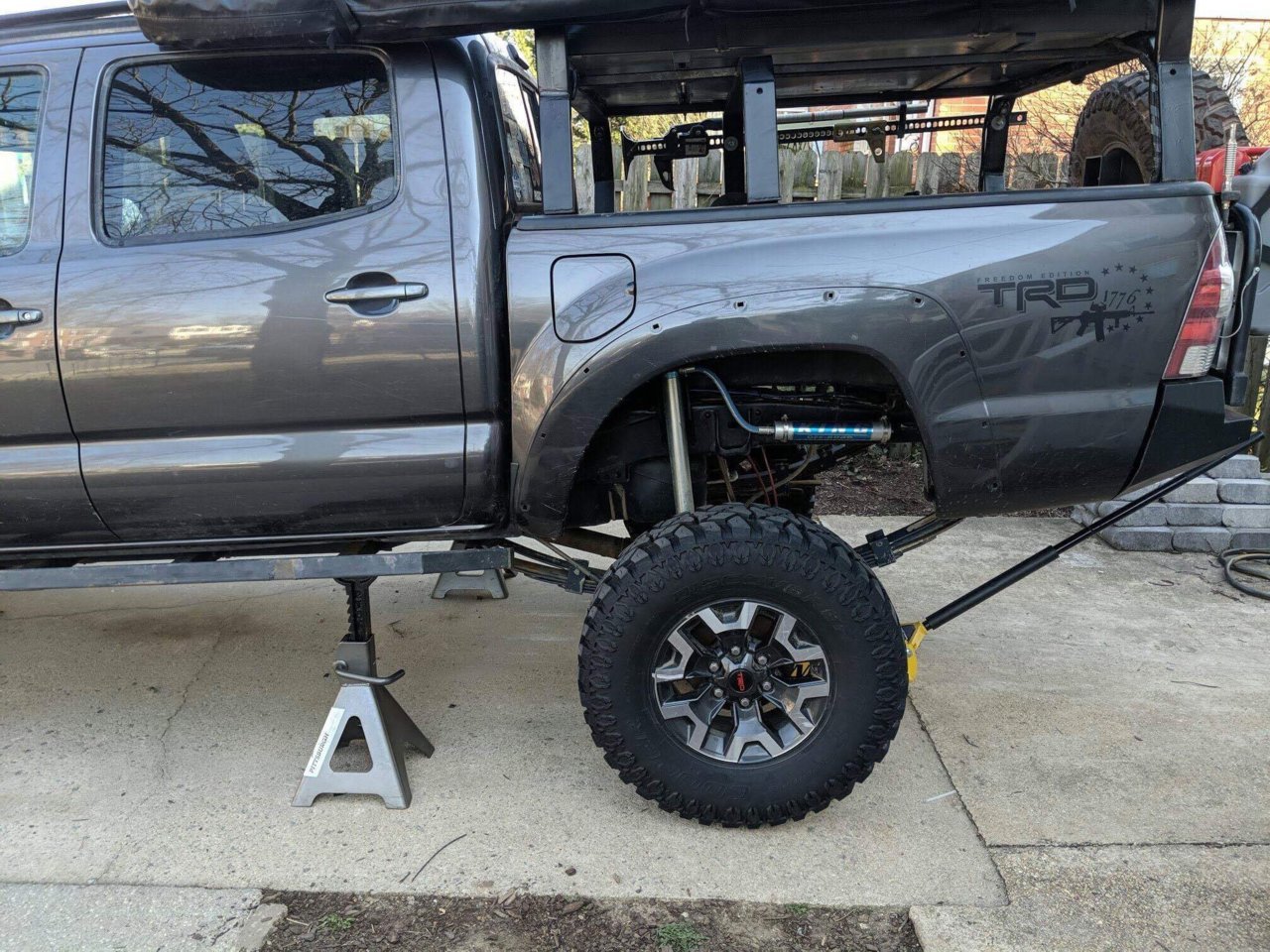

    You can kinda see mine in this pic, but this is how they’ll sit.
    AR15xAR10[QUOTED][OP] likes this.
