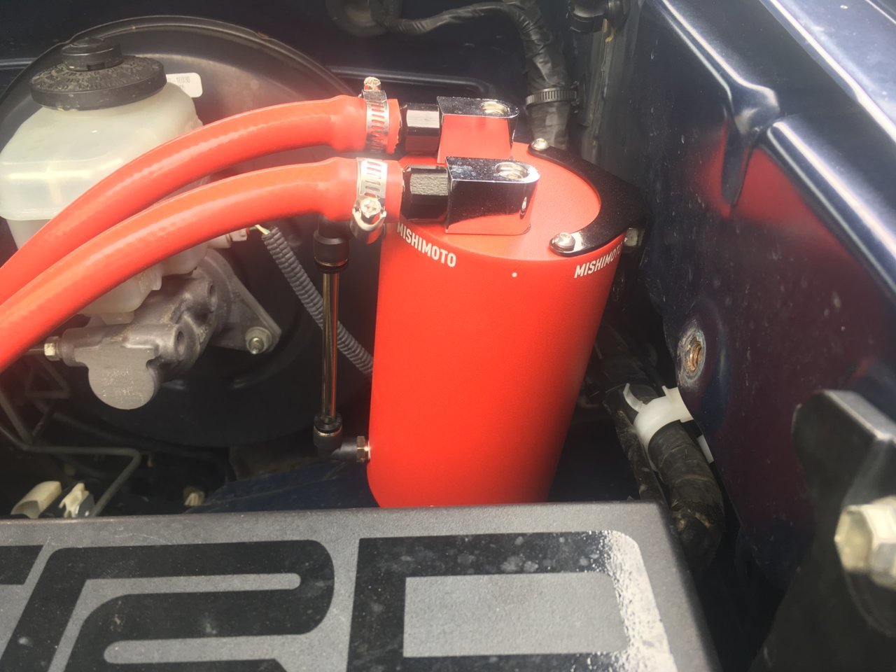

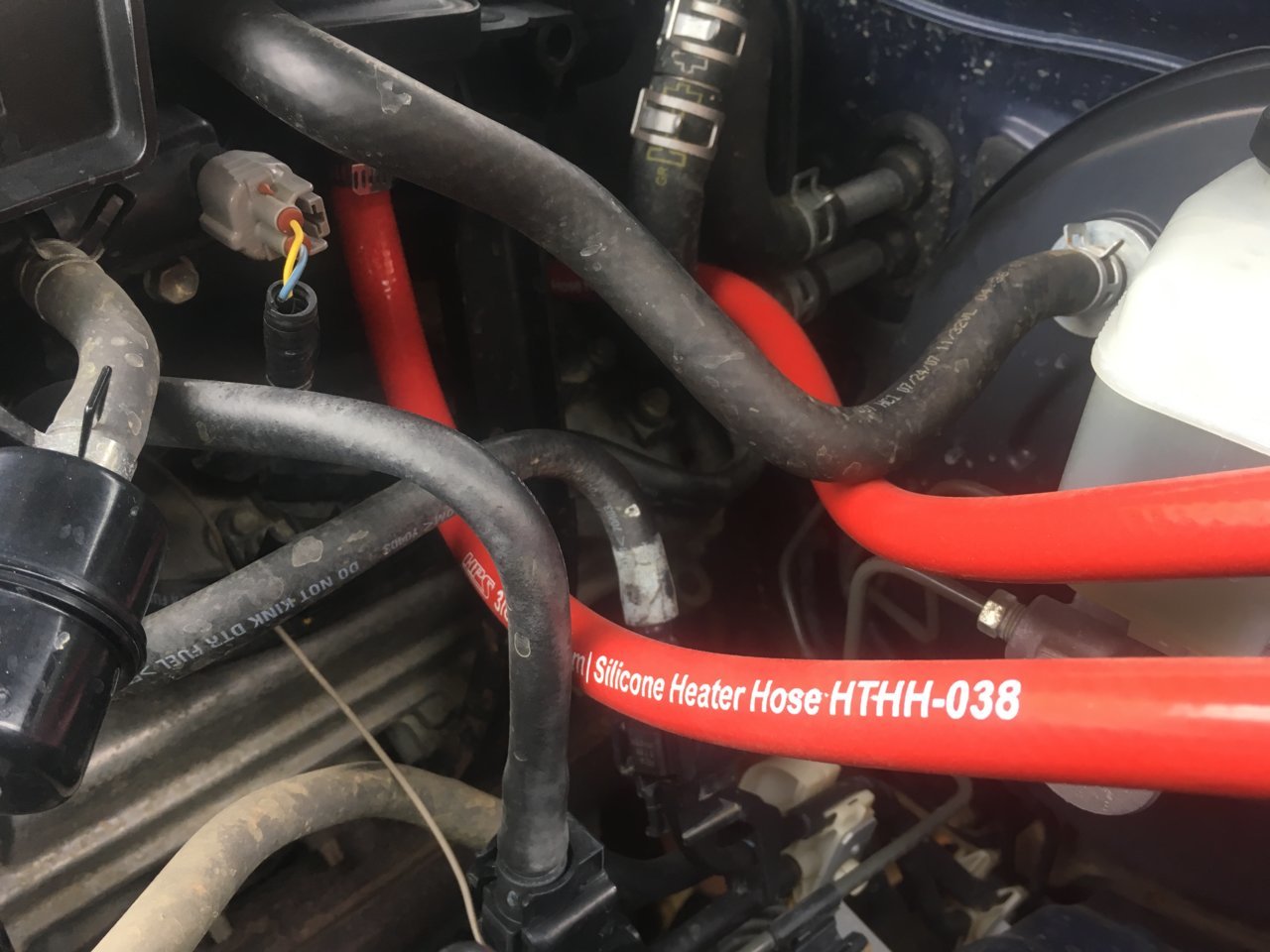

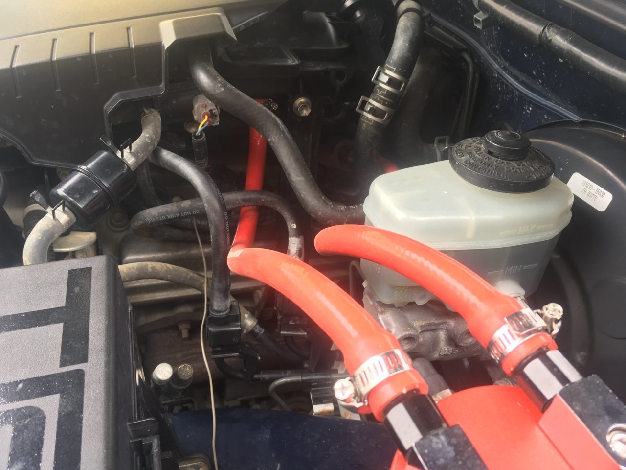

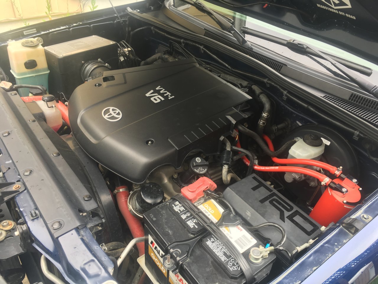

    Installed a mishimoto oil catch can this evening....

    Matthew
    Central Maryland
    i didnt know they made a catch can in that style, whered ya get it?

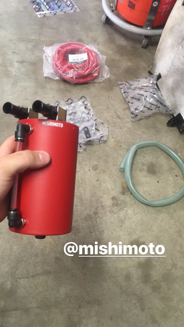

    Amazon.
    It was way too expensive for how basic it is. No way to open it and no filter on it.
    But it does have a 14mm machined aluminum drain plug and a sight glass. Its all billet aluminum with aluminum and stainless hardware.
    I just wish it unscrewed so i could add a brass filter or some stainless steel wool to help keep the oil in it. I’m going to clean my TB, MAF, Intake, and put in new plugs soon. So we shall see if it captures anything and how well it works. May upgrade to a better one eventually.
    Also, it was DUMB HARD to get 9.5mm(ID) hps silicone hoses over 12mm(OD) nipples on the mishimoto can
