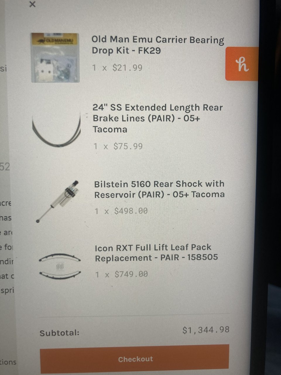

    Differential for the truck should be here and back together tomorrow evening.
    I ordered the following:
    Stoptech front stainless braided brake lines, bilstein 6112 front coilovers, new top hats, and a manual spring compressor to assemble them.
    Also, Icon RXT convertible leaf springs (adjustable from 1-2.75” of lift), bilstein 5160 external resi rear shocks, low range offroad ubolt flip kit/ubolts, and 24” extended stainless braided brake lines.
    I should have everything by Thursday 5/5

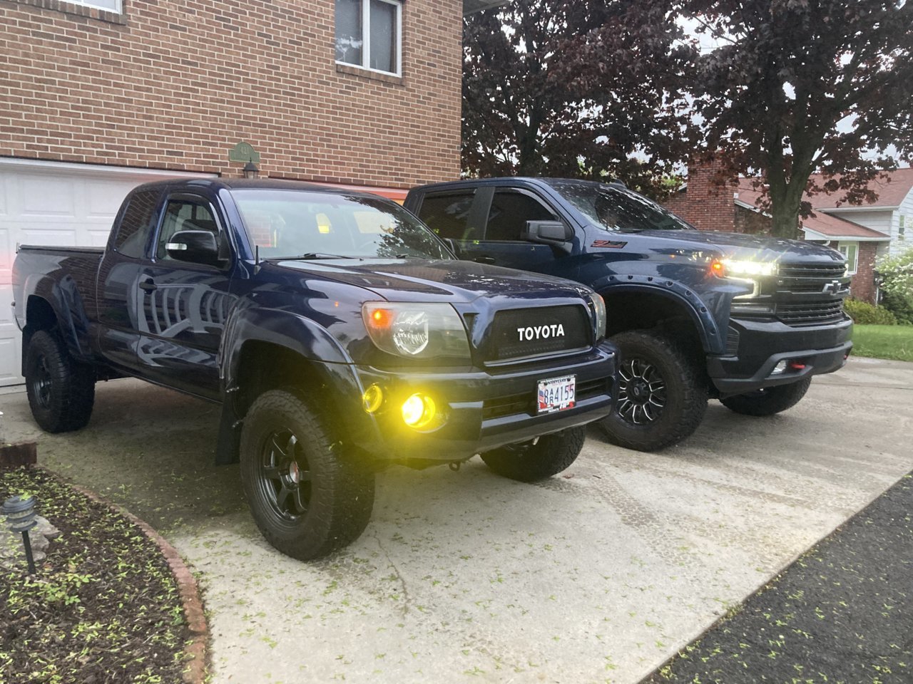

    Rear lift is done except for the extended brake lines (mine are seized :( ) and I still have to bolt up the E brake cables:
    @Pyrite_Pirate
