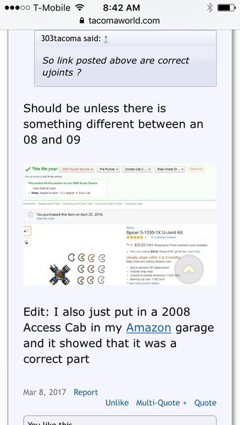

    For me it says the part number is RWD only, not 4wd

    Yea I think the front shaft takes different size ujoints. Toyota has always been about "one size fits all" so any access cab should have the same driveshaft

    Yup, I'm 4wd and used these to replace all of my rear u joints. Amazon is not always 100% on their part matching, so I had researched these more before purchase
    Edit: haven't replaced my front t-case shaft u joints, but I know they are a different part number and size. I don't have that part handy though.

    I figured that much, i have not replaced the two in front of the transfer case either.
    I wasn't sure because the summit website said they were 2wd only.

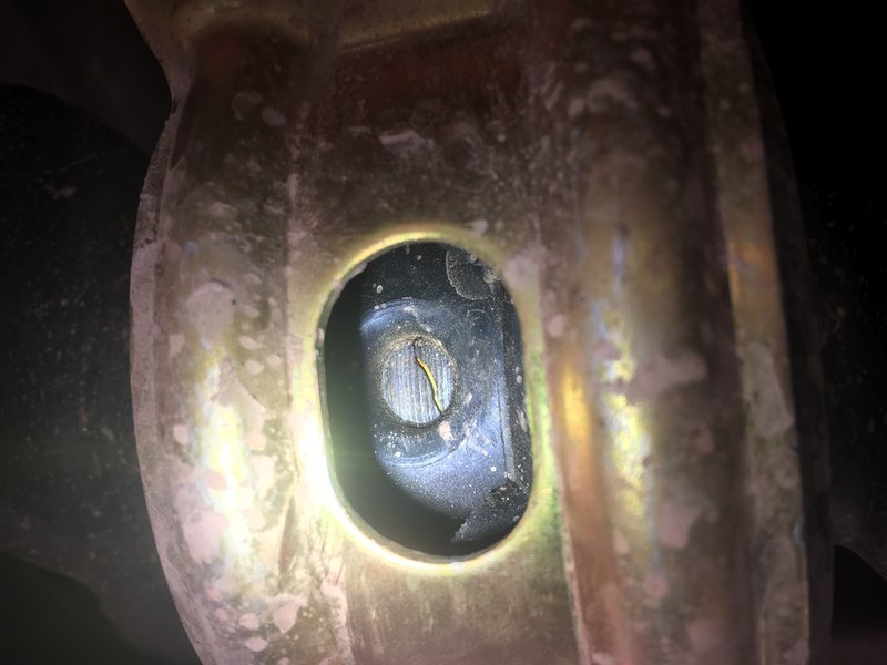

    This may be a problem.
    Carrier bearing has cracks all through the rubber already
