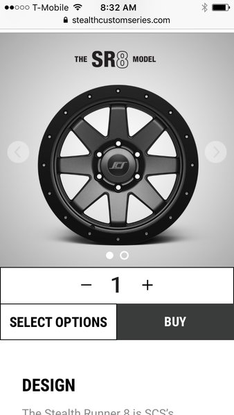

    So I remember guys were talking about sr8 rims thoughts Mason??
    I found an awesome deal
    Don't want to search this thread :D

    I do not recall.
