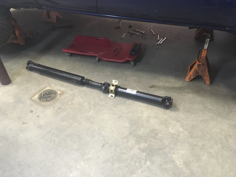

  9. Feb 27, 2017 at 2:06 PM

    No longer on the floor.
  12. Feb 27, 2017 at 7:24 PM
    #132
    AR15xAR10
    AR15xAR10 [OP] AR10 is 5 ARs better
    Apr 13, 2013
    #102024
    57,195
    2013 TRD Sport 4x4 V6 ACLBFTMFW
    Haven't driven it yet but just moving it in the driveway, the slop going into gear or reverse is gone.
    Also going to swap out the needle zerks on the new ujoints for standard zerks.
    I'll drive it all day tomorrow and tighten my bolts a couple of times.

    Slop in and out of gear is gone.
    New CB groned for about 10-12 miles and is now silent. All i can hear is tire hum.
    New Ujoints were pretty stiff even after greasing. They are just now starting to losen up nicely after about 20 miles
    I did jack the truck up and check all my bolts/nuts, one nut came loose on the Tcase side so i losened all four and put blue loctite on them. Then tightened them as far as i could with two 14mm wrenches end to end
