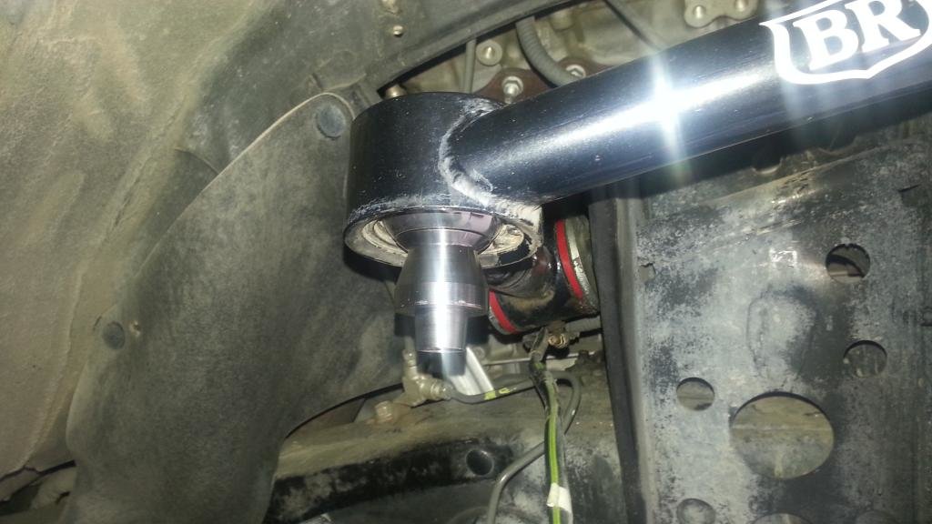

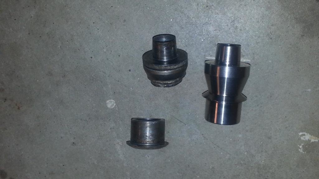

    I'd still look into limit straps. When you run out of misalignment, that bolt & misalignment spacer takes all the load.

    does anybody know the size of the bolt??

    Don't know for sure on the BR, but TC is 9/16" x 5" fine thread.

    I just checked, it's the same size.
