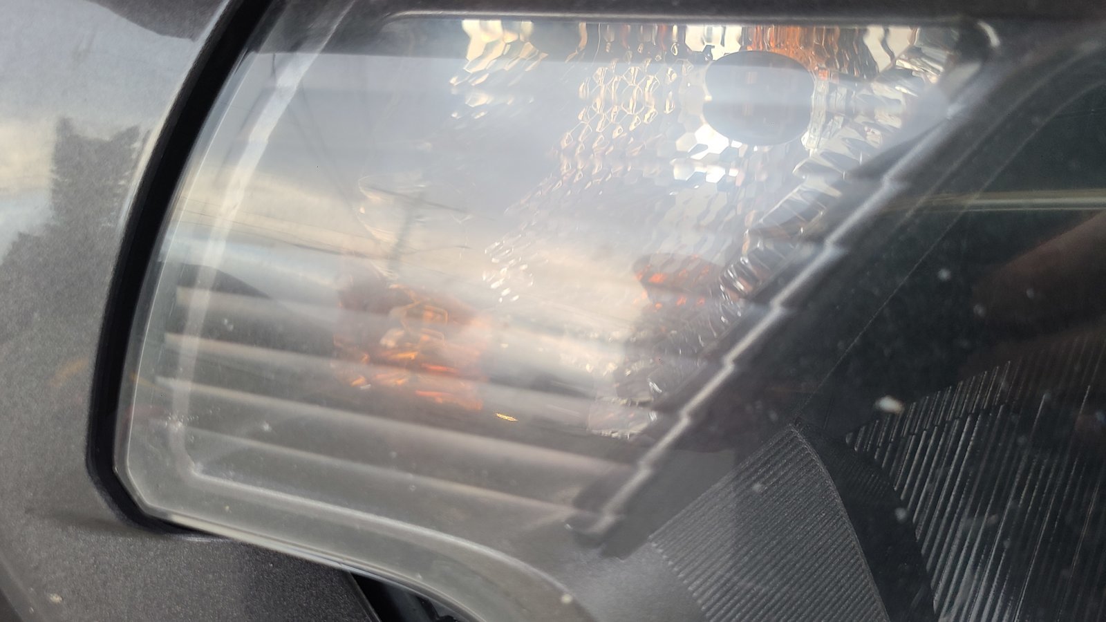

    On my way home today I noticed my left blinker was blinking fast, indicating I had a bulb out. When I stopped to look, I noticed my DRL/Blinker bulb actually fell out of its socket and into the housing. Aside from completely removing the entire headlight assembly, anyone have any ideas or suggestions on how I can extract the bulb to get it properly mounted again? 20231019_173028.jpg

    Really long tweezers or you’re going to have pull the headlight off and shake it out till it falls through the socket.

    One of those flexible mechanical fingers.

    Magnet on a stick if it's one with a metal base

    Easy. Long screwdriver or straighten out a wire hanger. Wrap the end of it with duct tape (sticky side out). It's what I do.
    Bend the metal tabs in the socket slightly so it grabs the bulb tighter.

    Yooo you're the man! I got it out with your suggestion! The duct tape I had on hand sucked with barely any stickiness, but I ended up using some electrical tape on a screw driver. I left a little tail at the end and was able to wrap it around the bulb in the housing and carefully pull it out. Worked great. I also took a small flat head and very slightly bent the tabs out to hold the light better. Thank you for your suggestion! 20231019_195749.jpg
