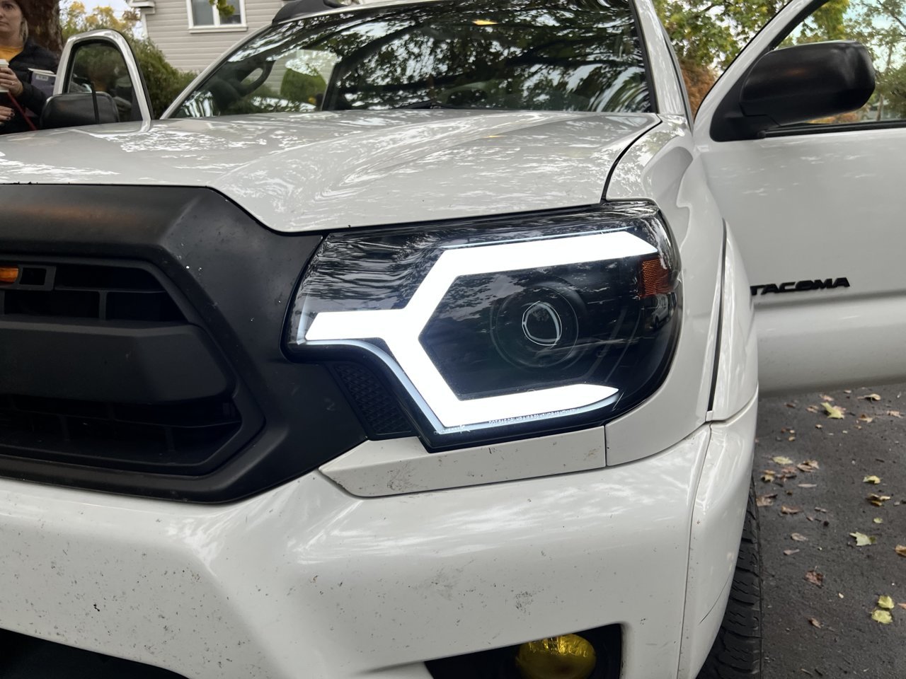

    Hey over the weekend I installed these new projector headlights and as one would imagine the stock halogen H7 bulb is not good! I’m looking for recommendations for something whiter and brighter in either a LED or HID preferably something middle tier/price?
    thanks for the recommendations!

    I hate to be the bearer of bad news, but the bulb is the least of your problems. The optics in those housings are marginal at best. Sticking brighter bulbs in there will just magnify the problem.
    I'll wait for our resident lighting expert @crashnburn80 to chime in.

    I believe these are them…they’re manufactured by Spec D but distributed by a bunch of different eBay sellers. I really like the look of these and wanted something different then the normal “C” led lights you see everywhere. The sequential amber goes into effect when the turn signal is activated or when you turn on your hazards.

    It isn’t the bulbs that is not good, is is the optics of the assembly. Spec-D/Spyder is known for pretty awful headlights that are a huge step down from stock. They use cheap garbage projectors and are sold primarily based on cosmetics, not function. You can’t fix a bad headlight with a good bulb, because a performance bulb will rely on precision focused optics in order to magnify the performance, something OEM has but most all aftermarket is lacking. LEDs actually just make it worse, not better. Since the optics are designed for a halogen and an LED doesn’t replicate a halogen (despite what a vendor will try to tell you) it further reduces the focus in an assembly that already has serious focus issues. People like to look at the projector cut off and think it works great, but there is a lot more to it than that. Any light source in a projector will have a cut off. With an LED you’ll end up with a puddle of light immediately in front of the truck and no distance projection. Most have to resort to HIDs to get any usable output from Spec-D assemblies. But halogen projectors are not made for HIDs, they are designed to place halogen levels of light above the cut off, and HIDs produce significantly more light turning what should be mild uplight into significant glare to other drivers.
    The best option would be to remove those and reinstall the high performance OEM assemblies which have outstanding performance, far better than 3rd Gen. Then follow the 2nd Gen lighting upgrade thread for further performance upgrades, with either stock wattage performance bulbs, or the high power bulb option.
    https://www.tacomaworld.com/threads/the-ultimate-headlight-upgrade-h4-not-led-or-hid.398066/
    If you must keep the assemblies despite the significant loss in performance, you might consider the Osram Superbright 80w H7. It will throw more power and output at the problem, but it can’t fix the bad optics causing lack of focus and the resulting lack of output intensity.

    Unfortunately those extreme performance bulbs are no longer made and sold out world wide. The next best is the Osram Superbrights 100/90w:
    https://www.bulbamerica.com/product...W7rA8azXrxcHmqQ23IX1_TR9T5vzFPf0aAgfvEALw_wcB
    Or if you don’t mind paying an obscene price the IPF Fatboys have a slightly better low beam, but factory stock beam.

    Best assemblies will be good condition OEM units. Best bulb depends a bit. The IPF Fatboys outperform the Osram 100/90w SuperBrights by just over 3% in low beam intensity which is relatively negligable and cost $80-$100/pr vs the Osrams that cost $12-20. But while the Fatboys have a stock wattage high beam, the Osrams have a 100w extremely powerful high beam. Because of the power required by the Osrams, they will require an HD relayed headlight harness, which reduces voltage drop (increasing voltage) to the bulbs, boosting their output above what is shown in the chart below. All halogen bulbs benefit from increased voltage, but the high wattage bulbs require the harness as they will not get sufficient voltage to perform otherwise, and the extreme power draw may melt the OEM connectors on high beam (the harness uses ceramic connectors).
    Headlight services HD harness:
    http://www.headlightservices.com/Wiring.html
    You can then take the performance up another 2 notches by boosting system voltage with a voltage booster when running an AGM battery. An AGM is required to run a voltage booster.
    https://www.tacomaworld.com/threads/the-northstar-agm-battery-voltage-booster-upgrade.604478/
    Running the harness plus voltage booster is good for roughly a 22% output upgrade over the stock voltage numbers below. I've never been in a vehicle with better headlights than my modified 2nd Gen. Even people that were not gearheads would be shocked when riding in my truck when I clicked on the low beams (though I was running the Hypers). But to put it all in perspective, those Spec-D lights are probably somewhere ballpark around half the stock output intensity on the far left side of the chart.
