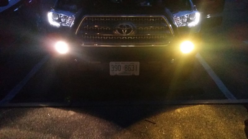

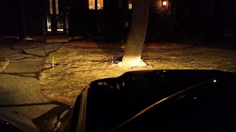

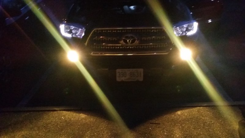

    For snow mostly went with piaa yellow fogs. Dont use them often, figure they are annoyingly bright in reflectors but they will certainly serve a purpose20160301_180136.jpg20160301_180457.jpg 20160301_180536.jpg

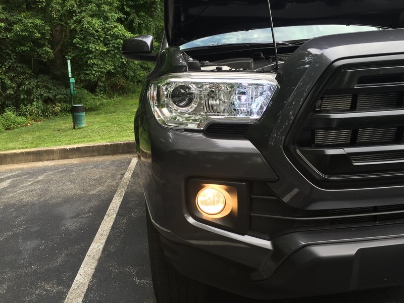

    Installed my H11 LED lights today. These do not fit in the low beam headlights, they're too deep. They do fit the fog lights. Any reason not to use an H11 in place of the H9 high beam? Bulb fits like a glove. Anyway, here are pictures with my LED DRL and fog light bulbs installed. Drivers side is LED, passenger side is stock.
