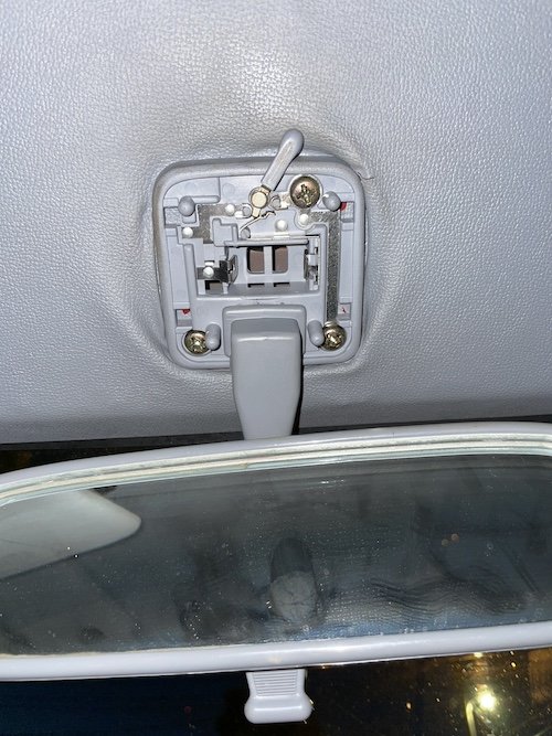

    I feel a bit silly, but I haven't been able to find the bulb spec for the map light on a truck I recently inherited. The truck came without a bulb, so I can't do the obvious thing and read it or bring it to the store. I haven't found anything so far on this forum, although I wouldn't be surprised if I overlooked it, since I'm new to this space.
    The truck is a 1997 Toyota Tacoma 4WD (4 Cylinders M 2.7L MFI DOHC 164 CID)
    The map light looks like this:
    The truck is pretty basic, and this is the only interior light. As far as I can tell, it's referred to as a map light.
    Any thoughts? Bonus points if you can direct me to an LED replacement. Thank in advance!

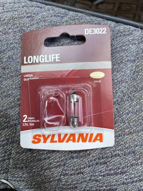

    Thanks for the tip! I found some time yesterday to do some more searching. The nice folks at O'Reilly let me test a few different bulbs until I found the right one. It turns out the incandescent bulb is a DE3022, and it's listed as a dome light, not a map light.
