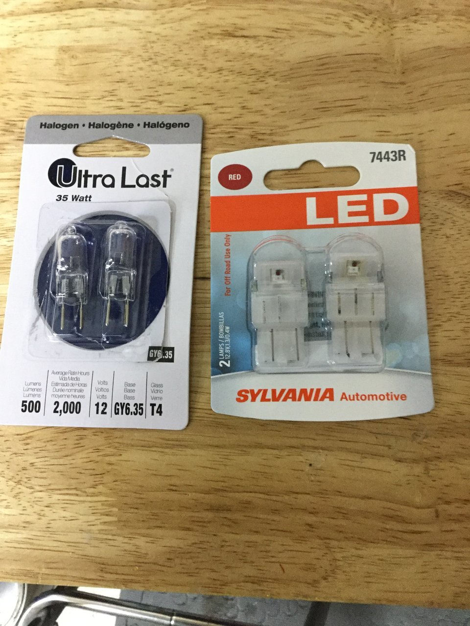

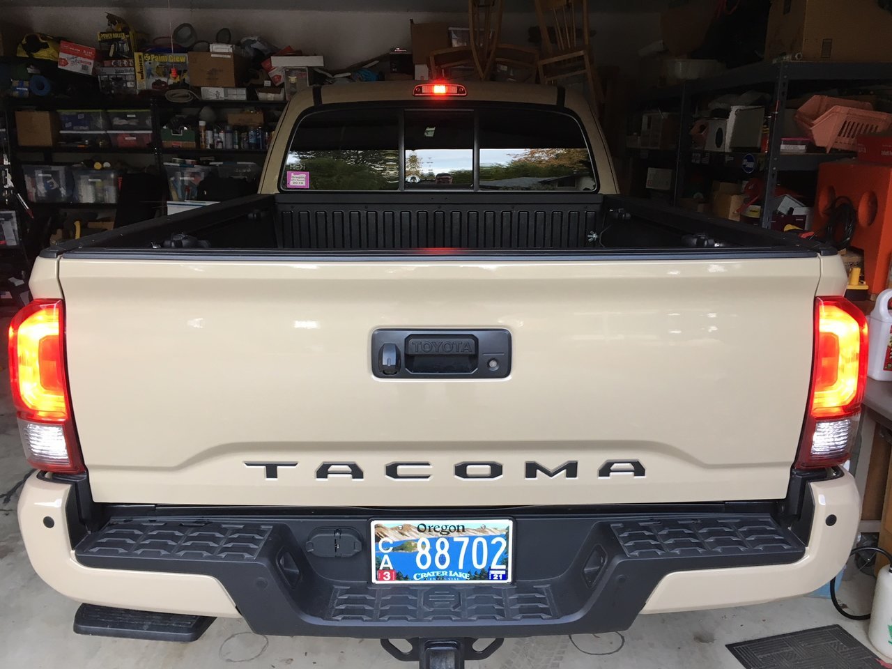

    7EC83FE6-22B9-411A-BAA4-8BBF70599774.jpg I used the Sylvania LED’s pictured on the right, also had to add a 6 ohm 50 watt resistor to prevent hyper flash. I also did the Tail as Turn mod from Diode Dynamics to make both top and bottom act as brake or turn signals.AFBE2614-B08A-4B90-9A57-2983773E6750.jpg

    Did you use the 30 dollar do it yourself kit or the 4runner kit they also have?
  7. Dec 31, 2017 at 3:42 PM
    Captqc
    Captqc Well-Known Member
    Mar 5, 2017
    #212458
    5,175
    Tigard, OR
    2017 Tacoma 4x4 TRD AC Off Road
    Yup, the $30 DIY kit, I also sealed the holes in the boxes with silicone sealer to protect the circuit board and to stiffen the wires as they can break at the solder joints if you handle them too much.
