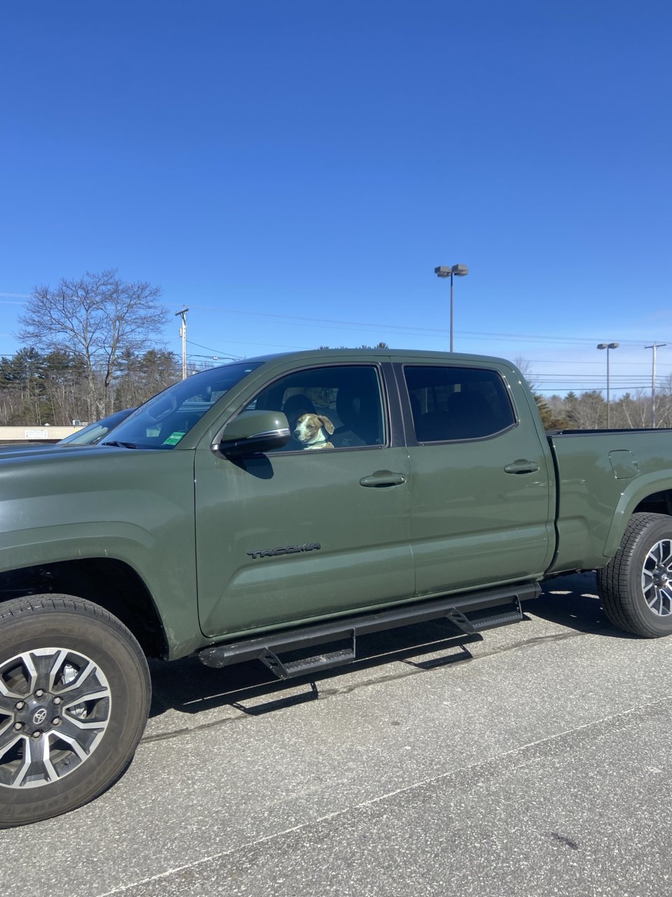

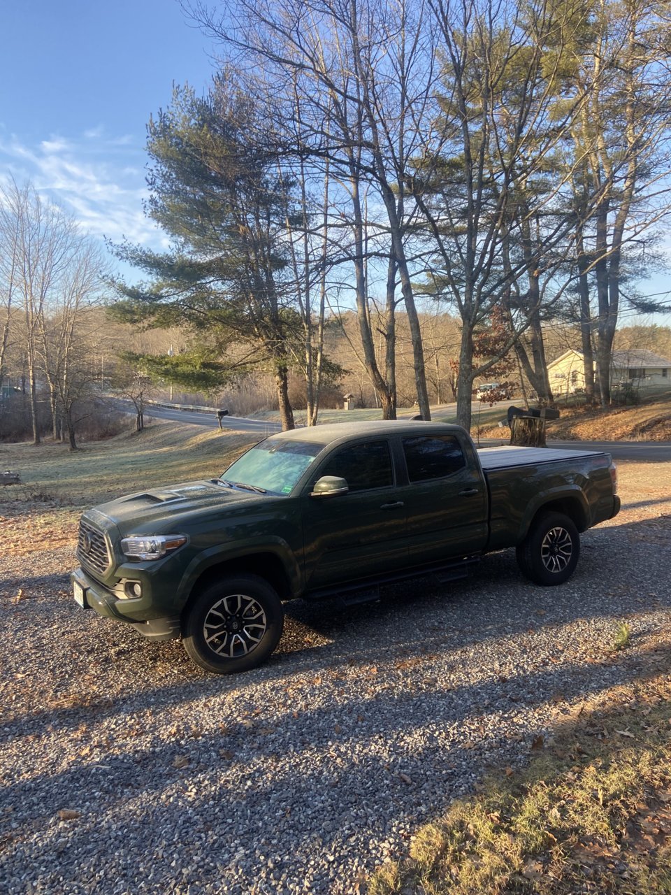

    Hi there! Thinking about my next project and considering adding a brush guard or bull bar to my 22 TRD sport, preferably one in matte black. Anyone have one they really like that they’d recommend?
    Any other mods that folks think would pair well with my truck currently? It’s been tinted, the badges are blacked out, I’ve added predator side steps, tonneau cover, bed lights, bed mat, and seat covers so far. Thanks much!

    Amazon dog poo bed mat mod
    cute dog!

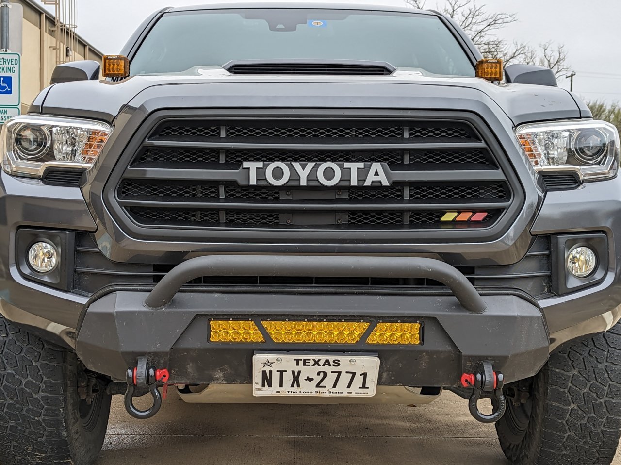

    So it's all about how you are using the truck and what sacrifices you are willing to live with. I think I've mentioned this in another thread, but the absolute safest bumper is going to be the plastic bumper that's already on there.
    I installed a lo-pro because I was tired of spray painting the damage out of my plastic valence after every camping trip. The metal bumper is good for running down brush and branches at low speed, and because it's directly in line with the frame, it's good for pulling. In a high speed collision however, I know that my frame is no longer protected but the aluminum and plastic crumple bars that it replaced. Also my airbag sensors are not designed for the different configuration. They'll probably work, but it's not a guarantee. Still, it was worth it for me.
    Most brush guards connect in the same manner as a bull bar- they tend to wrap around the contours of the bumper (instead of bolting straight through), making a j-shaped lever onto your frame mounts. If it hits something even at a low speed, it's tweaking things it shouldn't. They are ornamental only, whereas a bumper replacement at least can be used to push/pull things.
    They do make full bumpers with grille and headlight guards. If you want beefy, I would do that over a no-drill brush guard.
