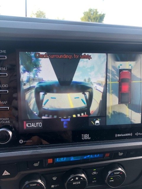

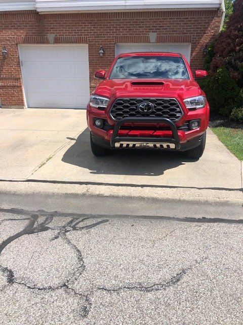

    I just installed a Westin Ultimate Bull Bar. It partially obscus the front camera.

    Doesn't seem to affect the adaptive cruise control, just the front camera. I think the camera is mainly for parking assistance. Wish I had been made aware of this before purchase, but the manufacturer surely doesn't want to scare away customers.

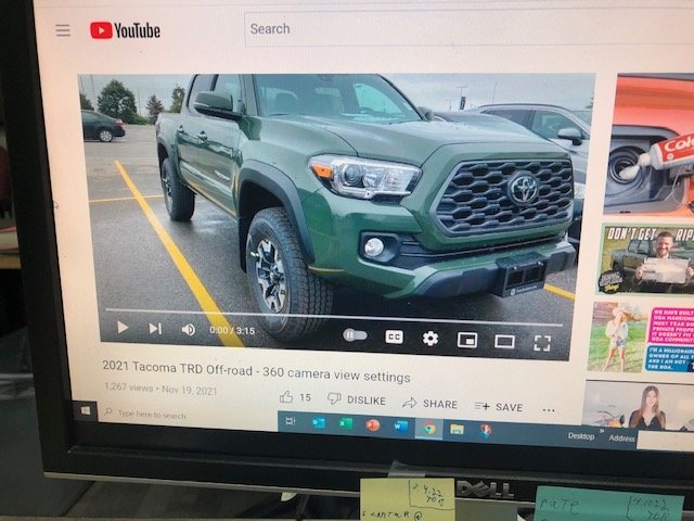

    Adaptive Cruise Control---radar sensor in grille. There is a secret handshake to use it as traditional CC. I think it's something like: push in to turn on, push again to turn off, push and hold for traditional CC. I've never tried it, but I read that somewhere. Look on You Tube for a secret handshake to change the color of the truck in the "bird's eye" view on the monitor. Something like push and hold: audio? button, turn headlamps on and off four times. It should give you a choice of truck colors. Not sure why Toyota doesn't show off these features.

    MyWestin Ultimate Bull Bar partially obscures the front camera, but the radar sensor works normally. I saw the "secret" features on YT videos. The picture is the video to change the truck color on the 360 display.I don't remember where I read about the cruise control thing.
