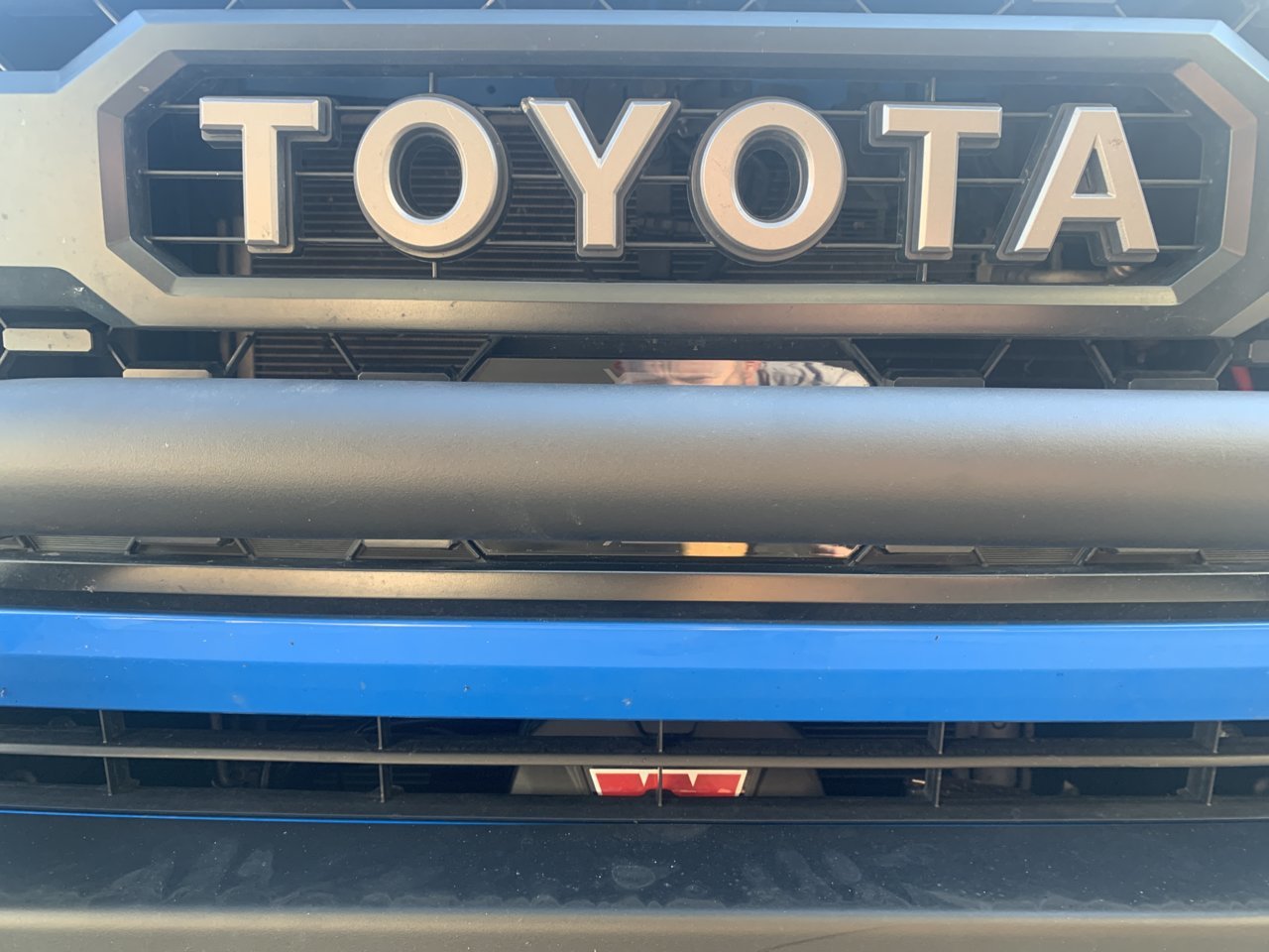

    Had a Warn semi hidden bumper with bull bar installed on 2019 TRD Pro. After install my pre collision sensor keeps going on and off. I’m assuming it’s the bull bar. I checked for loose connections. Feeling like an idiot because I didn’t think about that darn sensor. Unfortunately the folks that recommended and installed that bumper didn’t either.
    Anyone have similar issues? Any solutions?

    You have a picture? My bull bar did not interfere with the radar, but everyone is different

    Wow, it’s simply covering the entire sensor.
    Not sure why they wouldn’t notice.
