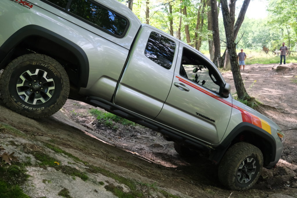

    Who's talking high speed? At slow speed (5mph?), the OP's bull bar will fold right into the grille.
    Mall crawlin':

    Hey, that's me standing in the background.

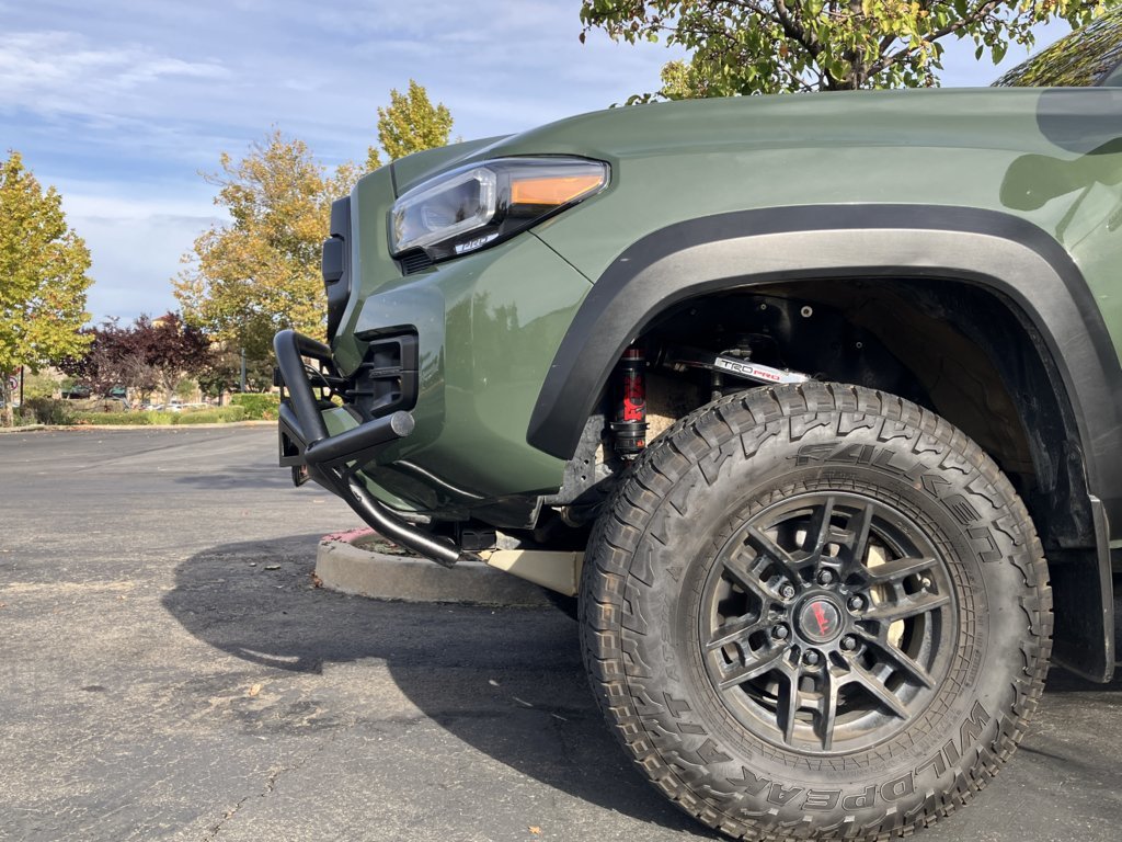

    I went with the Avid Offroad front bumper guard because it actually has a pretty minimal impact on front approach angle the way it's designed, it's proper tube steel other than the mount plates which are a thick right angle piece, and properly mounts to the same bumper points as a full plate bumper rather than the weaker radiator subframe section the cheap bullbars mount too. I skipped powder coat option and just bedlinered the whole piece to make touching up scrapes from parking lot or tapping thing off pavement easy.

    I like those bars, looks good on your truck. Army green for the win!
