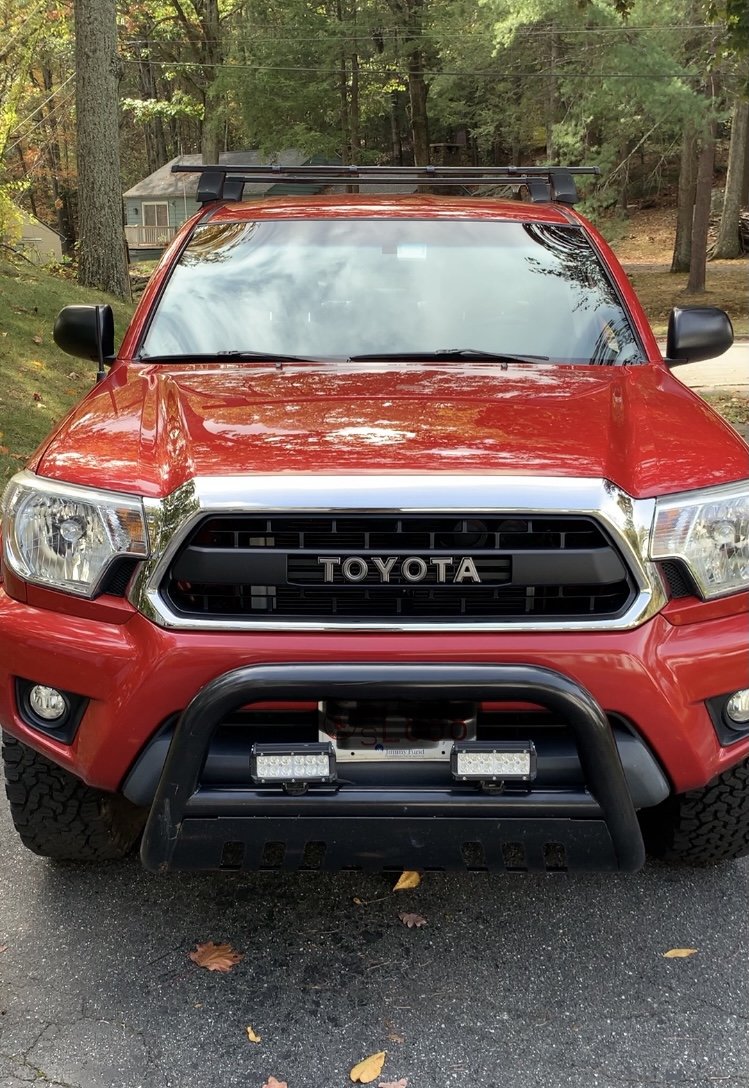

    Bought this a week ago and it came with an LED Bull Bar. While I would not have paid to install it, I LOVE the lights at night, and the look of it is IMO appealing. I have received many compliments on it in just a week.

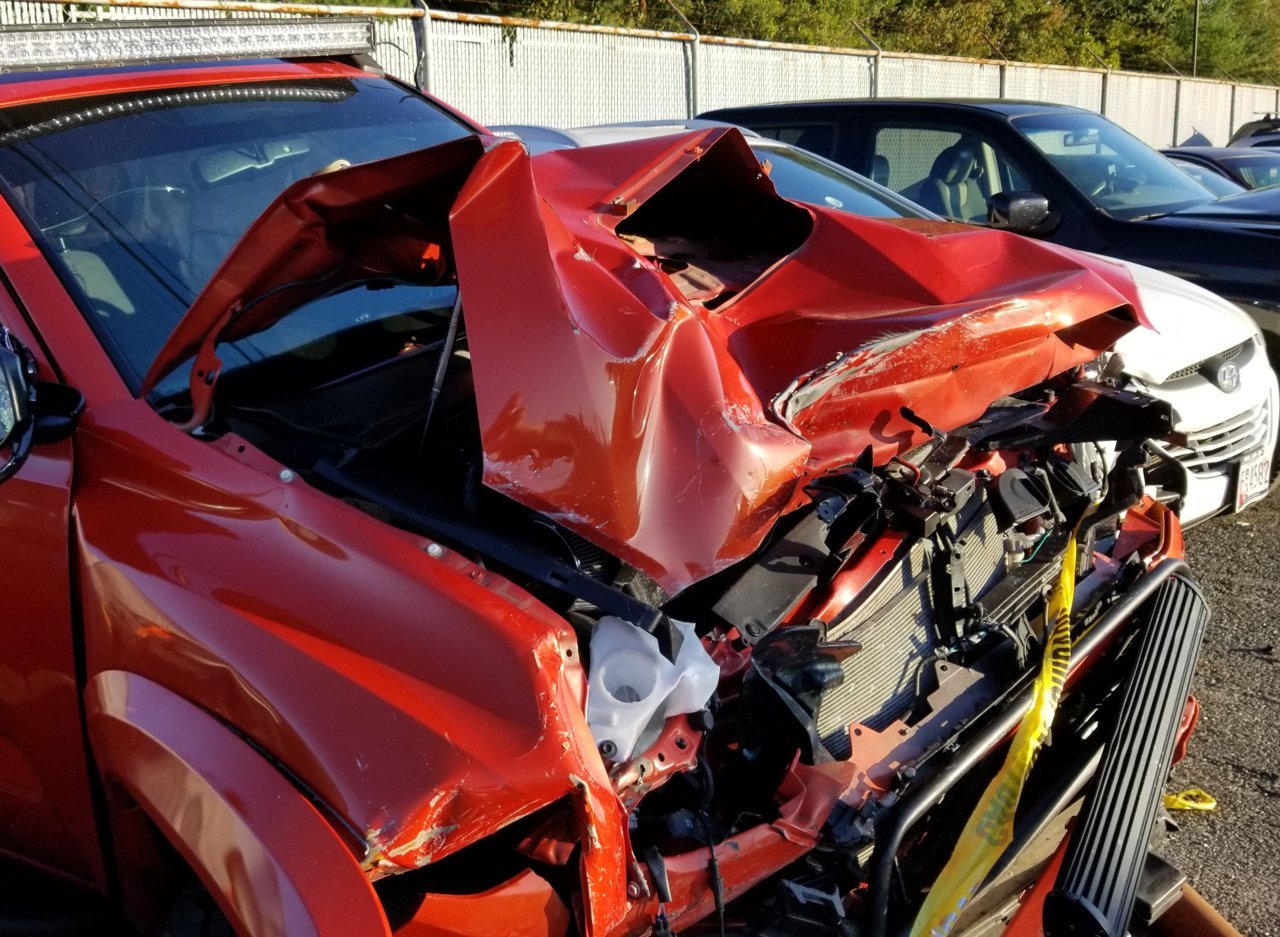

    Short answer, don't do it. Unless you don't drive your truck.
    Long answer, I had one on my 4Runner and slid into/tapped the back of a very old F250 in fresh rain doing 15 mph.
    The guy got out looked at his truck, looked at my 4Runner, laughed, got back in his truck and left.
    Damage quote to repair by Toyota, $4,500. Besides the hood and both fenders buckling, it snapped all the tabs on both headlight assemblies requiring them to be replaced.
    Unless the bull bar or anything else you mount, bolts up to multiple points of the frame and/or bumper support structure with serious hardware, walk away.
