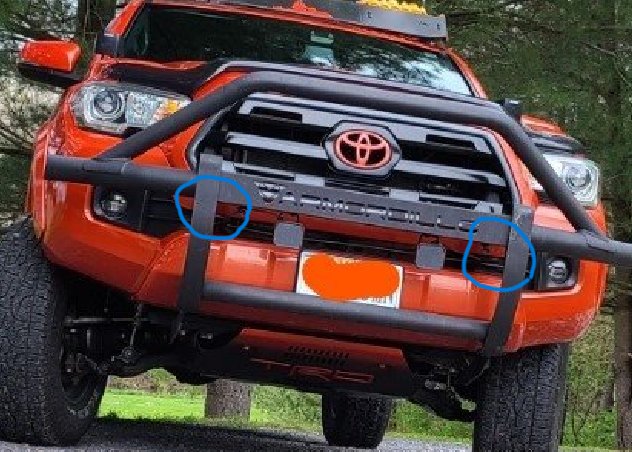

    The other issue with Bullbars, and I had one, is that some have reinforcement bars that connect to the lower radiator mounts. Those support bars will push back and take out the radiator mounts, adding more damage and maybe some other issues depending on what those bars do / where they go after the mounts break. In the pic below, mine were directly behind the main upright bars and went through lower grill openings. I don't have a pic here to show, but they are within the areas circled. Spend a little more and get a steel bumper.
