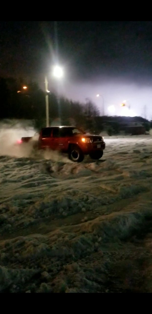

    I got the truck going again!
    Thanks to everyone's help!

    Details please

    So, now in hindsight, was the blown fuse the only problem?
