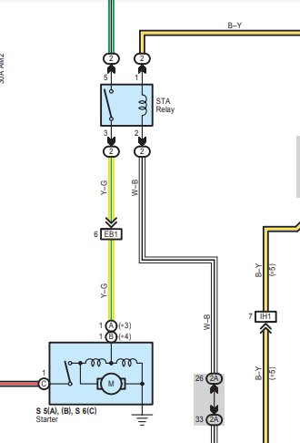

    Looks like it goes to the Clutch Start input.
    What happens if you put the truck in NEUTRAL. Do NOT press the clutch and try to start the truck?
    You need to use the clutch cancel switch. Or it wont crank.

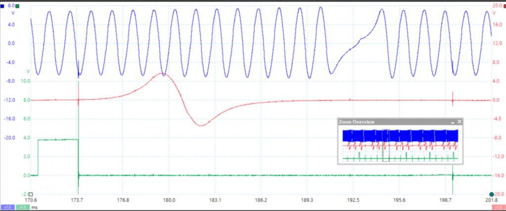

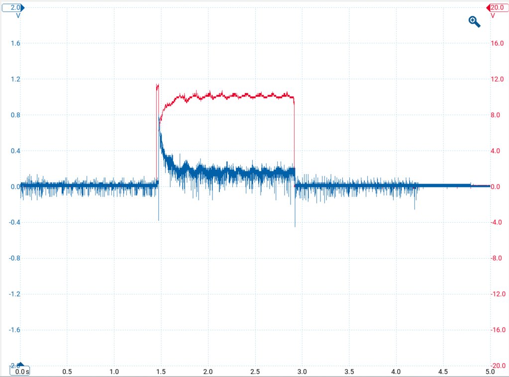

    Got +/-4V while engine running - post #6,
    and +/-2V while cranking- post #8
    The Toyota Mechanic, if he's to be believed, said there's fuel reaching the engine head (i.e. fuel pump fine) but no injection or spark while cranking, which makes me continue to believe the ECU is being "blind" to the crank.

    But why is NOT "blind" while running?
    That's the question.
    And is 2v enough to start the truck? (doesn't look like it)
    Is something pulling the amplitude down in the crank position?
    Plus, you already tried a different ECU....
    The chance of 2 being bad the same way, are slime to none....

    @Dm93 what are your thoughts on the 2v during cranking?
    I noticed this. And that's what gave me the idea to bypass the ignition by jumping the starter.
  15. Oct 25, 2024 at 9:30 PM
    #75
    Dm93
    Dm93 Test Don't Guess
    Mar 3, 2015
    #150066
    13,598
    Texas
    2014 DC OR 6spd 4x4
    Predator tube steps, Ranch Hand grill guard, Magnaflow CatBack exhaust, Toyota tool box & bed mat, 2LO Module by @Up2NoGood, Rearview Compass/Temp Mirror, Tune by @JustDSM.
    +/- 2V should be plenty, +/- 500 mV is typically minimum for the ECU to recognize the signal.
    I watched a scanner danner premium video last night on a Camry with a weak crank sensor, it would start only with a jump pack connected but the crank signal was really weak (like +/- 300 mV cranking and like +/- 2v running).

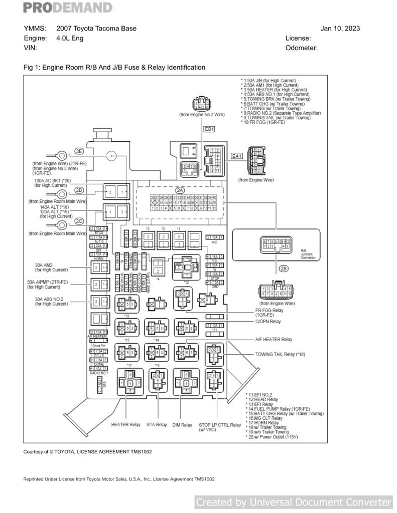

    You gotta be careful what your sticking power to.
    You would need to send power to Pin 3 of the STA relay to activate the starter.
    I'm assuming you hit Pin 1 and the ECM saw the signal and turned on the fuel pump.
    TnShooter likes this.

    That's funny cuz I did try it (and all others, truly not wise) using the test light, maybe that's no good?
  19. Oct 25, 2024 at 10:47 PM
    #79
    Dm93
    Mar 3, 2015
    #150066
    13,598
    Texas
    2014 DC OR 6spd 4x4
    Not gona hurt anything poking around with a standard 150mA test light (I thought you were poking around with a jumper wire) but while that is enough to activate most standard automotive style relays it's not gona energize the starter solenoid, those typically need somewhere in the 10-30 amp range to pull in.

    Thanks, tried again this time got a good crank just like with the key but darn, same issue.
    I even "triggered" the fuel pump (humming noise on) using the relay prone #1 and tried again, but no difference... Maybe that would signal the ECU? Worth a try bypassing the fuel pump too/simultaneously?
    Will get those bump-start scope readings soon.
    *Another thing that crossed my mind:
    Could the ECU have any other sensors that without them we won't get an injection or spark (e.g. engine flooded, compression)?
    Maybe while cranking the voltage drops enough not to read?
