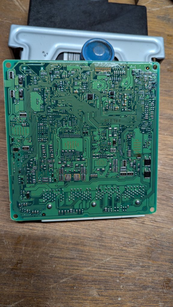

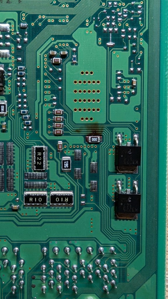

  12. Dec 10, 2024 at 2:15 PM
    #152
    hyharari
    hyharari [OP] CH
    Oct 21, 2024
    #459184
    48
    CH
    2007 Manual Transmission Access Cab 4WD, 2.7L
    So its been a while and the truck starts fine, knock on wood.
    I've opened the ECM and noticed some diode or something probably burnt:
    Some more pics:
    On a slightly different note, since the new ECU/ECM I've lost a whooping 2 MPG on average.
    Used to be running around 24 but now only 22 mpg, same commute.
    I even changed all the oils (diffs, transfer case & transmission) and finally got an aftermarket (stainless) exhaust.
    Thinking that would improve my fuel economy hence now am suspecting the ECU is the issue.
    Going back to my ebay order, it seems from the pics (but I could be very wrong since the ad is still up with the same image) it was taken from a totaled 2007 TRD Pre-runner, opposed to my normal(?) 4wd. Any idea if that could cause higher MPG?
    Any tips on improving fuel efficiency are welcome! Tuning of some sort? Performance Chip Module?
  13. Dec 10, 2024 at 8:21 PM
    #153
    Dm93
    Dm93 Test Don't Guess
    Mar 3, 2015
    #150066
    13,596
    Texas
    2014 DC OR 6spd 4x4
    Predator tube steps, Ranch Hand grill guard, Magnaflow CatBack exhaust, Toyota tool box & bed mat, 2LO Module by @Up2NoGood, Rearview Compass/Temp Mirror, Tune by @JustDSM.
    Yea something definitely smoked in the old ECM.
    As for the lower MPG I couldn't tell you, ECM is the same between a pre-runner and 4wd as far as I know unless that one has a different calibration. It would be almost impossible to find that out though because Toyota does not publish calibration information except in TSBs that have calibration updates.
    There's plenty of tuning support for the 1GR but I don't know if anyone is doing a tune for the earlier 2TRs or not as there isn't much left on the table for them performance wise.
    No such thing as a "performance chip" that plugs into the OBD port so don't get taken by those scams.
