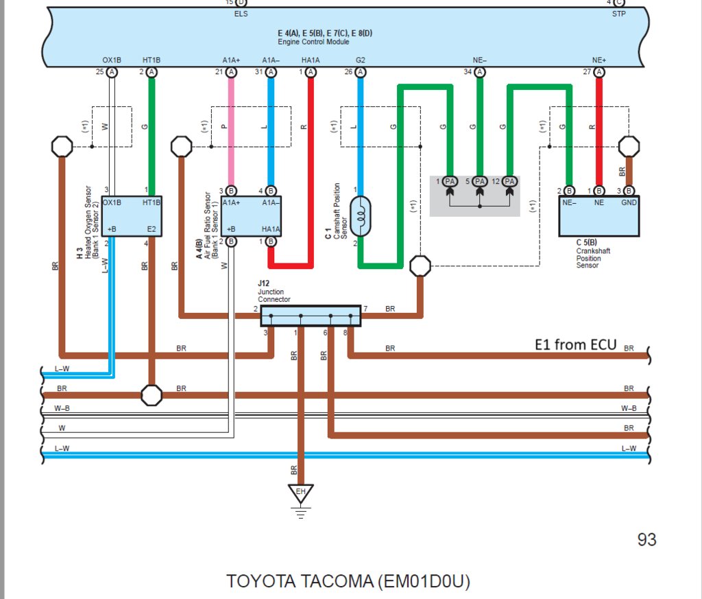

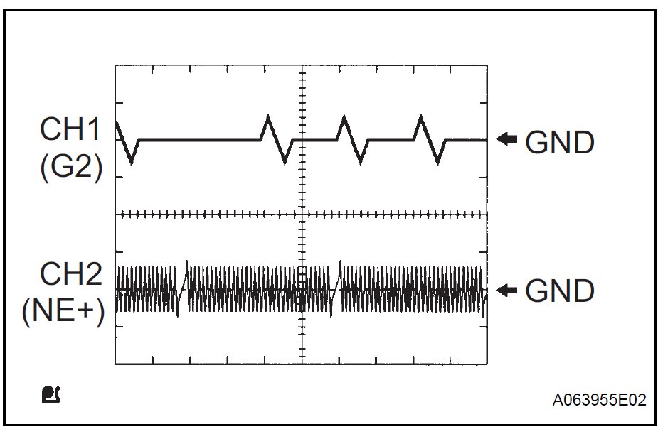

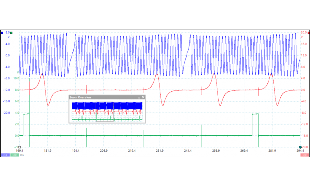

    Well comparing yours to the known good @TnShooter posted it looks dead on, the cam trigger falls right in the middle of the 8th and 9th crank triggers from the sync notch.
    Maybe we are looking at this wrong and it's not the cam and crank signals that is the problem, maybe we are losing a power when the key is in the crank position.
    Do you have a test light so we can do some power checks?

    That's normal, as I said lower RPM = lower amplitude.
    I don't think there's anything wrong with our cam/crank signals at this point, they look perfect.
    As I stated above I'm wondering if we are losing a power feed from the ignition switch when in the crank position, it's the only other thing I can think of that would be different between cranking from the key and popping the clutch.

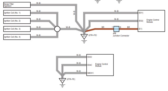

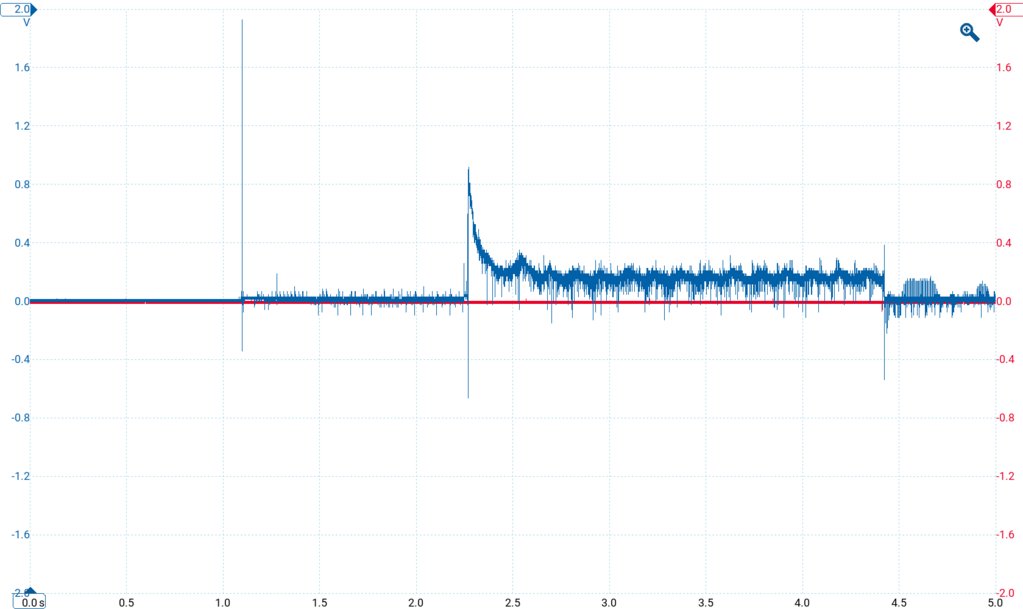

    Let's put scope ground on battery negative, Channel 1 to E1 (Connector E4 Pin 3 (Brown)), and Channel 2 to E03 (Connector E5 Pin 4 (White/Black) and see what our voltage does there while cranking.
  6. Oct 24, 2024 at 6:51 PM
    #26
    hyharari
    hyharari [OP] CH
    Oct 21, 2024
    #459184
    47
    CH
    2007 Manual Transmission Access Cab 4WD, 2.7L

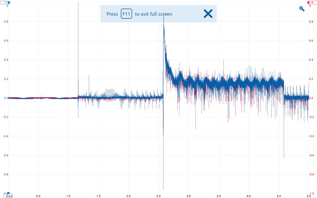

    Not sure what I just measured, Blue line is E1 and Red line is E03:
    Around Midtime (2.75s) is cranking.
    The E1 scale is super zoomed, not sure you can call that a reading or just noise..
    Dm93[QUOTED] likes this.

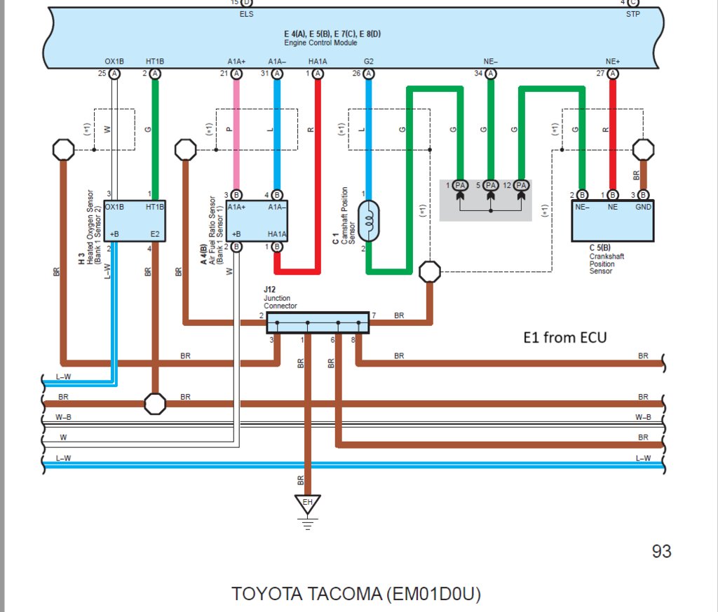

    If your connected correctly I think we just found why it won't start, those should both be grounds. E1 looks good but we have 10v+ on E03 during cranking, what's interesting is they where they ground they are right next to each other on the back of the cylinder head.
    E1 is grounded at Ground Point EH and E03 is grounded at Ground Point EG.

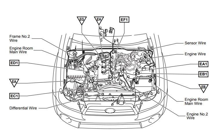

    That's odd, I couldn't immediately find either of those grounding points.
    What I did see is one empty nut/threads at the location of EG, but only one in the vicinity that's immediately visible
    Any Idea where the wire is coming from to try and trace it?
    P.S. You sure that's the right diagram for me? I'll continue looking online for those grounding spots.

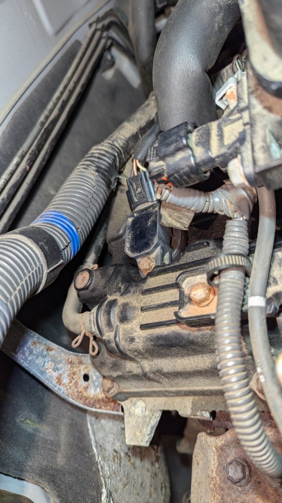

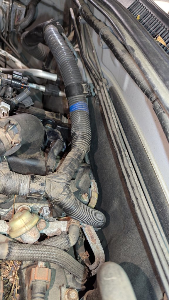

    Here's a picture of what I'm seeing:

    That's the correct diagram, they should be bolted to the back of the head facing the firewall. Should be multiple White/Black and Brown wires going to each of them.
    With the amount of rust I'm seeing I wouldn't be surprised if one or more wires are corroded off.

    Found/Saw both of them by crawling underneath.
    Was too cramped to take a picture but they look in pretty good shape, not a spec of rust.
    Couldn't see any damage to wires from the angle I was looking.
    It's really cramped getting there, about an inch of clearance makes it difficult to even see the bolts, let alone try to fiddle with them and reinstall. How would you go about this task? Maybe run a continuity test?

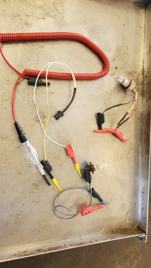

    A test light from battery positive would be a better test as it would load the circuit.
    I guess you could if you make dang sure your on the right wire, I try to avoid jumping directly to circuits. I feed stuff through test lights when I want to send voltage or ground to something that way it's low risk, if something is wrong the worst thing that happens is the light lights up.

    I'm not sure how to explain it but we use different sized bulbs depending on how much current we want to allow to pass, for example a H11 headlight bulb will pass about 5 amps through it at 12v. If we are only passing say 2 amps through the bulb the voltage drop across it would be pretty low.
    A standard incandescent test light is typically around 150 mA or 0.15 A.

    This my test light collection what I have at work, 150mA up to 5 amp.

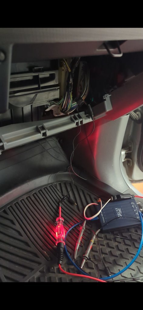

    So I seem to have mixed up earlier between E1 and E03, verified this time with a continuity test.
    Here's a snip of me trying again to jump the negative battery via a test light to the faulty E1:
    Still no start with same symptoms.
    Will it be any different if I try connecting directly?

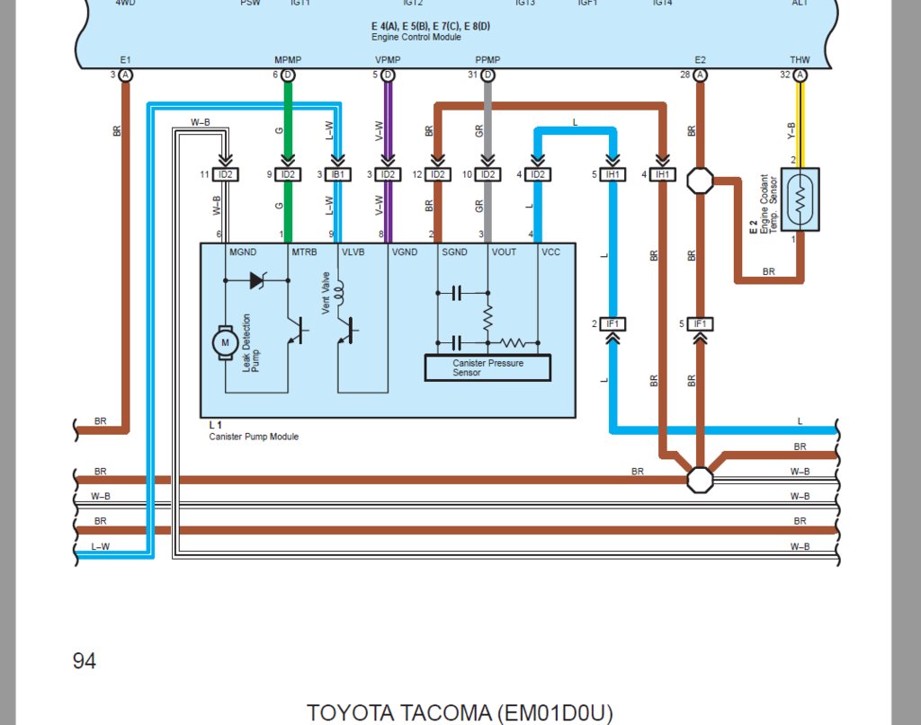

    Looking at E1 it seems to lead to junction so maybe the problem is further down somewhere?
    Here are the diagrams:

    Man I'm at a loss here, I can't see why it can't see the crank signal when cranking with the starter but it can when you push start it.
    Can you get me a capture of the cam/crank signals cranking with the key and one of you push starting it?
    Save the pico files and put them in a zip file so you can post them here.
    I wana see if I can find any discernable differences.

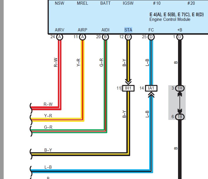

    While reading I stumbled upon this:
    So I hooked up the Pico to that pin on the ECU:
    And guess what, I got no reading!
    Red line is reading STA and the rest is like before for reference:
    Trying to peek at the starter I couldn't see much.
    Maybe this is root of the problem? Or would that be a different error code?
    Thanks for finding that IH1 sensor, I'll try looking there too:
    https://www.tacomaworld.com/threads/connector-behind-glovebox.792651/
    *edit: on second glance it seems not to be the issue since if I'm not mistaken STA is just a signal to the computer from the key switch, which is working fine since I do get cranking...

    Set your timebase up to 1-2 seconds and it should be able to record around 30 frames which should give you plenty time.

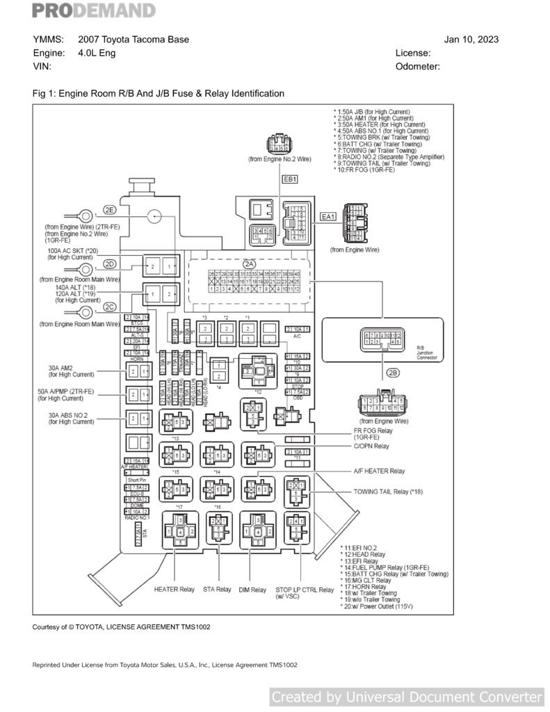

    That wire comes from Connector 2B Pin 5 (Black/Yellow) in the underhood fuse box, it should have battery voltage while cranking.
