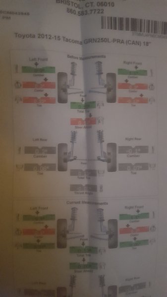

    Thanks for your replies.yes I had the alignment done and yes you can't fix the caster but this did that even before the lift and I've owned the truck since it only had 8000 miles and it always did it

    Lower profile tires will pull more on imperfections on the road, but it shouldnt be that bad. Im still leaning towards bad caster (not camber). Caster could have been out of whack before the lift. Its definitely out of whack with 3" of lift. It will maje your tires pull towards i perfections and feel floaty, light in the steering wheel, at highway speed.

    This is after the lift and 275 75 r18 tires

    Caster should be around 2*.
