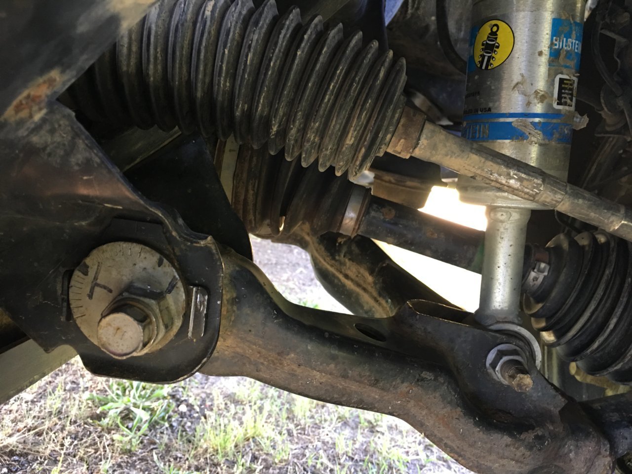

    Ya. I don’t know why I asked that,,, but since I’m here,,, I bent the tab on the front driver side front cam adjustment. Will a spot weld behind that tab for strength be sufficient?
    Or am I screwed?

    I put cam tabs all back where they should be and laid a bead behind all of them. Total Chaos sells a larger cam tab kit but I think the welding does just as good as the kit.

    Like MO said, bend them back & then lay a bead behind them. Problem solved!

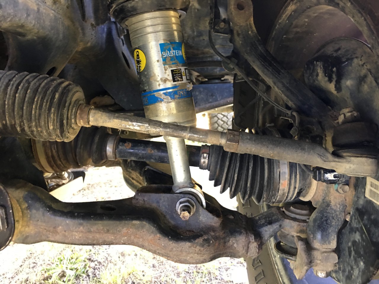

    So thanks to the OP and another bad alignment I’ve discovered steer bump. Yesterday I was looking at my tie rods and an epiphany. I’m going to flip them over to try see if I can compensate for my lift
    Ingenuity or too much beer?

    Too much beer! The rod ends are tapered. You can't install the rod on top of the arm without some modification, like boring the hole and using a heim joint.

    You know, sometimes "dumb ideas" are the perfect spark for great ideas. It would be great to be able to mount the steering rod on top. I'm not a fan of heim joints on daily drivers. A machine shop could bore that hole, and press in a tapered sleeve upside down. Then the stock arm could be used just as you described. Maybe someone with machining capability will offer that. It would be a very simple job for any qualified machinist. If we could just buy the sleeves, we could get the boring and pressing done anywhere.

    If someome made some sort of tapered adapter kits for this they would make a killing for sure...

    Not trying to dissuade you but I would encourage you to measure first with the diagram I posted earlier. Putting the tie rod on top is what folks do with spindle lifts do since it increases the length between ball joints. It’s been a long ass time since I measured stock geometry, but IIRC, it bumps toe in, which means you would want to lower the tie rod, not raise it.

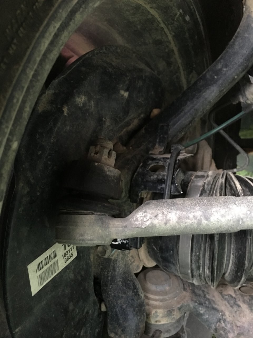

    51A1AC76-0966-4BCF-AC81-3FB134532809.jpg I’ll look into it more later. There’s some room left to suck the tie rod in a little. 51A1AC76-0966-4BCF-AC81-3FB134532809.jpg 1441808D-E2FA-44F6-A131-81F51BD1AC49.jpgBut first I have to address this. I bent it a little after putting my 3/4” spacer in. Toyota dealership finished it off. Letting me know there was a bigger would’ve been cool.
    Not sure that this will be GSMTR compatible,,,, but I’m already here.
