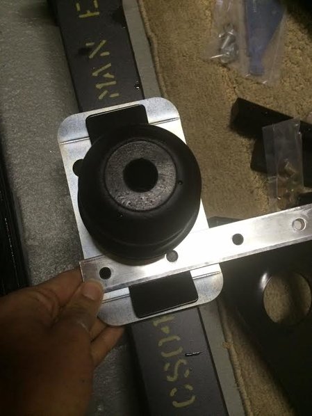

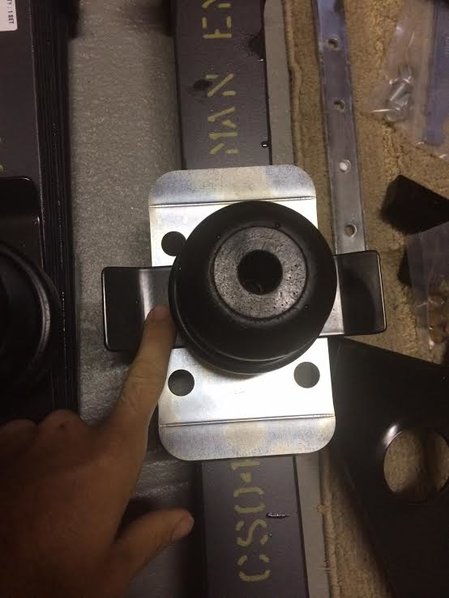

    I have figured out two ways to mount the Wheeler's bump stop to my Toyotec U-bolt flip kit plate. One way is to use a thick chunk of steel that will span across the base part of the bump stop held down by the U-bolt nuts. The other way is to turn the bump stop 90% and drill a hole through the bump stop and U-bolt plate and mount it with to bolts. I will have to cut the excess metal of the bump stop off. I am torn on which on to do advice would be great, Thanks

    Mine came with tapped holes from All-Pro. I just drilled holes in the bumpstop mounting plates:

    That looks good ill do the same, thanks Geekhouse
