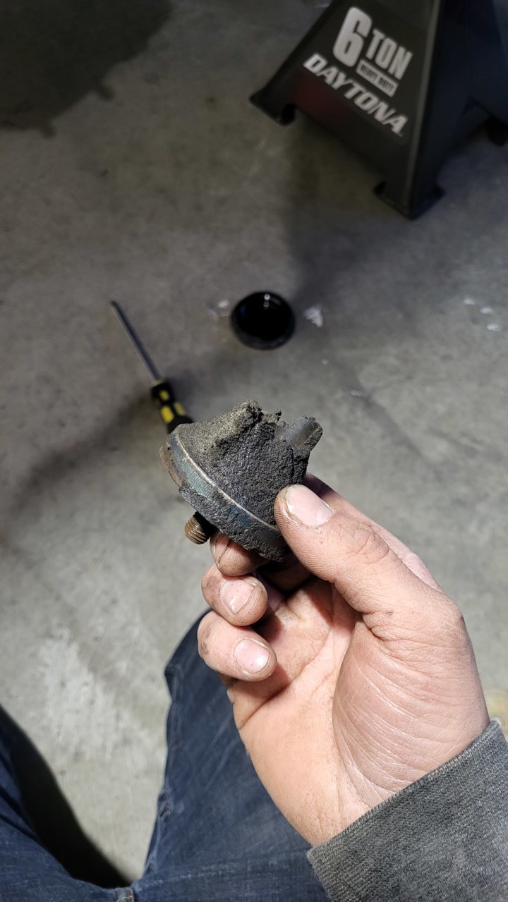

    Melted/tore/ejecto seato'd the superbumps up front.
    Bertw192 and Crikeymike like this.

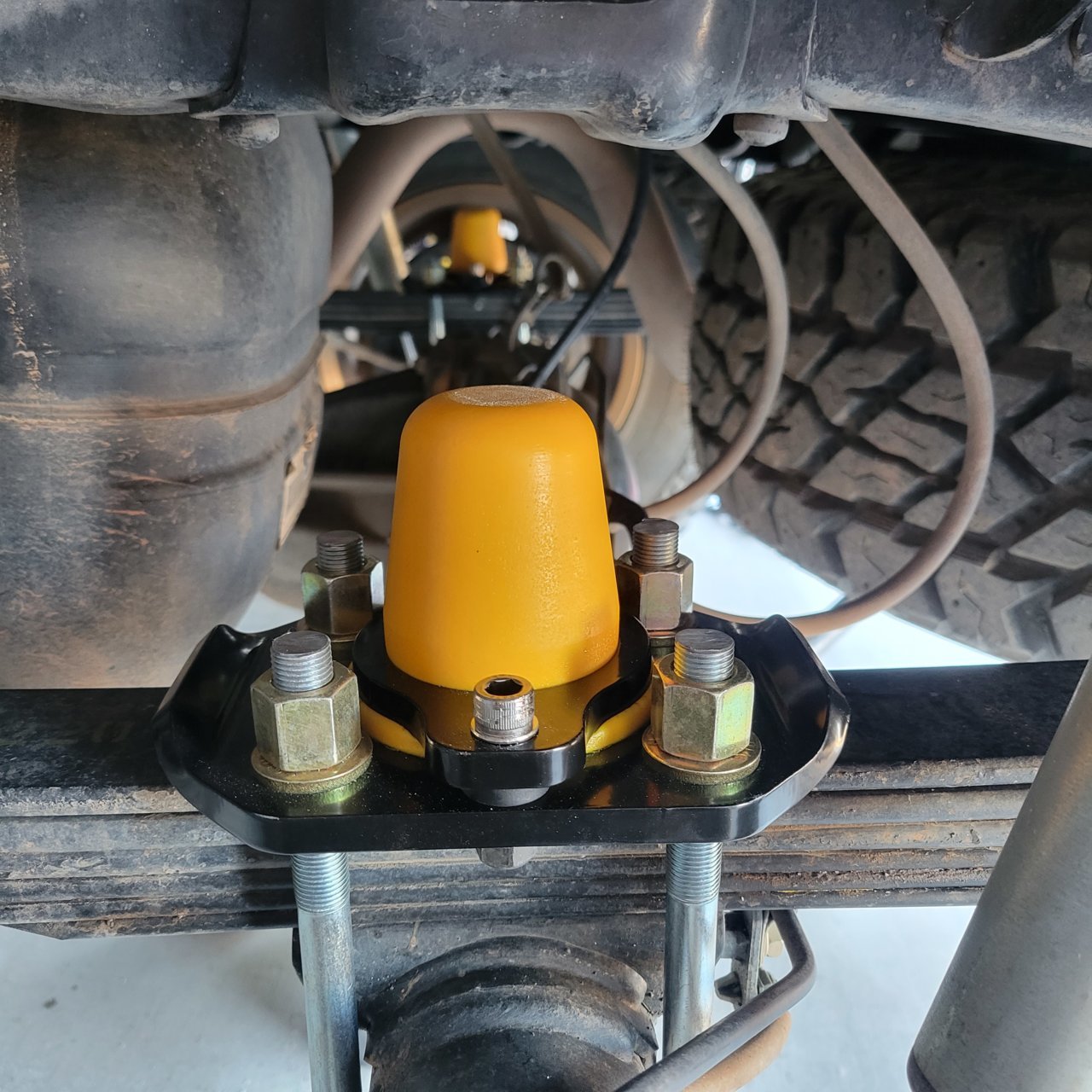

    Super bumps up front from Wheeler's, and Archive Garage Option #3 out back.
    Not sure if I drive like a pussy, but I can honestly say I've never felt the bump stops. There is definitely contact happening based on wear marks, but they must be soft enough that I don't feel them.

    if you are looking for more off-road and general day to day driving, go with the archive garage. If you are only really going to be looking for towing, go with the sumo Springs. The sumo Springs are going to give you much more of a harsher hit so they are a lot more for support rather than for comfort.

    AG Option 3 really is nice. I hit rear bumps a fair amount with how I drive off road and before it felt as though I'd compressed my damn spine. I have yet to notice it making contact, but I know it is because everything is dirty and that spot of the frame is nice and clean from the bump. Haha

    I have the same experience with Archive Garage Option #3 bump stops. Never feel them hit but they are for sure contacting. I used to have super bumps in the rear and felt those all the time.
