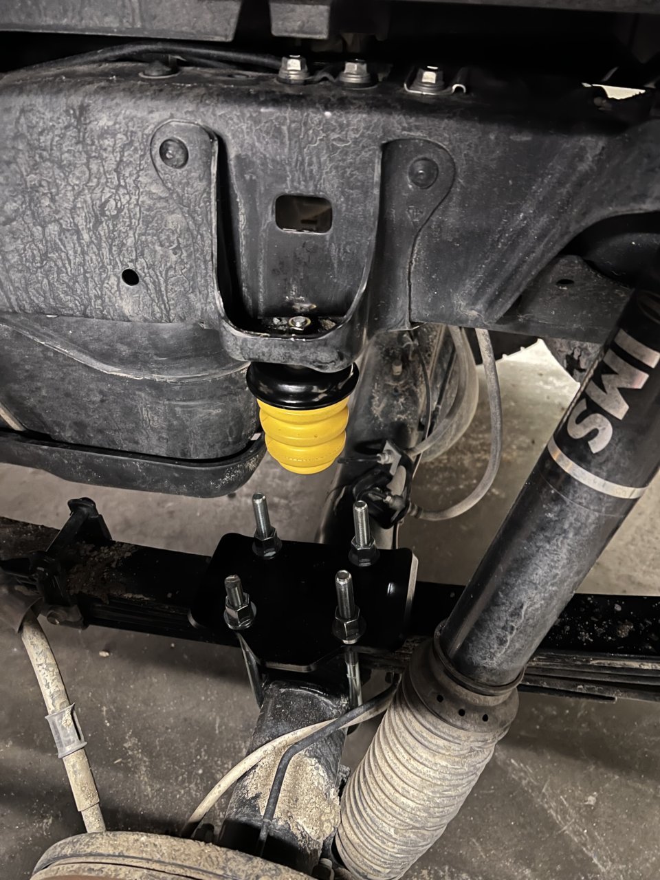

  13. Feb 25, 2023 at 10:37 PM
    #73
    MoonRockToyota
    MoonRockToyota Member
    Apr 19, 2022
    #395388
    24
    2022 Lunar Rock TRD Off Road
    Like others posted earlier, I installed GM springs too. Cost me $110 including the Wheeler’s flip kit, and took only about an hour. I’ve ran it hard a few times since install and it’s riding super smooth in the rear now. I genuinely think all the other companies are overcharging everyone unless you jumped to hydros!
    I took the picture before I cut the extra shanks on the u-bolts, but here’s how mine came out:

  15. Feb 26, 2023 at 9:59 AM
    #75
    MoonRockToyota
    Apr 19, 2022
    #395388
    24
    You will need to order GM bump stops Part # 15712438, I just ordered from Amazon. I also got a u-bolt flip from wheeler’s because the plate on top of the leaf pack add’s about 3/4” compared to stock.
    Here is the link for that: I removed the old bump, and installed the flip kit first, then I jacked up one side of my axle until the suspension was near full compression. At this point you need to place the GM bump where you want it to strike the leaf plate, I preferred centered on the bolt in the center of the leaf packs. I marked bottom of the bump stop strike plate (mounted on the frame) and then measured to match up since you will be drilling from the top (about 1 1/4” in and 2 3/4” aft).
    Note: Please measure multiple times, as you will have one shot at drilling this right. I lowered the jack compressing the suspension, and began drilling from the top side, starting with a smaller bit and stepping up a few times until finishing with a 3/8 inch bit. Took a few minutes so just take it slow and step up bits as needed.
    After the hole is drilled install the bump stop shank into the hole, and thread the nut on up top. You can use shims/washers between the bump and the frame if you needed more height on the bump. Trim the excess u bolt shanks with an angle grinder and you’re good to go.
    Sounds like a lot, but it really was very simple with the only sketchy part being drilling the frame, which if you measure correctly it shouldn’t be a big deal. For how much I saved it was absolutely worth the extra 30 minutes of work to me. I drive my truck pretty hard and noted it’s insanely better in the rear (couldn’t tell a difference between these and my buddy’s archive bump kit).

  16. Feb 26, 2023 at 10:02 AM
    #76
    MoonRockToyota
    Apr 19, 2022
    #395388
    24
    Long story short, you’re not modifying the bump stops, but really just drilling a hole in the bump stop strike plate and installing them there. The bumps will now strike the plate on top of your leaf pack with the flip kit.

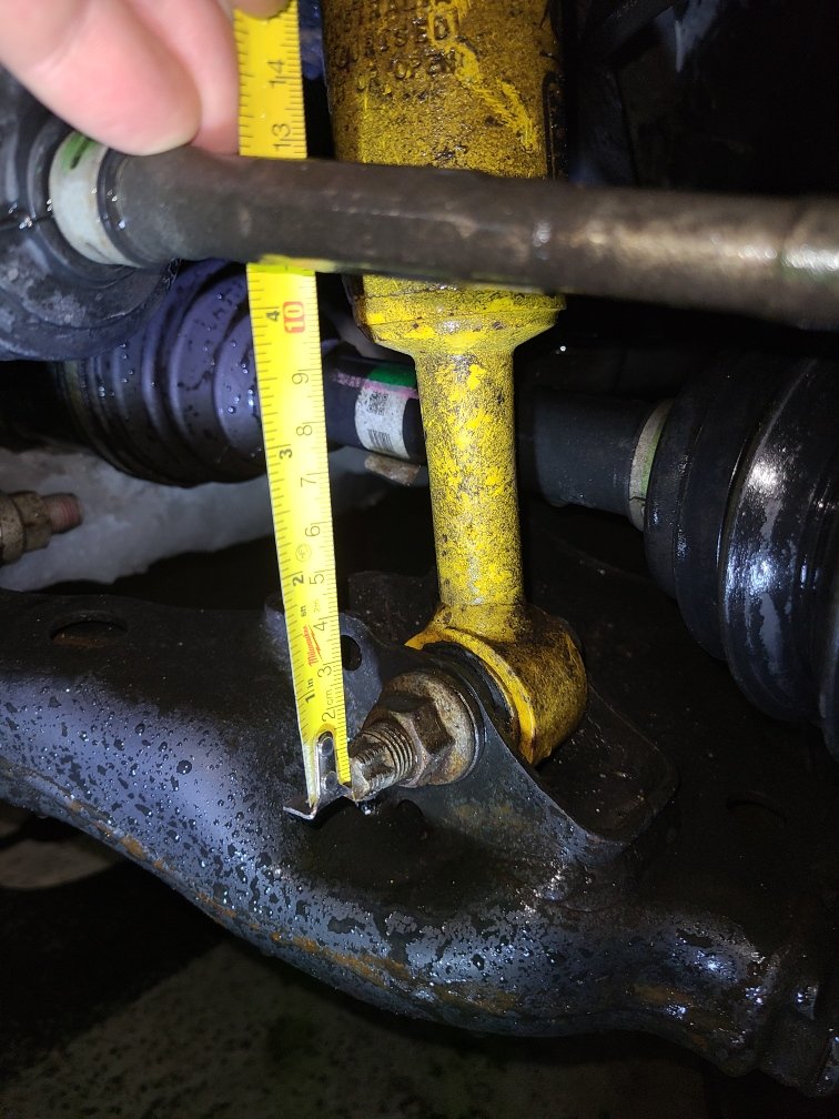

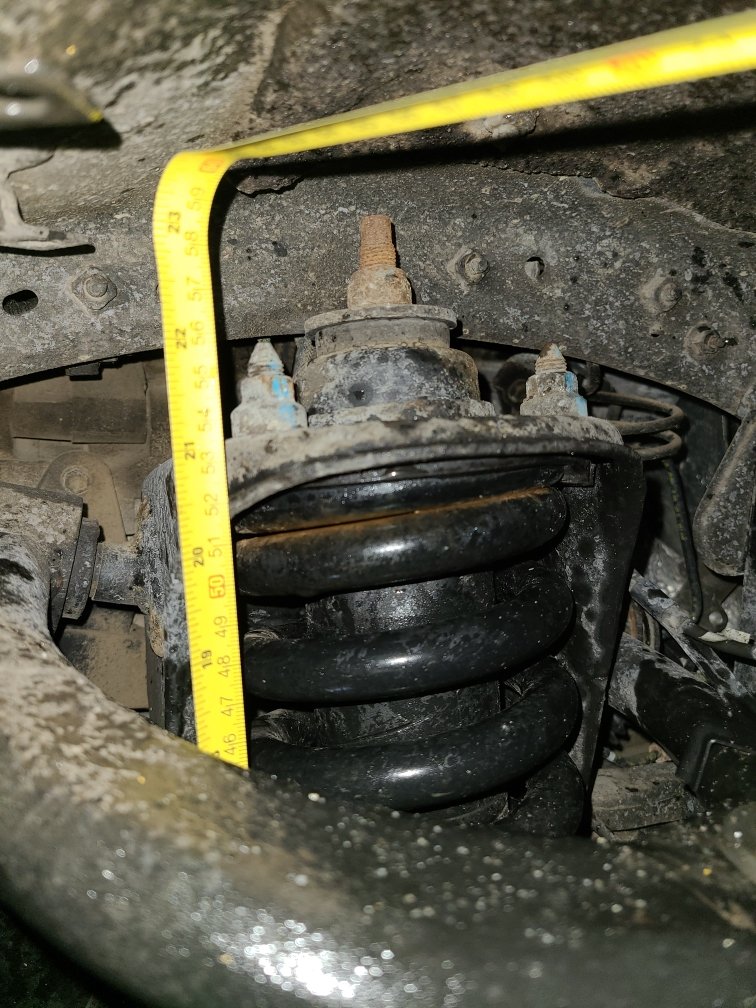

  17. Feb 26, 2023 at 4:31 PM
    #77
    Junkhead
    Junkhead TRDude
    Feb 27, 2019
    #284671
    15,685
    Serge
    Prince George, BC
    Black 4x4 Sport MT 2018
    Some Serious Tires
    So I took some measurements. Not the best pics but here they are.
    What do you think?
