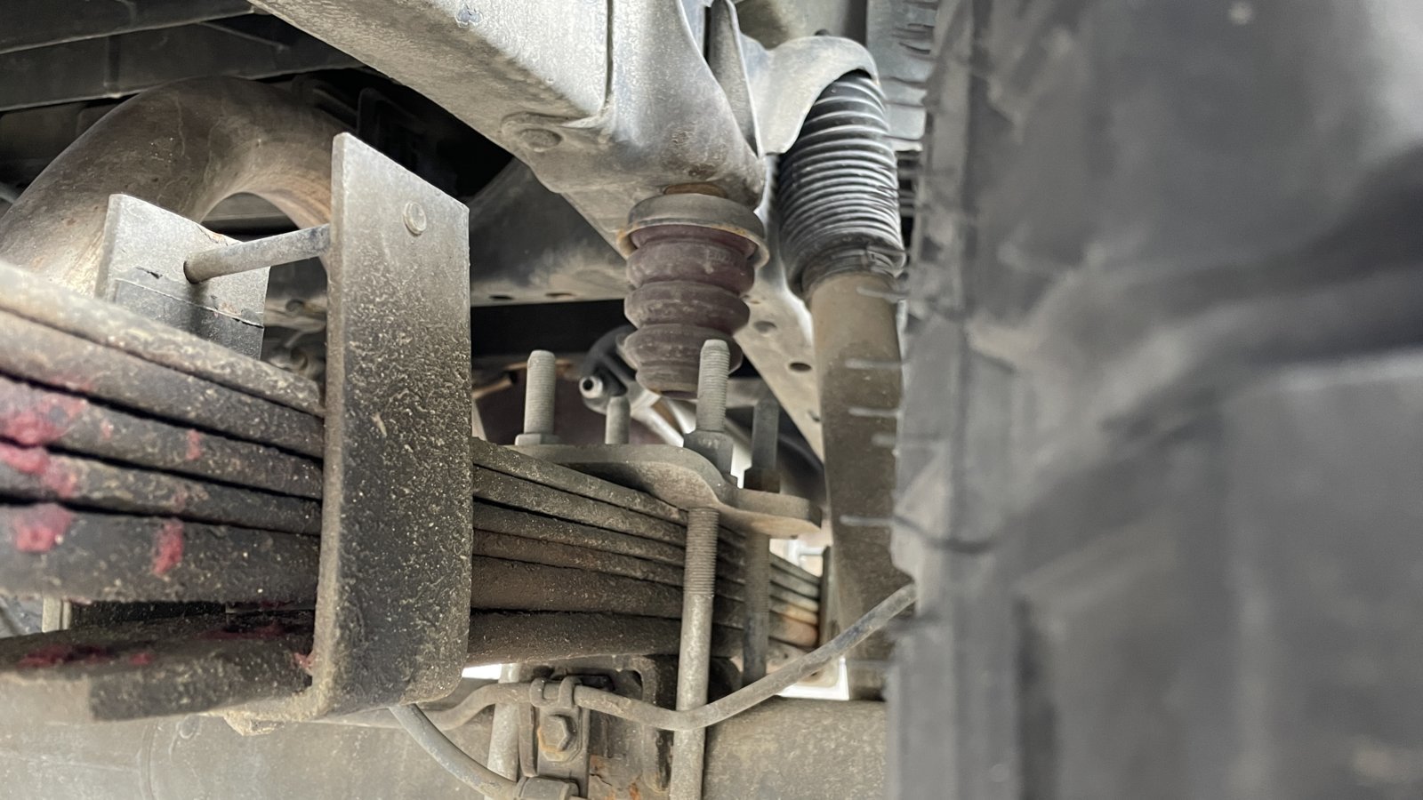

    how did those bump stops mount?

    Sorry for the late reply. I mounted them to where the OEM bump stop would normally hit the frame. I can’t recall if I needed to drill a hole for the stud or not, it’s been a little while since I did the lift. I know it looks dirty and it is. But I sprayed everything with fluid film when I installed the suspension to prevent corrosion so it’s collected a lot of dust.

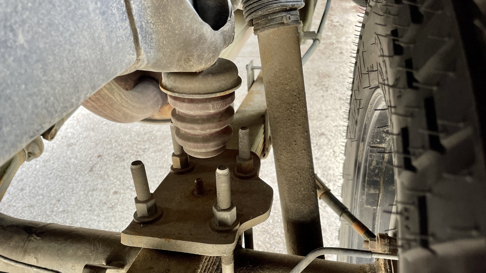

    GM rears work nice so far with ICON RXT and for resi 2.0. In the original GM link there are energy suspension fronts. This is what I did.

    I am running them on stock rear suspension other than Bilstein 5160's. Up front I have the Perry Parts bump stops too, but on maybe 1.25 inches of lift on Bilstein 6112's.
    As far as a hard bottom, it's tricky. I test muled (I paid for my first set and then shot him a message about some things I noticed) a few different compounds for rear bump stops for Patrick, and the best ones IMO were an "experimental" open cell design. He was worried that they would not have the longevity of the regular "hard shell" ones, though, if I remember right.
    Either way, I've been super happy with the bump stops, but when my bed is empty and I hit abrupt cross gutters, washes, etc. I still hit hard bottom. Once I have camping gear, bikes etc. the extra weight seems to work a little better with the bumpstop compound and it's super progressive.
