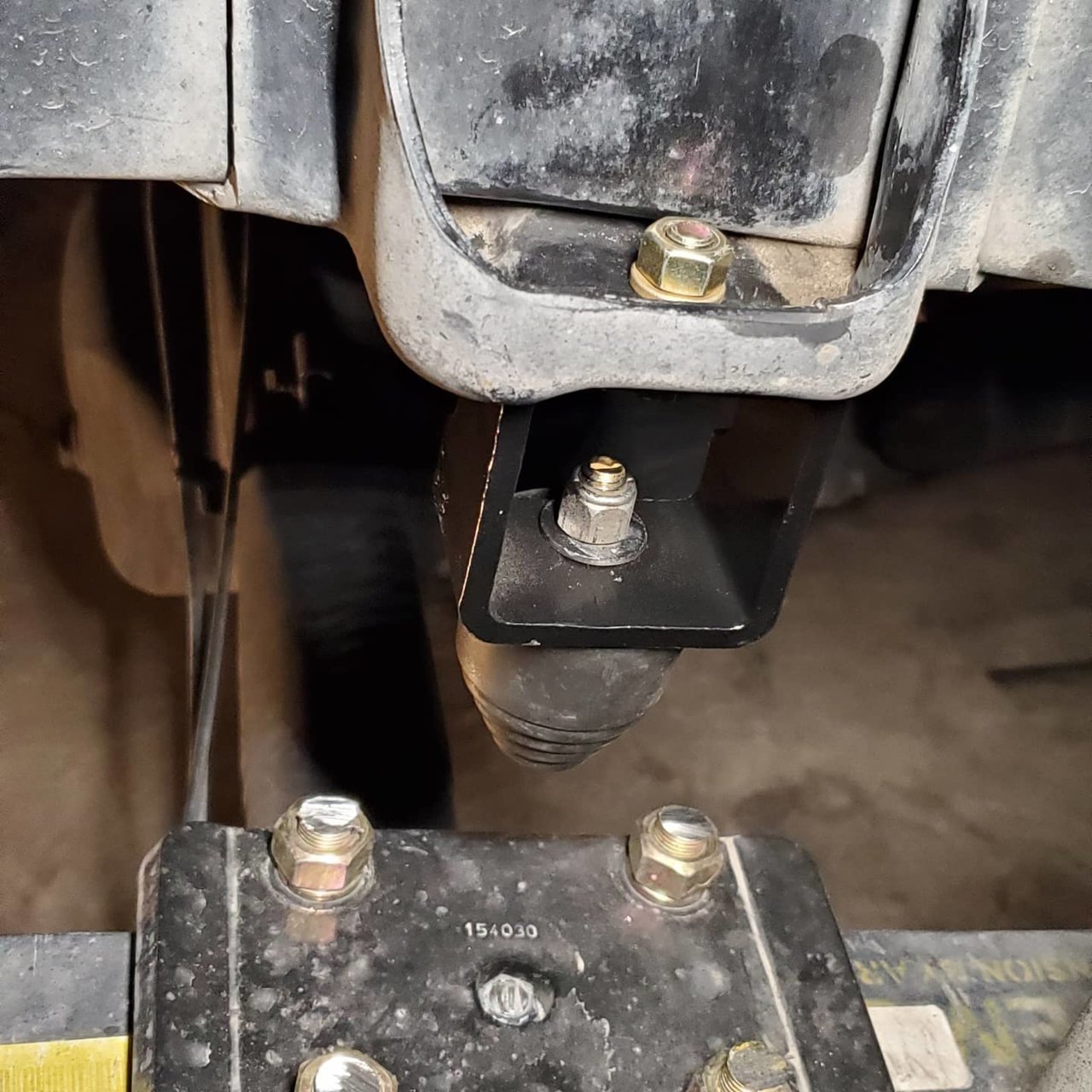

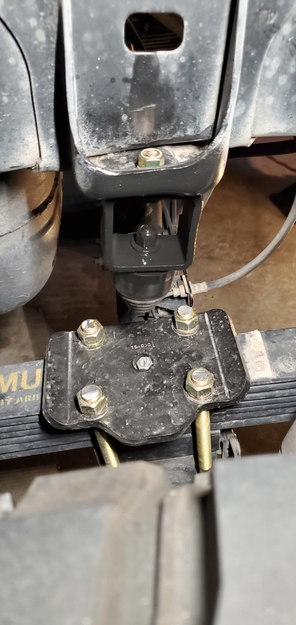

    20200921_193835.jpg I'm not sure if you've already taken care of your rear bump stops, but I promise you that at a minimal price, my method will save you money (happy wife) and time, as all you need is at Tractor supply and autozone.
    I purchased a 2" receiver extension $22 & change, and bump stops from autozone. Sway-a-way version in store. Cut two 2" pieces from receiver, drilled the top and bottom offset to each other and "BAM"!!! Extended bump stops.....20200921_193835.jpg
