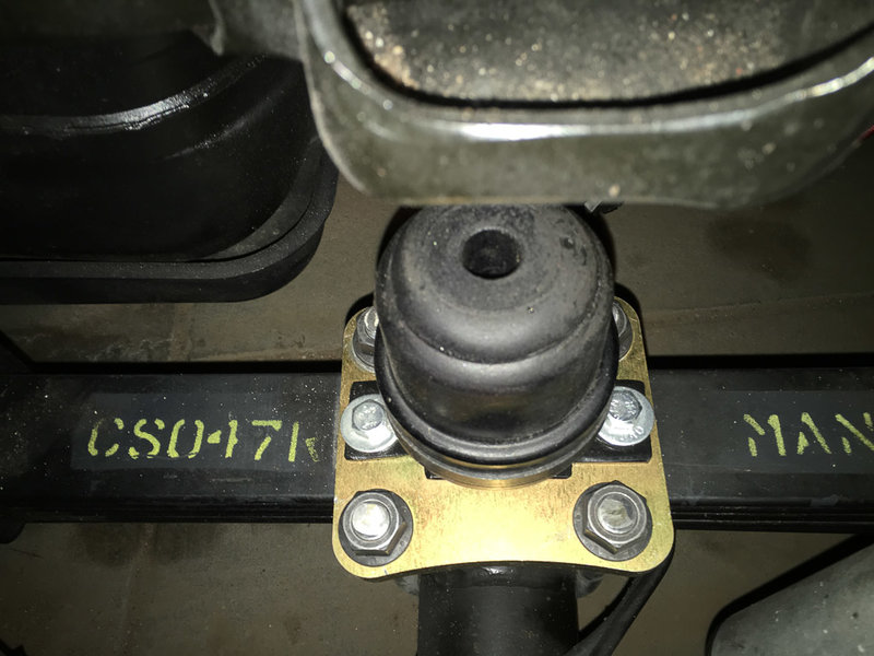

    Bottom out or top out? I think you mean top out. There is a thread that suggests there's a bunch of travel left on 5100s with stock bumps. A spacer or trimming the bumps will make some of that extra travel available - if your setup actually has extra travel.
    I think Wheeler's super bumps might be a better solution to your issue.

    SuperBumps in the front is the way to go. Still using stock rear, rarely bottom out so no need to change. Yet.

    I love that rear setup, Ding! I drool every time you post that pic :drool:

    Nice setup! Had the same frequent bottoming with the factory 2-leaf pack. Put in a low-mile takeoff 3-leaf pack + Icon AAL with stock overload. Haven't bottomed out but once or twice since. For me, the rear bump upgrade would be a solution in search of a problem. Might do it anyway.

    My solution was airbags. Once I lifted the front, I just put more air in the bags as a temporary solution. That solution continues to serve the purpose, with the help of OME rear shocks.

    I like my Dakars / Superbumps set up
