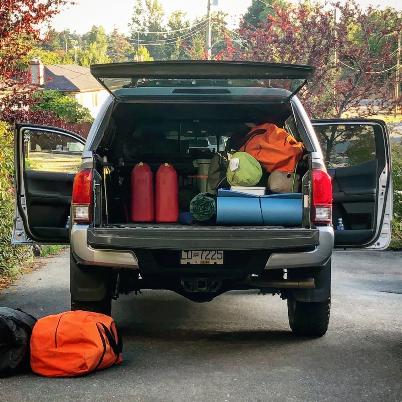

    Some advice: Don’t bother with bumpstops until you upgrade your suspension. I was obsessing over bump stops, active bump stops, hydraulic bump stops yadda yadda, until I upgraded my leaf springs and rear shocks. Now that I never hit the bump stops, they are far from my mind. I used to smack them all the time.
    The fellow who assembled my leaf pack told me this ^^ wisdom. He assured me that once my suspension was properly set up, the factory bump stops would be adequate.
    So far he has been right.

    I have 5100s and a custom add-a-leaf (factory packs disassembled and an leaf added to the middle). Rear ride height is 1” over stock height.
    I run a Fiberglass camper shell that is fully stuffed with camping gear on trips. I used to bottom out all the time. On my last 7 day off highway trip I never bottomed out once, even with two passengers and me. Bump stops were dusty (no marks from contact) at the end of each day.
