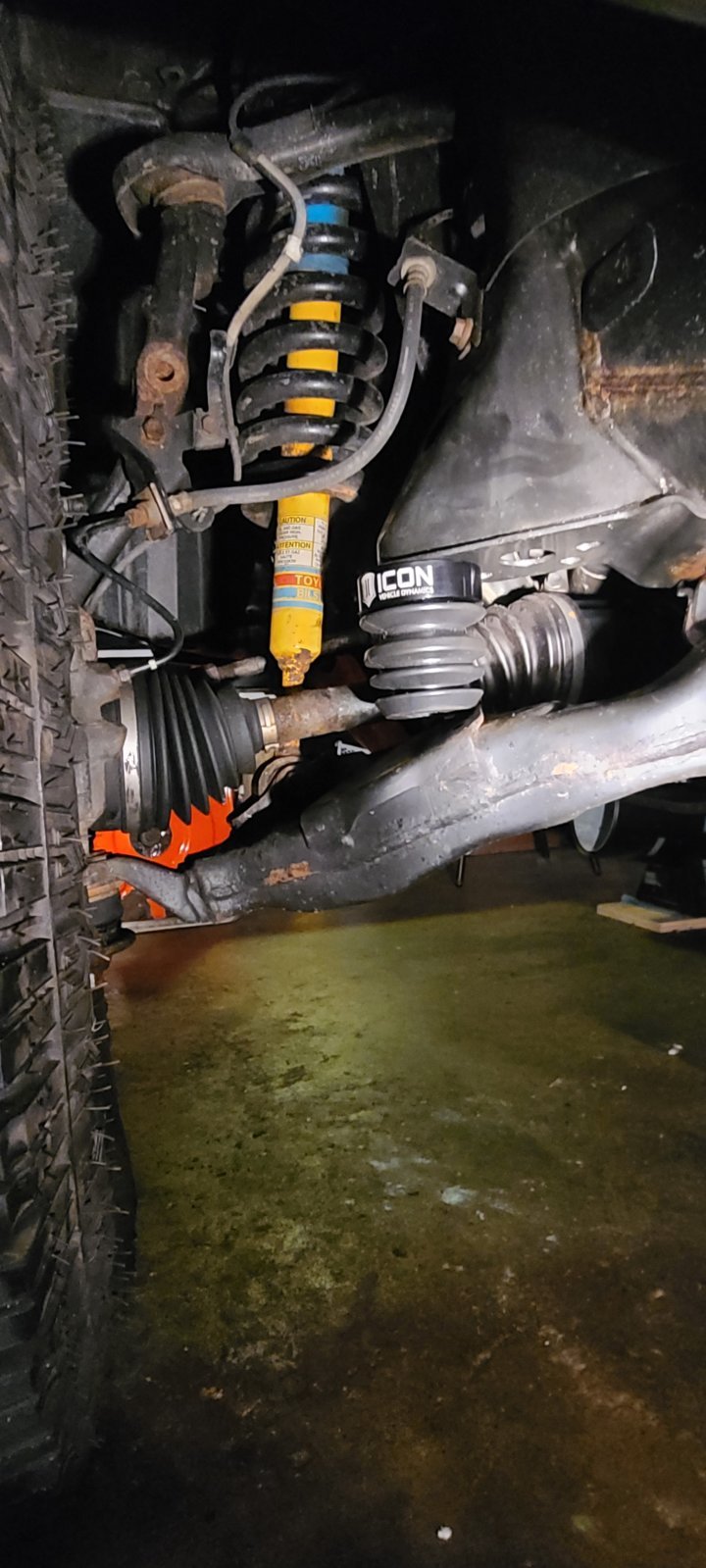

    I am.
    After removing swaybar, they really help with body roll.

    I am lifted 2".
    They might be a little snug fit if stock height.
    The included bolt fits into existing mount for bump.
    Bolt the cap on then force the bump into the cap. I used a little lube to help.
