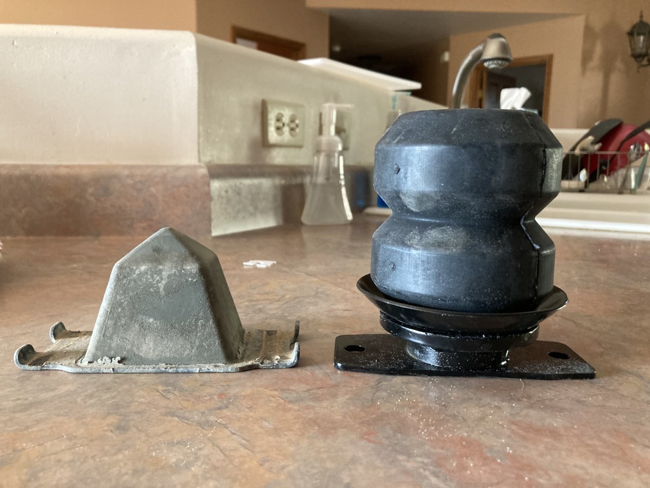

    OEM bump stops are often very stiff, leading to a pretty good shock when you hit them, but still much better than metal on metal without them. There are more gradual bump stops available (not positive yet on 4th gen) that aren't as shocking when they first hit, and get stiffer as they compress further, these can be much more comfortable if you are hitting your bump stop regularly. What the Sequoia guy is probably talking about is like the Timbren's or Sumo springs that take the place of a normal bump stop, but are to help support heavier loads and either engage earlier, or fully fill the gap between the axle and frame even when unloaded. In this case, yeah, they'd increase your "spring rate" if they're engaged from the get go, versus your suspension just having it's normal motion before HITTING the bump stop.
    Here's a picture I stole from here on TW of an OEM 2nd/3rd gen bump stop next to a Timbren active offroad bumpstop.
    You can imagine how much more gap there would be between the frame and OEM bumpstop. This obviously engages MUCH sooner.

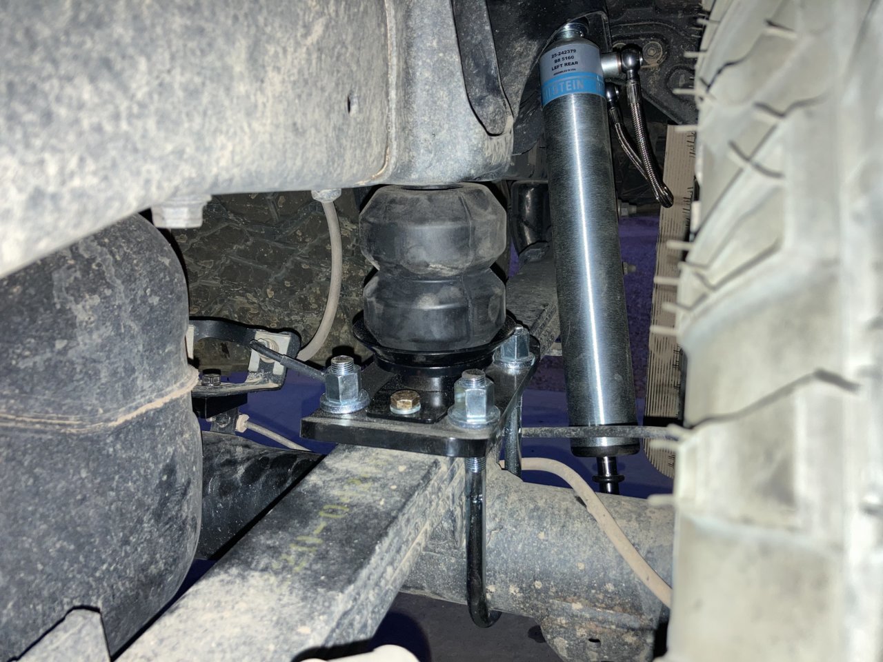

    Here's a sumo spring helper spring. No gap between frame and top of the helper.
