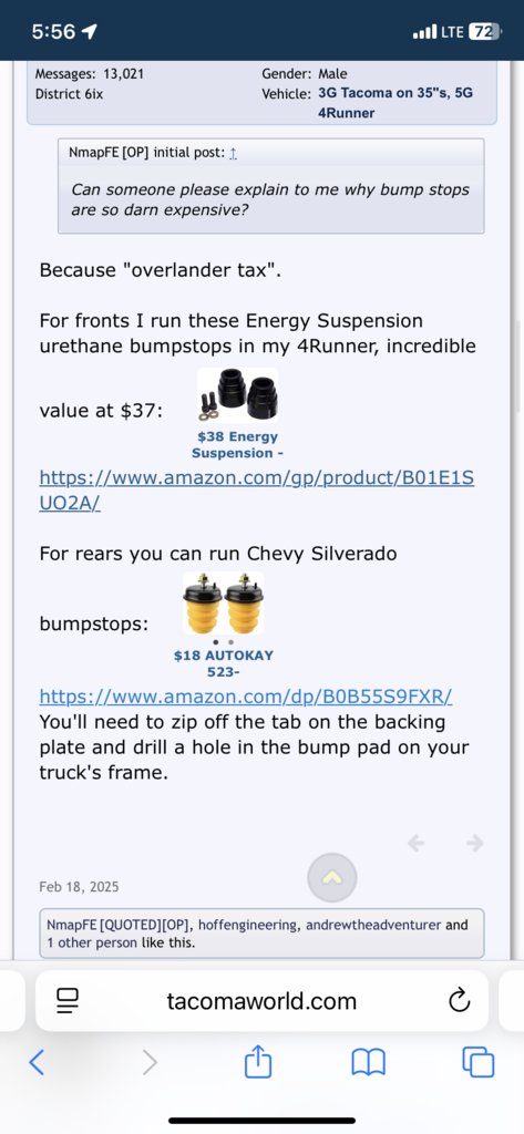

    Because "overlander tax".
    For fronts I run these Energy Suspension urethane bumpstops in my 4Runner, incredible value at $37: https://www.amazon.com/gp/product/B01E1SUO2A/
    For rears you can run Chevy Silverado bumpstops: https://www.amazon.com/dp/B0B55S9FXR/ You'll need to zip off the tab on the backing plate and drill a hole in the bump pad on your truck's frame.

    Seems like a pretty good value! For the occasional bump during mall crawling for me. I wonder if the chev 1500 non hd would be a better alternative for our trucks? Similiar set up by the look of it. Popped up in the recommendations below your link.
    Rear Axle Bumper with Nuts 15712438 523-049 Compatible with Chevy Silverado 1500 and GMC Sierra 1500 Rear Jounce Bumper 1999-2007 (yellow)
    NmapFE[OP] likes this.

    Both are advertised as interchangeable with GM P/N 15712438, so they're probably the same/similar. Buy whichever Chineseium is cheaper.

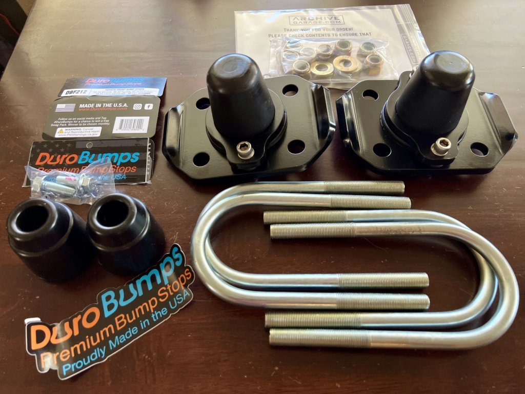

    Just arrived today
    Durobumps for the front
    Archive garage option 3 for the rear. The hardware on these are beefy!
